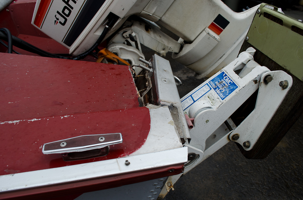

Hi All.
Boat is a It's a 1978 Starcraft Holiday V5 14' Aluminum Runabout with 1979 Johnson SeaHorse Magflash CD 55HP.
Model #: Starcraft 14HolidayV50B
HIN: STRE13460978-F9 (Which I think makes it a 1978)

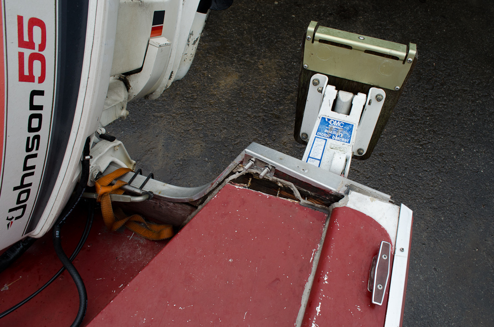

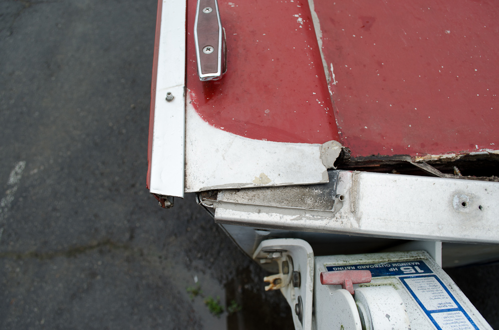

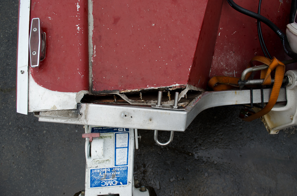

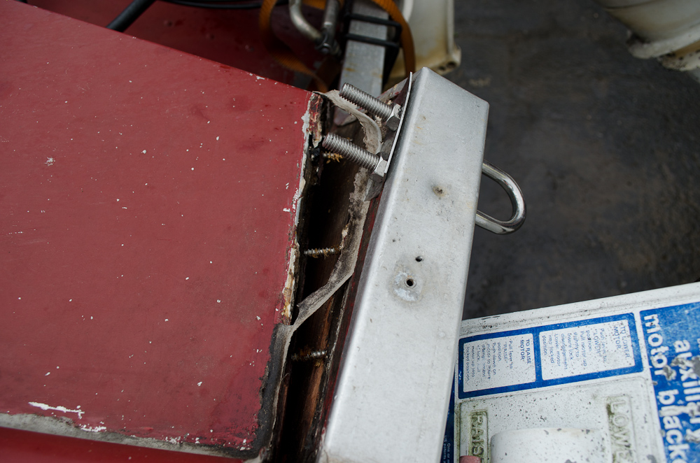

The Transom turned out to be completely rotten. Towing the kids on a tube ripped this piece out but if you reach down inside you can push your finger into it - complete pulp!
The mounts I installed to pull the tube (one on each side) using an Airhead Y harness may have not been a good idea and may not have been well placed...but at least I found out before the motor fell off in the lake.
I'm thinking a complete transom replacement is going to be required / the best option.
Questions for the experts:
1) Do you make or have made a replacement based on patterning the original? Or are there places, maybe even Starcraft, who would have the plans?
2) Can you give me some leads on who might make/cut such a part or where I might get the materials?
3) How difficult a job is this? I'm pretty technically inclined built a rock buggy from tube, can rebuild a transmission, but new to boats). But I'm concerned about stuff like the de-riveting and re-riveting required. Can a guy do some or most of the work himself and have a pro button it up?
4) Anything else that is a must-do while the transom is being replaced?
Suggestion on how to proceed most welcome.

Yep, could have gone much worse.
You will need to use the current transom as a pattern or make your own to fabricate the new wooden transom.
Read thru some of the SC resto threads and you'll find lots of good info:
[h=3]Starcraft Rebuilds and Restorations, they're all here![/h]
Look for DozerII & InMotion's threads, they're Canadian & may have helpful info for finding materials.
If you built a buggy from raw tube, you won't have any problem getting this 14ft'r done.
GA_Boater
May 24, 2011
49,038
Re: Tore the transom ...how to repair? (pics)
You put the towing eye in the weakest place. Live and learn.
Transoms in these tinnies are not hard to do. Did you lose the corner cap?
The first thing to do is pull the motor and bracket to assess damage. Most of these use bolts/nuts to hold the transom in place. Unless the transom ply is total mulch, you probably have enough for a pattern. Even if all mulch, you still have the stern skin for a close enough to trim pattern.
You can cut the wood yourself, no need for any pros. We have guys here that had to be shown the business end of a screwdriver. You won't have any major problems and we can walk you through any sticky parts.
You built a rock buggy and can re-do a tranny. You have the skills. Being a boat doesn't make it any more difficult. It just floats differently (and better) than a buggy. :)

Transom replacement isn't that big of a deal, there's lots of Starcraft transom rebuilds on the forum for you to look at and get a good idea of what you have to do.
The 2 biggest things will be removing the motor and splashwell so you can get to the transom wood to replace it (you won't need to remove many if any rivets).
Use a good exterior grade plywood like ABX or BCX for your replacement wood and seal it with epoxy resin or exterior grade spar varnish or urethane before installing it.
I doubt you'll be able to use the old transom for a template since it's mush, but making a template for the wood will be easy once you get the motor and all the hardware removed from the outside of the transom.

Yep..and always the hard way :) When I get to it - where should I mount the towing eyes? Does anyone make one with a nice 4-bolt flange instead of just the U-bolt style?

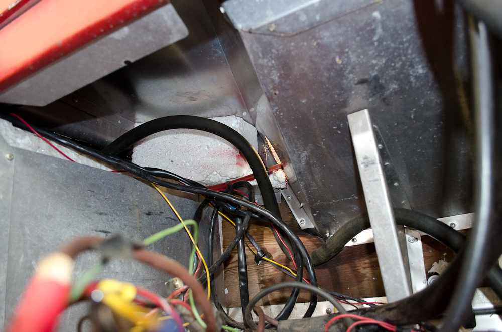

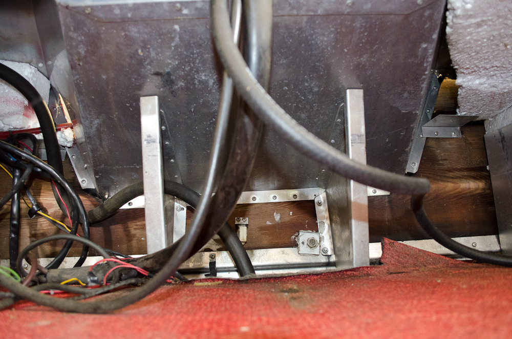

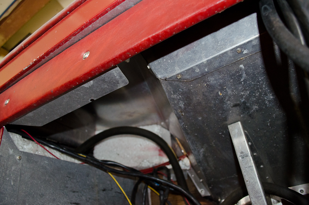

The stuff in green has to come off, plus any through transom bolts. Bolts are in both top corners, the knee braces, the piece of wood between the skin and motor clamp, and the tow eyes. I think that's it. Oh, and a mess of screws that hold the splashwell clamped to the wood, under the splashwell. Motor and kicker bracket of course. DO NOT remove the side rivets in red. The part I labeled 1 under the missing cap can be bent back. And you don't have to remove the splashwell.
[URL=http://s1184.photobucket.com/user/sv29n/media/Cheap%20boats/Starcraft-2013-Jul-05-5459.jpg.html] [/URL]

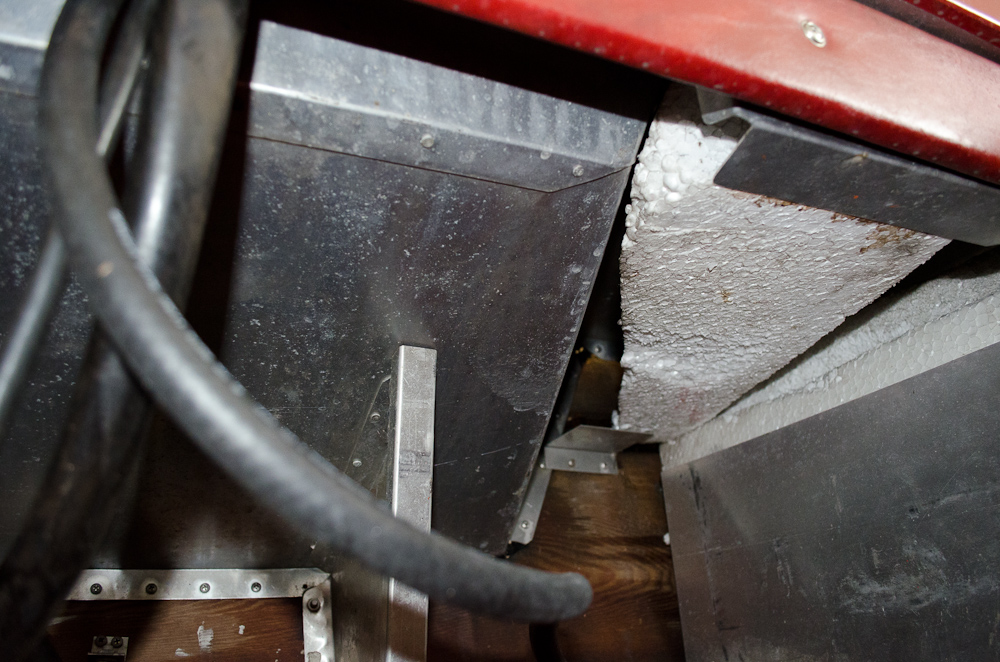

EDIT - get a light and look up under the splashwell. Snap a pic or two while you're at and post them.
EDIT 2 - The restos are here. You might have to look some to find some with a splashwell like yours - rrumba has a Holiday with a similar set up, just a larger model. There are some others.

Since your transom is mush, I'd strongly suggest you dismantle the inside of your boat and look for other problems you may not realize you have. Like other rotten wood (seat bases, and decking) and most importantly waterlogged floatation foam.
Saturated floatation is a safety hazzard because it isn't buoyant and won't float your boat in case of an emergency, and since you have kids onboard I'm sure you want your boat to be as safe as it can be.
Dismantling the inside of your boat will also make it a lot easier to check your transom brace(s) for damage since you overstressed the the transom.

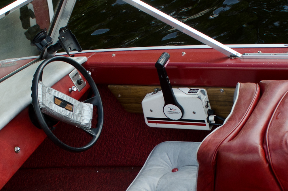

2) Is there any trick to removing the throttle control - the two large screws just seem to be spinning but it isn't any looser (have to remove interior sides to discover extent of floor rot)
Here is the control in question:

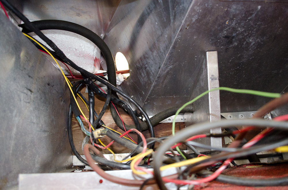

Here are some pics:
Under the splashwell. Wiring was a mess!
There are nuts on the backside of the bolts.
Mine were so rusted out I had to use vice grips to hold the nuts to get enough torque to get them off.

I would have gladly taken your wiring mess.
