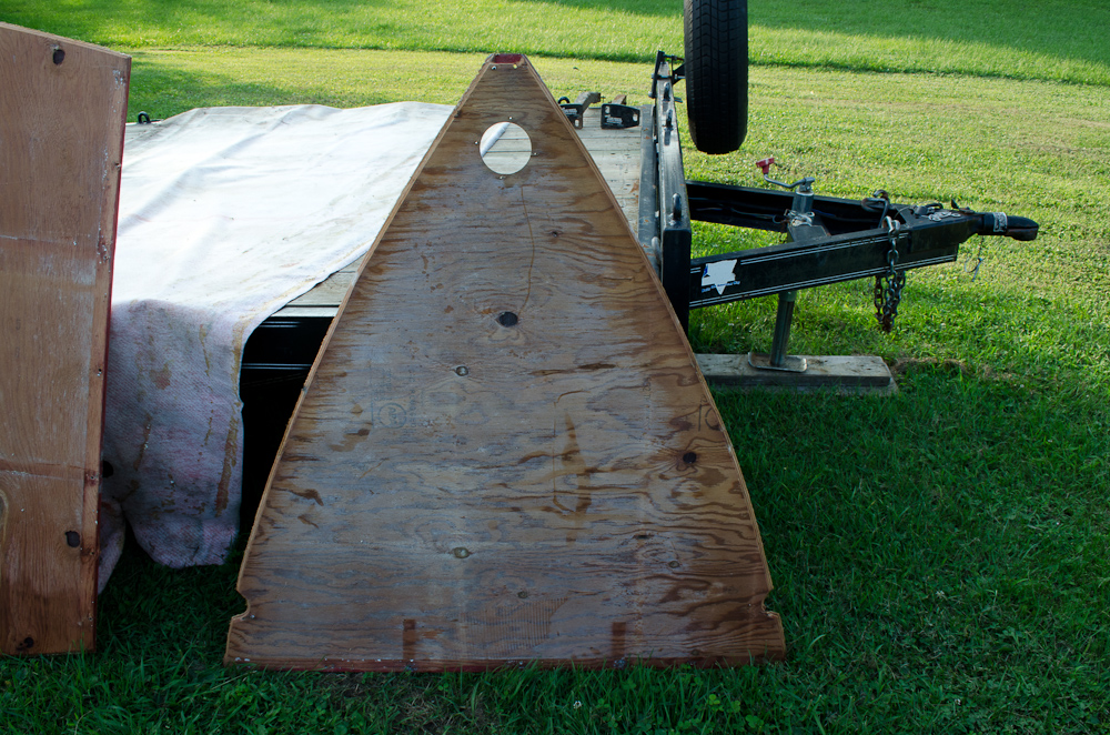

#3b: Find a good flat surface & clamp/weight the transom 1/2's together until dry. Any screws you use to 'clamp' it together can be removed & the holes filled prior to sealing it. Don't use your truck's weight. It may 'over' clamp 1 area & starve the lamination of glue, possibly even cup the transom.
#6: The transom ply sits in the channel that runs from chine to chine. Trim tabs & the transducer mounts may not be into the transom plywood:

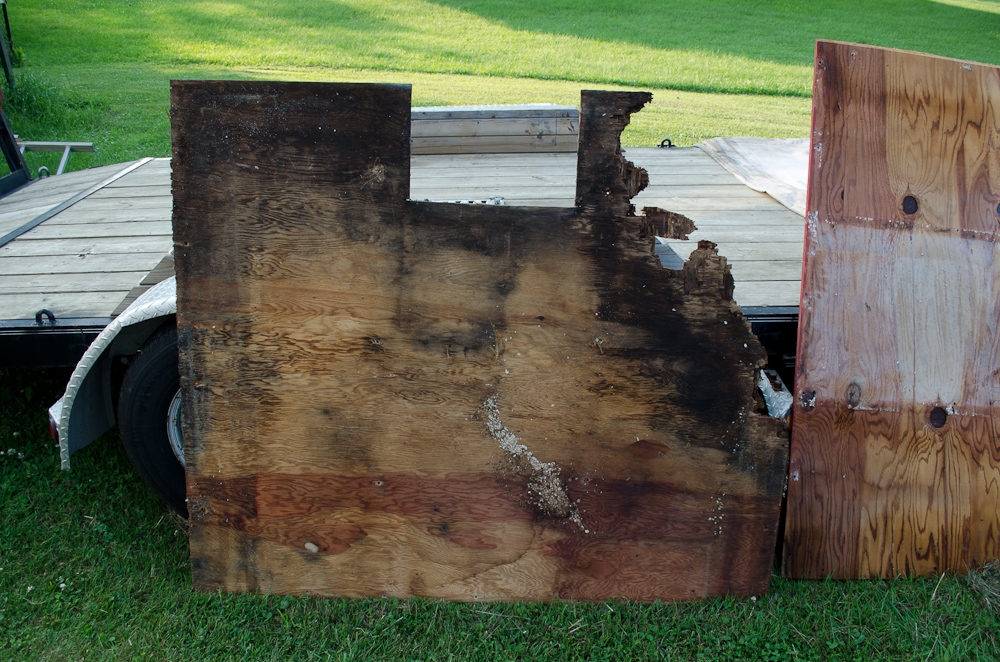

The rest of your boat appears to be in decent shape. As far as the ply goes if you work this fast on rebuilding as you did tear out you will be done in about three weeks.
You have decent templates to go off of which is very advantageous. Since you aren't doing any upholstery or really anything to over the top with it I would yank every piece of floor from the stern up, yank all of the foam out lay new foam lay cut and lay new wood and you are good to go.
Spar is much quicker and cheaper to work with than epoxy. If you do it this way and keep it covered you won't have to worry about any of the wood for the next 20 years. As far as cost goes to do the whole thing you already have to buy Spar or epoxy and about 32 square feet of carpet. You can do the whole for for an extra 10 hours and maybe $100. Then you have all of the white foam gone and never have to worry about any of it again.
I ended up using TITEBOND III for my transom glue and a bunch of clamps. I wouldn't use your truck for clamping worst possible case scenario I would use concrete cinder blocks spread evenly on the whole thing.

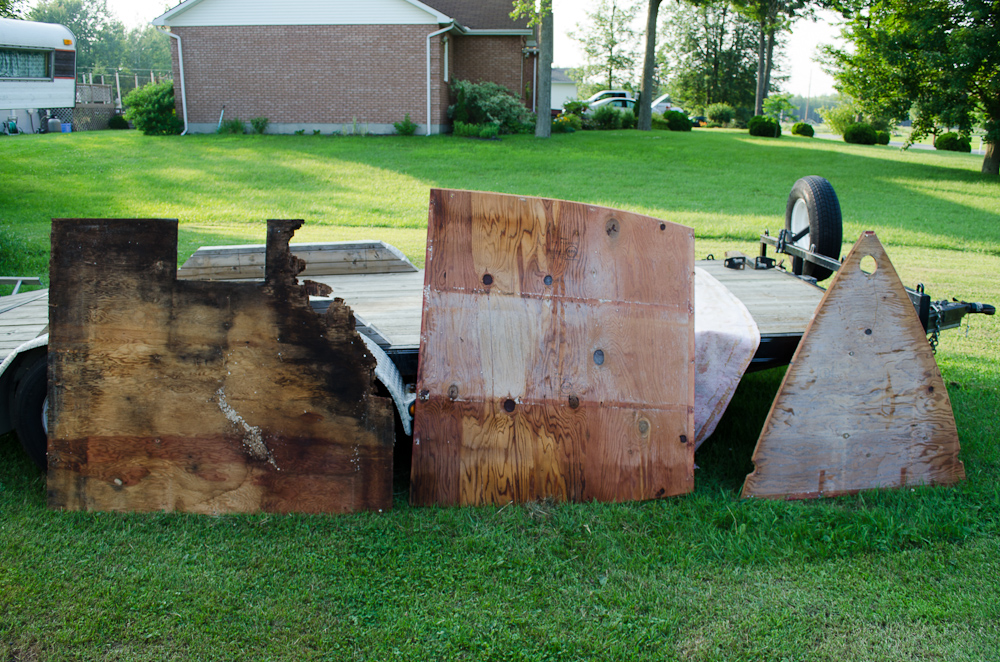

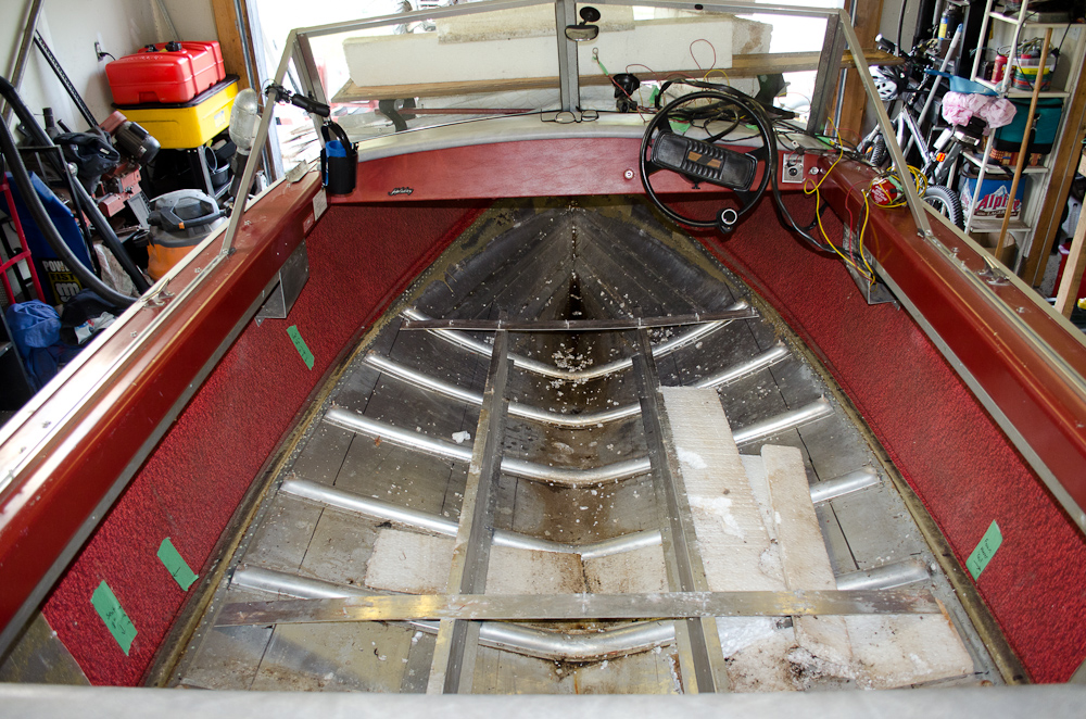

Just a little progress tonight after work.
Pulled out the rest of the floor and what little foam there was.

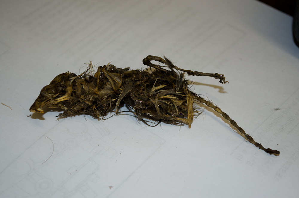

Found the nest culprit, or at least one of them, way up in the bow, semi-fossilized: Look at those teeth! Sabre-tooth rat!

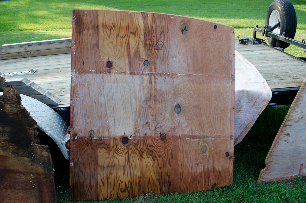

The floor sections removed:
Aft floor:

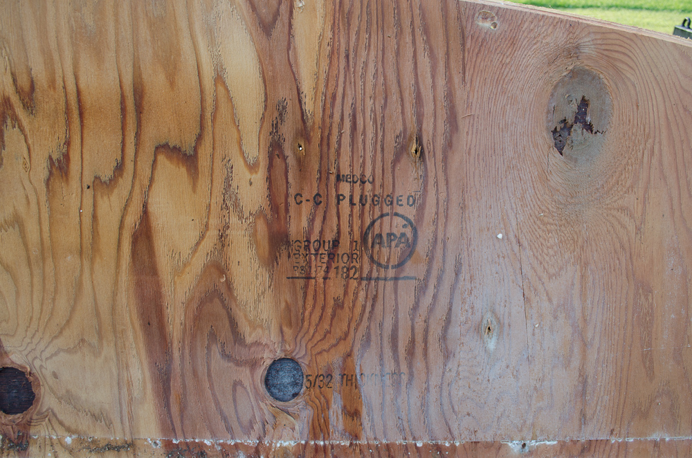

Mid floor. This is the underside. Note the knots. It is not marine grade. Don't know if it's factory original or not, but it looks like it is.
It says: "MEDCO / C-C PLUGGED / Group 1 Exterior / APA / PS174 / 182 / 15/32" Thickness"
Bow section, underside:

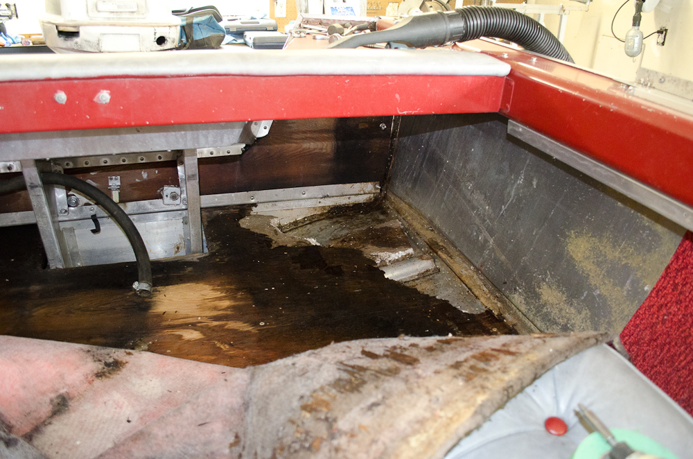

This was all there was fo r foam under the mid and bow floor (deck):
There was some standing water in the bow, right up front. I noticed that there is no way for it to get out unless it is over the top of the cross-brace / rib / spar (not sure the proper term)

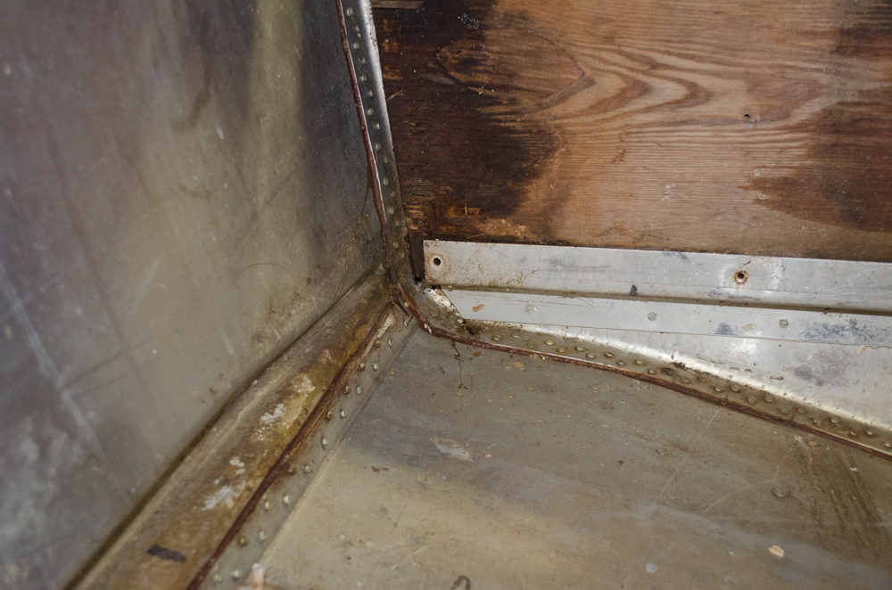

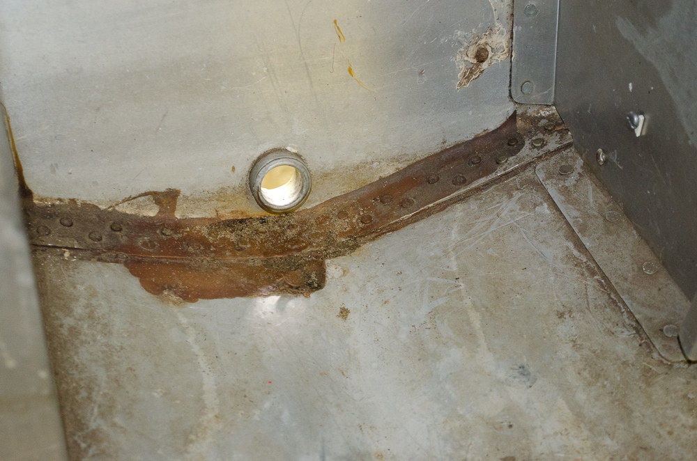

Now I need to focus on cleaning / inspection of the inside, especially the keel / bildge area. Here are some pics. Id appreciate if any of the experienced eyes could tell me if they see anyting alarming or that warrants particular attention. I'll point out what I noticed.

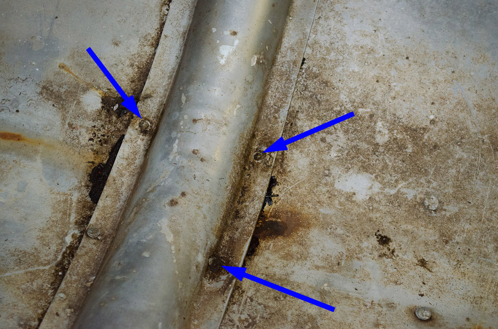

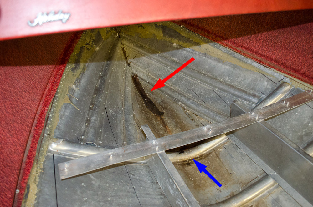

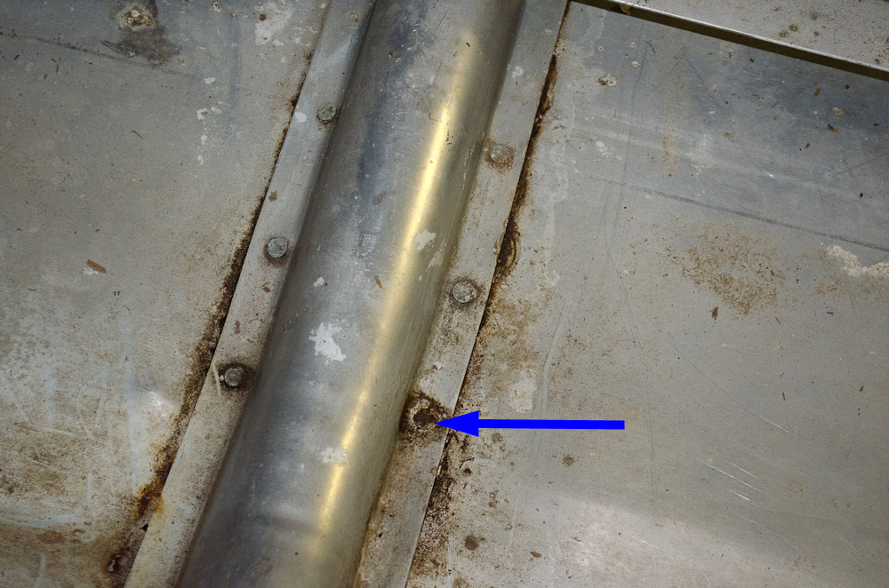

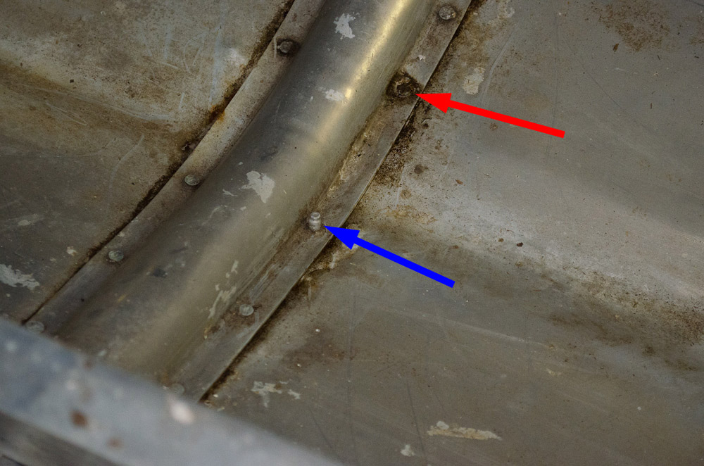

Blue arrow indicates what I think is a replacement rivet, but it doesn't look like the right type. Red arrow indicates a rivet that may be corroded away.
More corroded rivets?

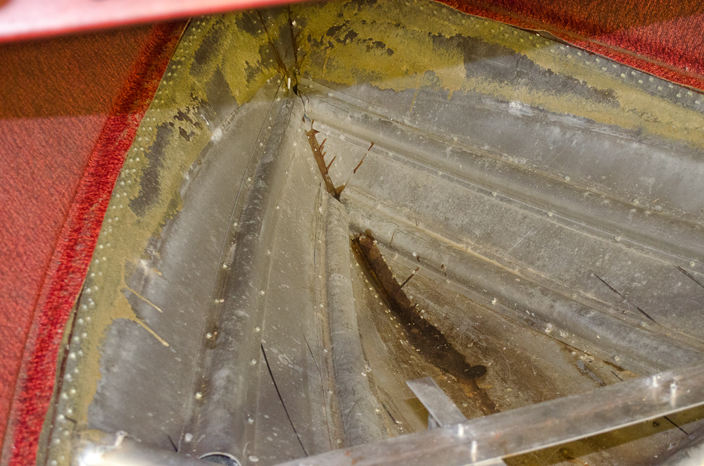

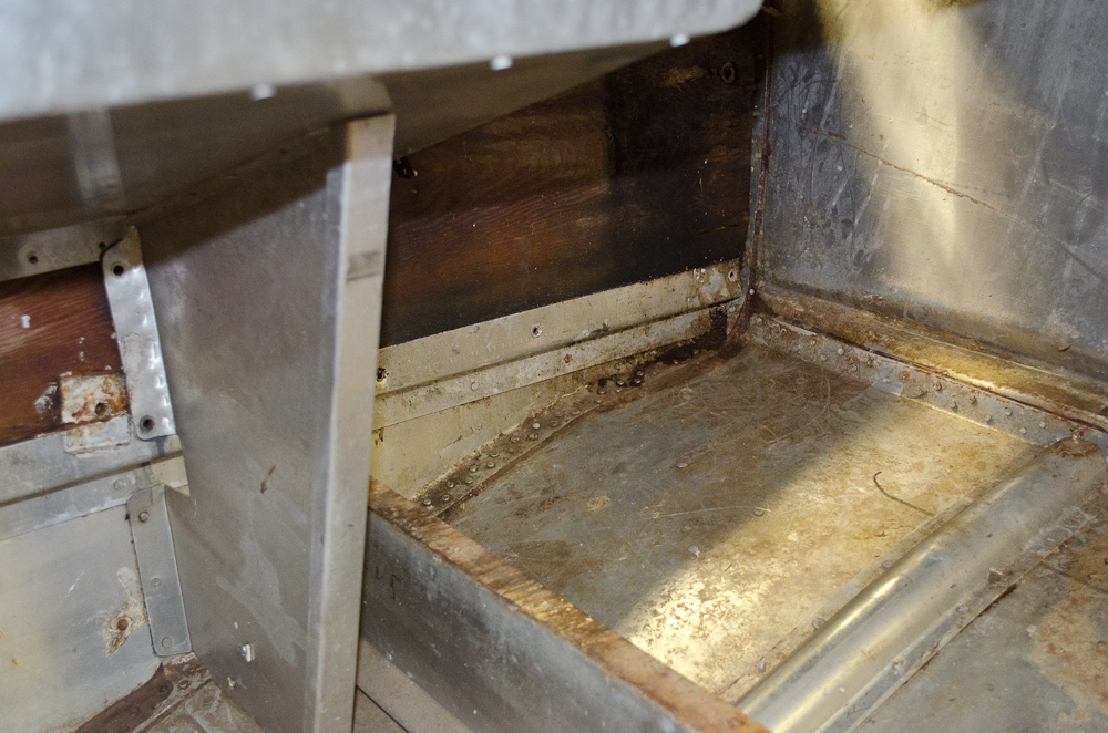

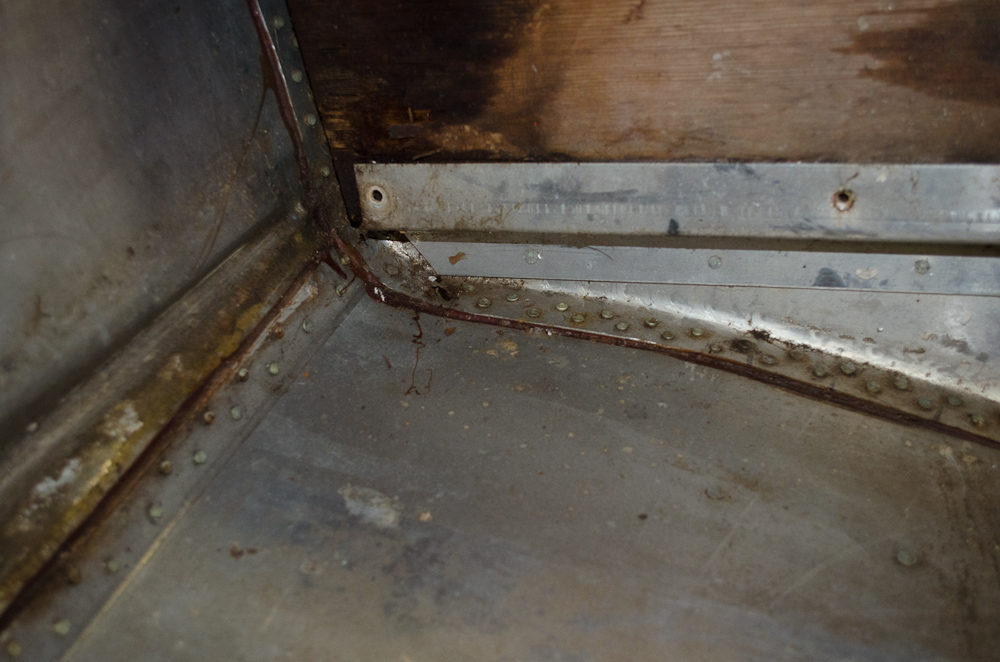

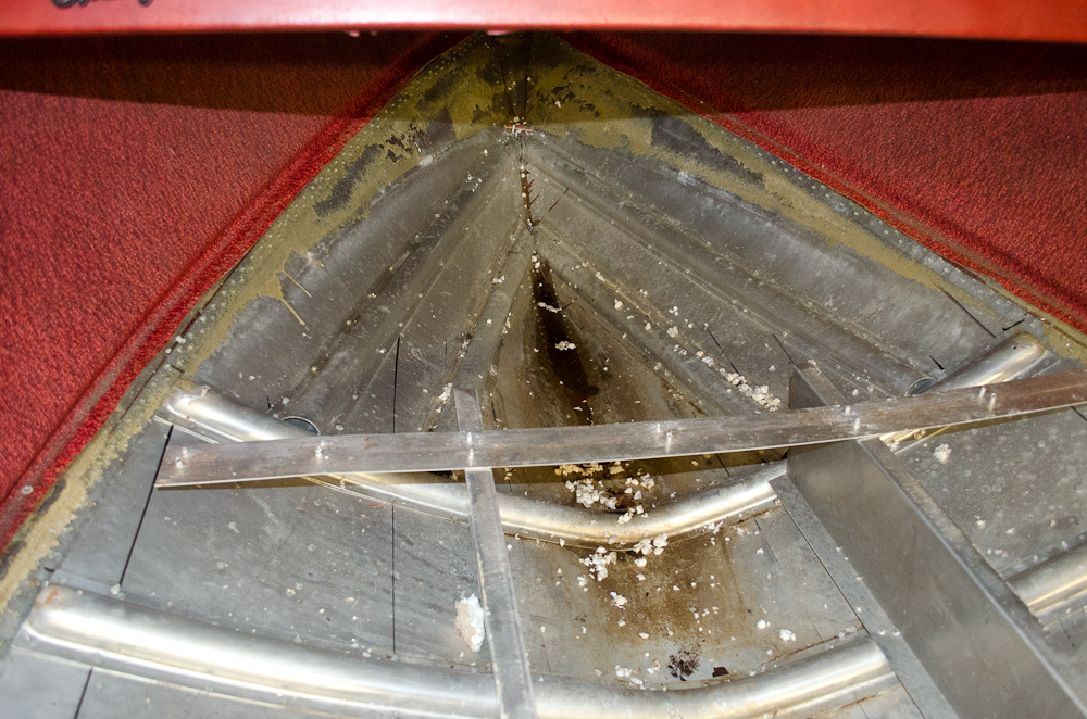

Some kind of red-ish sealant at the stern. Same stiff in the bow.
Aft sections:

Can I / should I drill a small drain hole at the blue arrow to let the water that collects at the red arrow area out to the bilge pump?

Between the arrows on the right side of this pix there should be a limber hole under the rib to let the water drain back to the bilge.
Most (all?) of the tinny SC's should have them, and most of them are debris filled like Stephan's. 1 or 2 ribs up near the bow may not have good ones. My Jet doesn't drain well at all from the bow side of the foremost rib, almost no limber hole. The rest do a pretty good job, once the bedliner was removed.

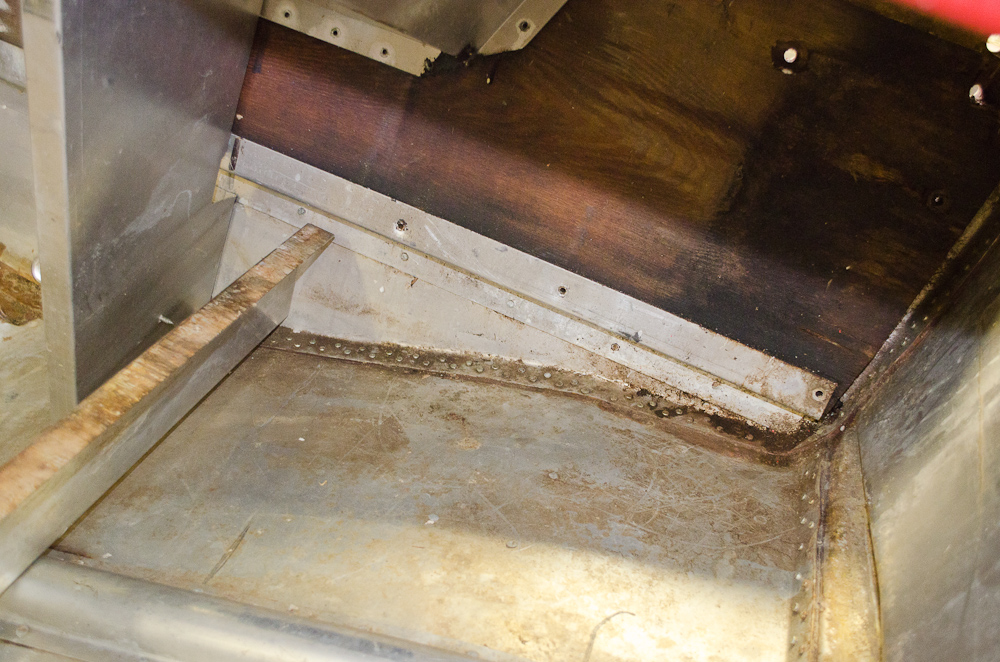

OK, not a lot of progress this weekend, but the new floors are cut and the transom is almost out.
I've decided to loosen the rub strips, remove some of the splashwell screws, and gently pry back the gunwals to get the old transom out and the new one in, rather than bending the aluminum gunwal corners. More work and time, but I just know with my luck the aluminum would crease badly or crack if I tried to bend it.
For any other newbies following I can confirm that the floor rivets are 3/16", as are the gunwale cap and other top stuff rivets.
For coating the floors and transom I ordered a gallon of Epoxy-Plus Marine Epoxy from Clark Craft.
I also ordered new stern gunwale caps from MichaelP (Search "Starcraft Boat Transom End Caps" on e-bay).
Next steps are:
- remove all the old floor rivets, test-fit the new floor sections.
- finish removing the old transom and build the new.
- start epoxy coating the floors and transom.
- pressure wash the inside of the hull, re-buck or R&R any suspect rivets, fill boat with water for leak test.
- install any needed new rivets then gluvit all rivets below the waterline.
BUT - I still have some questions that would help me with the next steps:
QUESTIONS:
1) Does it matter whether I use the C200 or C300 version of the pink extruded poly from HD for flotation? Price is only a couple of bucks between then per sheet, but might as well save it if no point in spending it. But if the 300 is better, I'll use that.
2) Should I remove the red factory sealant in the bow and stern and replace with Gluvit?
3) Can I use SS screws instead of rivets to re-install the floor?
4) Whether screws or rivets for the floor - is it critical to get them all exactly back in the original holes? If so, any tricks to accomplishing that?
5) Has anyone laid a poly vapor barrier on the floor prior to carpeting? Like the heavy plastic poly vapor barrier used in home construction? Any reasons not to? I want to feel as comfortable as possible - i.e. not flinch when the kids climb in from swimming or haul the tube in with 2 litres of water in it.
6) What size solid rivets do I need for the hull?
I don't think the type of blue or pink foam insulation matters as long as its the closed cell stuff.
Just Drill new holes for the floor.
SS screws are acceptable for the floor, though more expensive than rivets but SS Screws are a ton easier to install without and air riveter.
No need for a poly vapor barrier.
Can't remember the rivet size on the hull.
Additionally, I think all of the hulls are designed to have water flow underneath the ribs. Don't drill holes. I cheated when I cleaned my limber holes out.
Basically I vacuumed the entire inside of the hull out put a bunch of water in it tilted the trailer forward, then tilted it back I went through each rib with the air gun on the compressor and blew each one of them out until water drained from underneath. Then I vacuumed again. Then I blew them out again until basically crap stopped coming out from underneath them.
Anyways, I am prolonging the inevitable here, I need to be in the shop working on my boat at the moment. Good luck I will check in on your resto again this evening.
