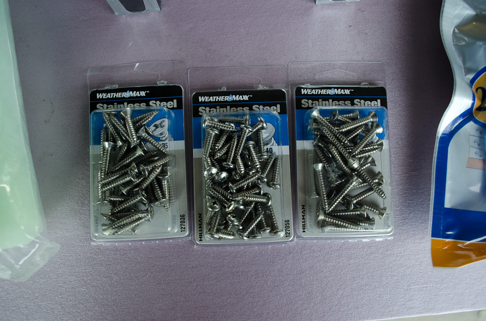

And some misc. stainless steel screws (Still not sure if I will screw or rivet the deck back in)
Couldn't believe the price at Lowes in the US (just across the border from me).
$5 get's you 35-50 screws in a pack, depending on size / length. Here in Ottawa they would be $0.50 - $0.80 a piece!

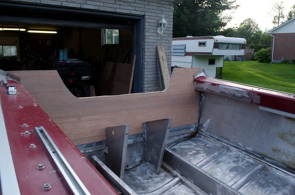

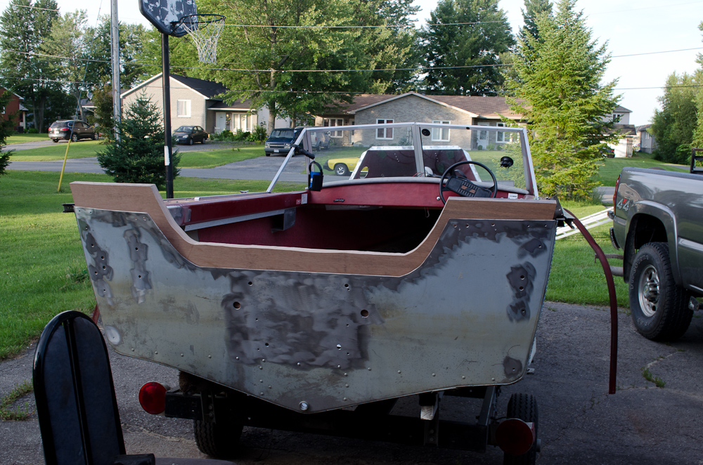

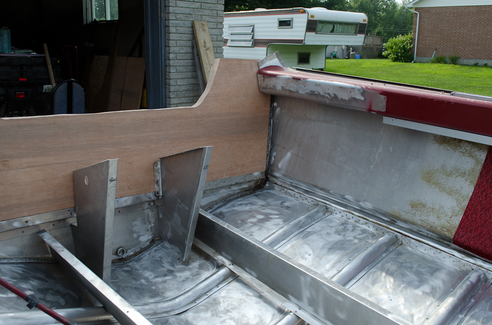

And finally a little progress.
The new transom being test fitted (man is it a tight fit!)
GA_Boater
May 24, 2011
49,038
Re: Tore the transom ...how to repair? (pics)
BV - It looks like you could trim a little in the lower corners. The hull tucks a bit there.

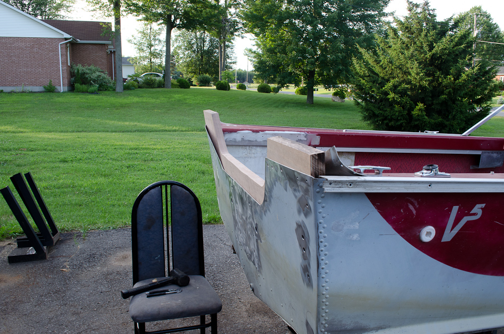

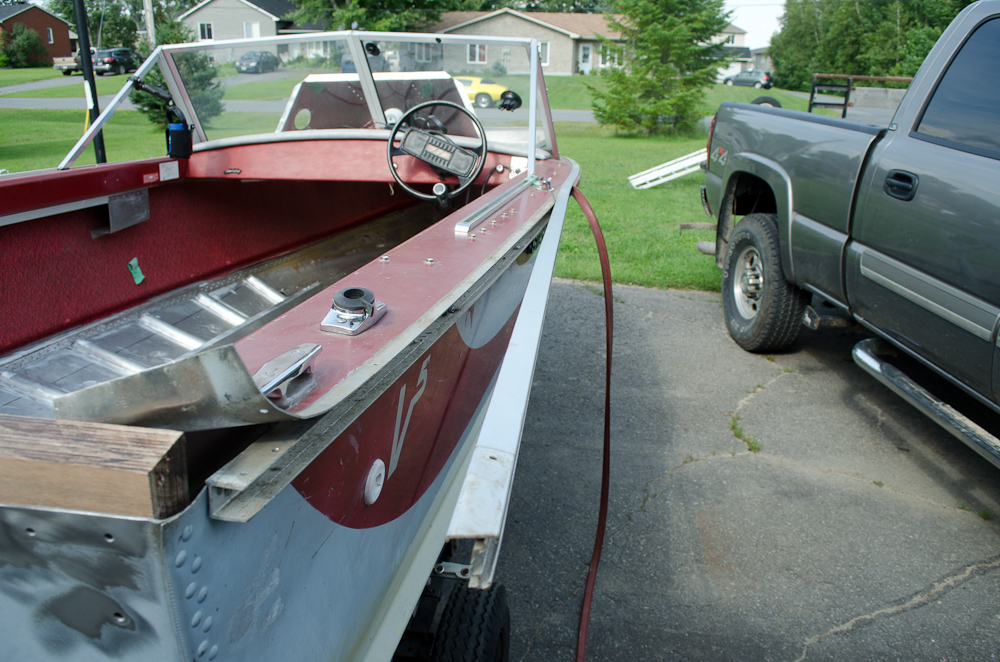

Thanks GA. I think it's a trick of the camera angle though. Here's a couple of shots from a different angle. It fits well down in the channel:

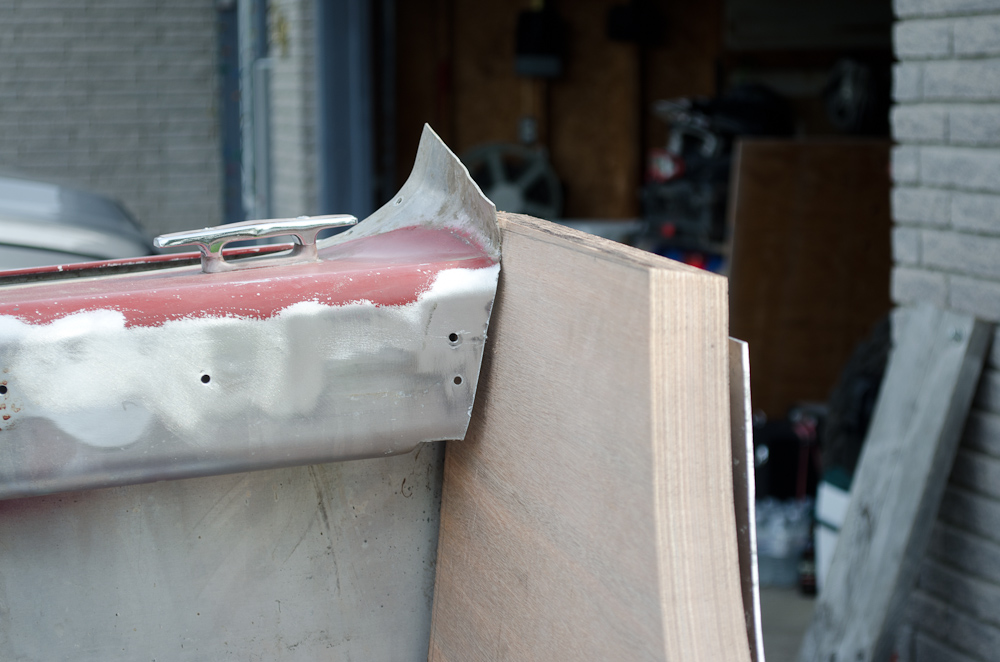

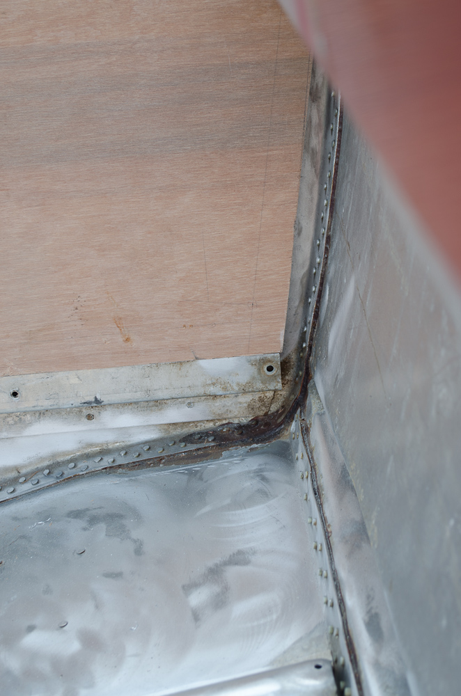

It turns out that the tight area was here, in the top corners at the end of the gunwales:
First I peeled back the rub strip and unscrewed the rub rail strip so I could de-rivet the gunwales quite a bit:
This gained me some clearance but it was still too tight and I don't like forcing things. So I put a zip disk in the angle grinder and trimmed the ends of the gunwales a bit, as well as removing the little brackets that screw into the transom. This allowed the new transom to easily go in and out.

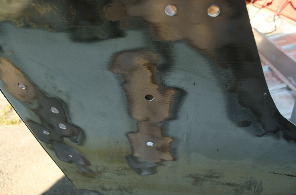

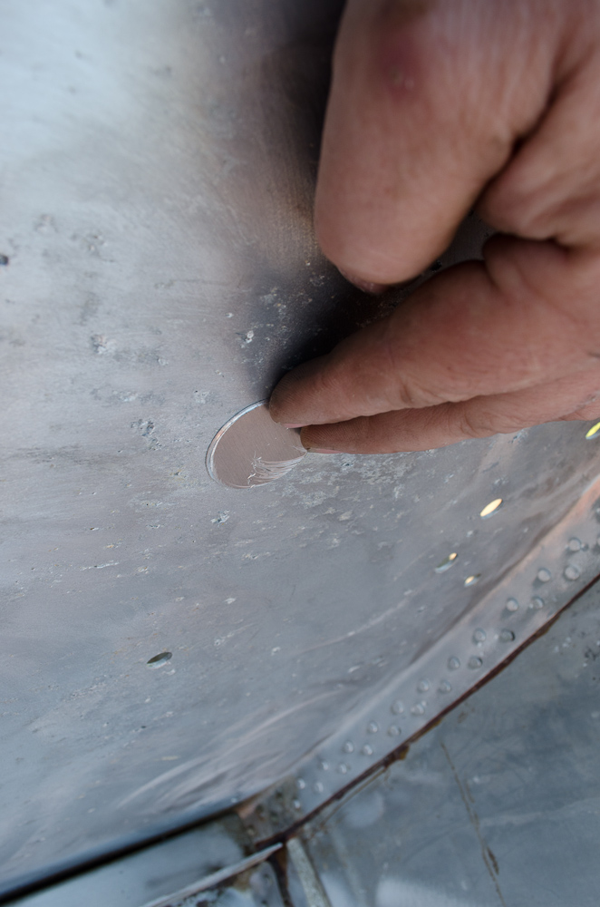

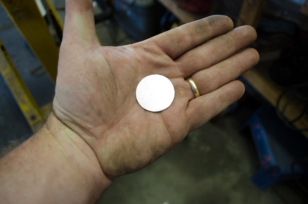

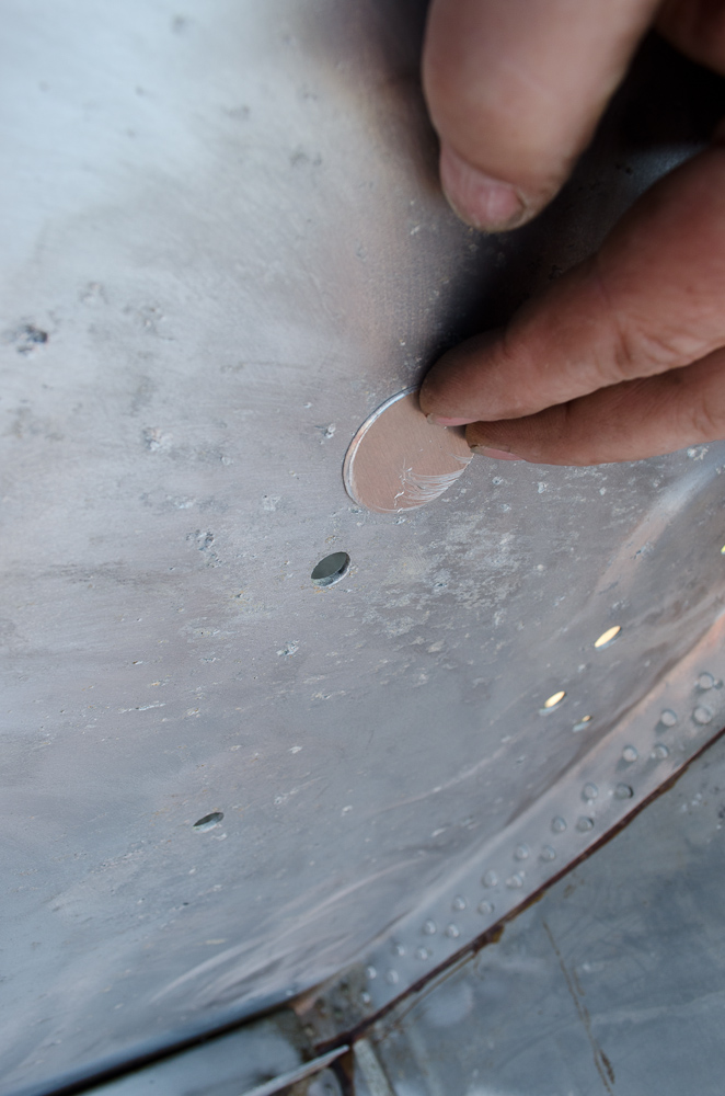

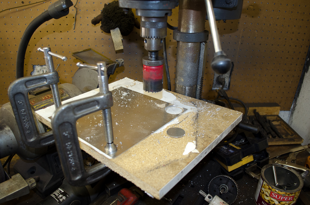

First I made some small patch disks out of some .040 T6 aluminum sheet that I bought. These will be used to seal all the extraneous holes people seem to end up drilling in the transom. I removed the pilot bit from a hole saw and cut out the patches.
The plan is to use panel bonding epoxy to bond them to the inside of the transom aluminum
Then from the outside I will fill in the hole with some JB Weld which can be sanded and painted

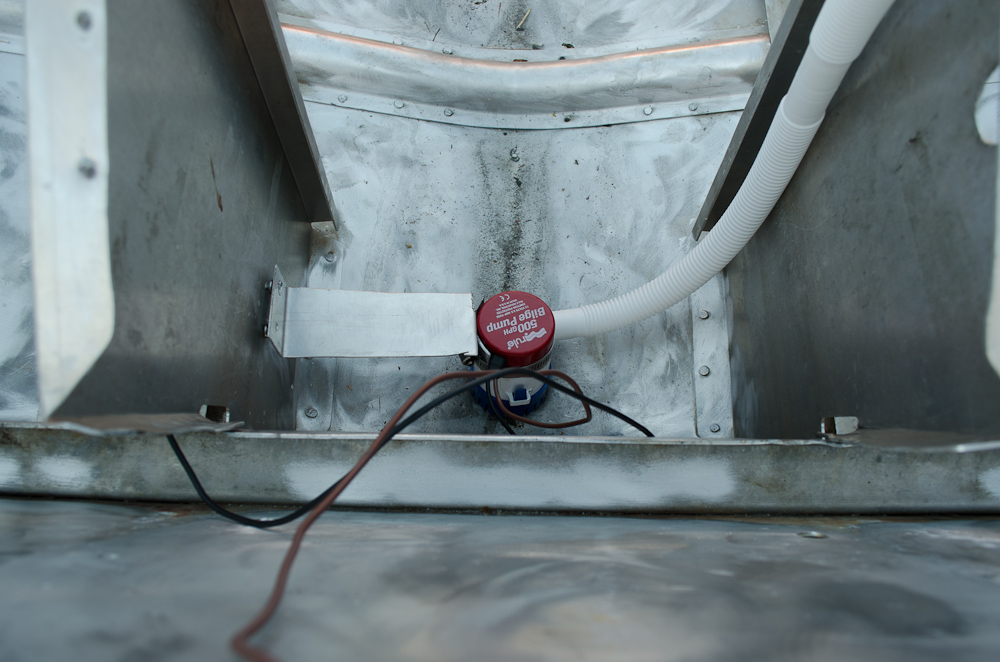

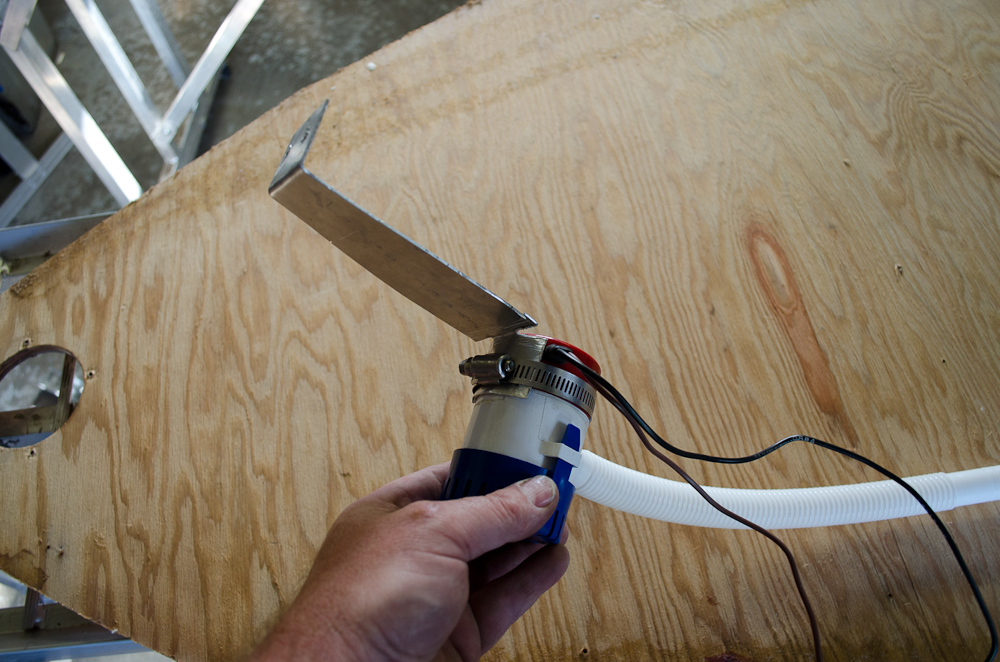

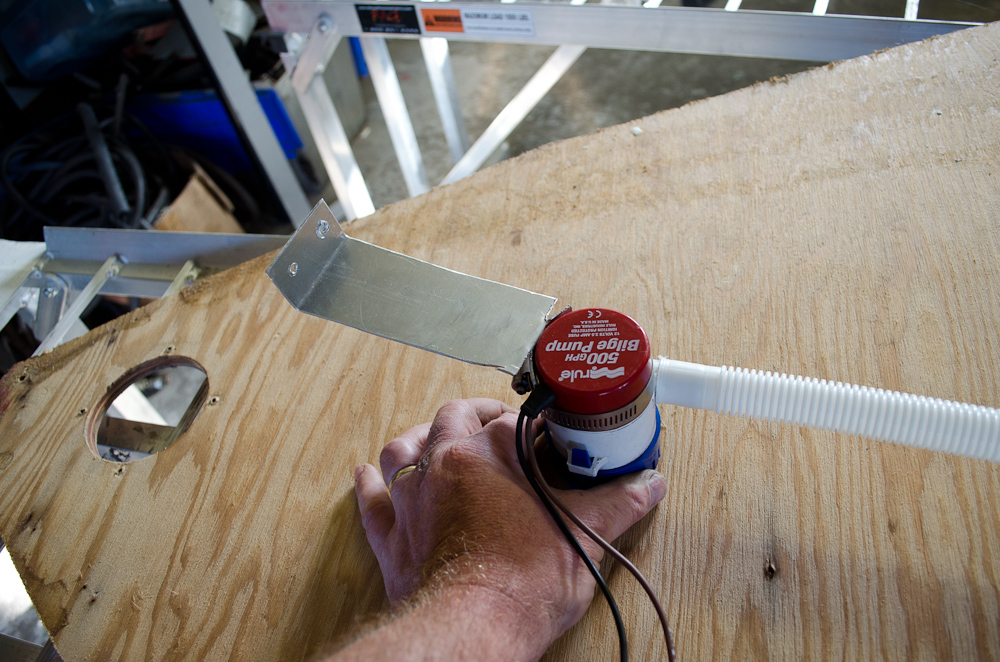

Then I made a very simple bracket for my bilge pump. I won't ever win any awards for fabrication but it will keep the pump in place. The boat's PO just had it flopping around on its side down in the bilge. Plus it was made from scrap and cost $0

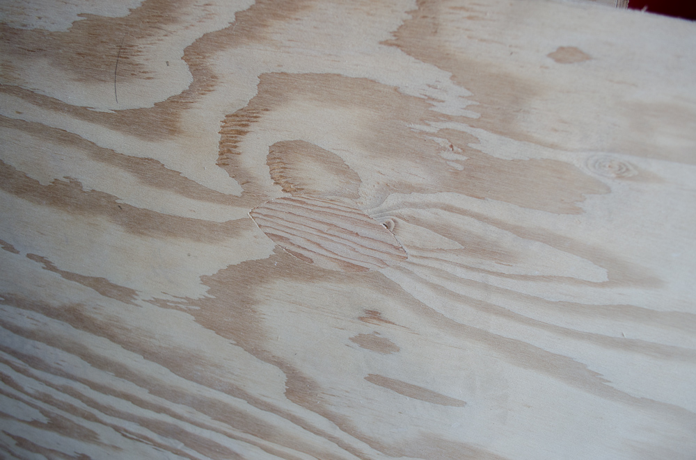

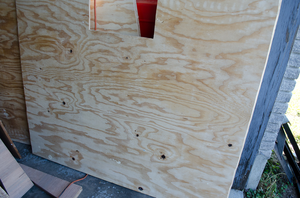

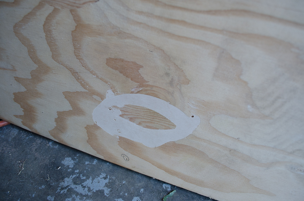

The first sheet I bought at a specialty store (because they were the only place that had the marine grade ply for the transom). I paid $35 for a 4x8 sheet. The quality didn;t seem that great to me (see pics later). But that store is a long way away, so for the replacement I just went to the local lumber yard. I asked the kid working there for "the best grade 1/2" exterior plywood (non treated) that you have". He charged me $52 for something he said was "spruce, fire grade". It was late and had been a long day so I didn't look to closely at it when it was loaded. Got home and the next morning realized it was crap! FULL of big knot holes. No good side.
So I took it back and explained what I was really after. The girl working sent me to the back to get a sheet of "fir, good one side" and refunded me $18 as it was cheaper.
Interestingly, and amazingly, this turned out to be the nicest sheet of ply I have ever seen. I can't even tell which side is supposed to be the good side - they are both good.
Pics:

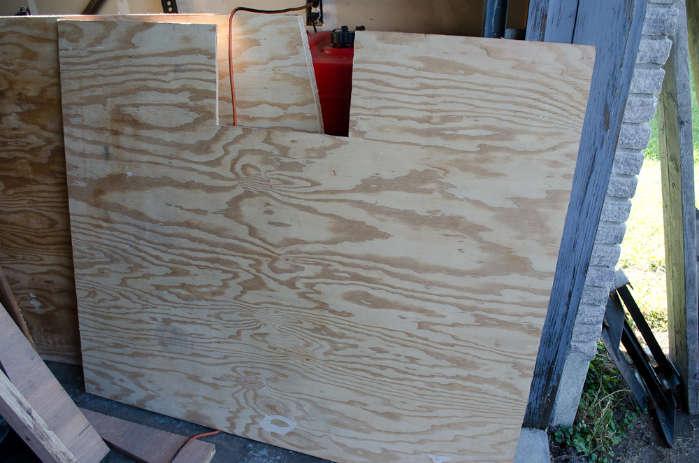

The original sheet from the specialty store. This is the "good" side.
The "bad" side:
But the "good" side had a lot of these ovals glued in:
And a bunch of this filler used to make the "good" side:
I didn't take pics of the "fire" ply...but trust me it was terrible.

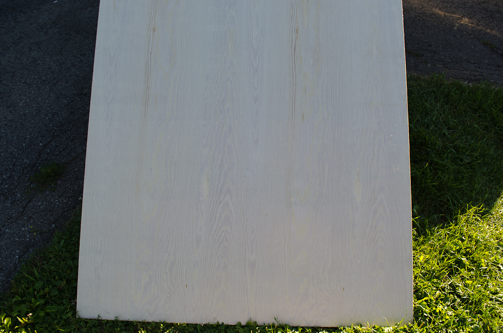

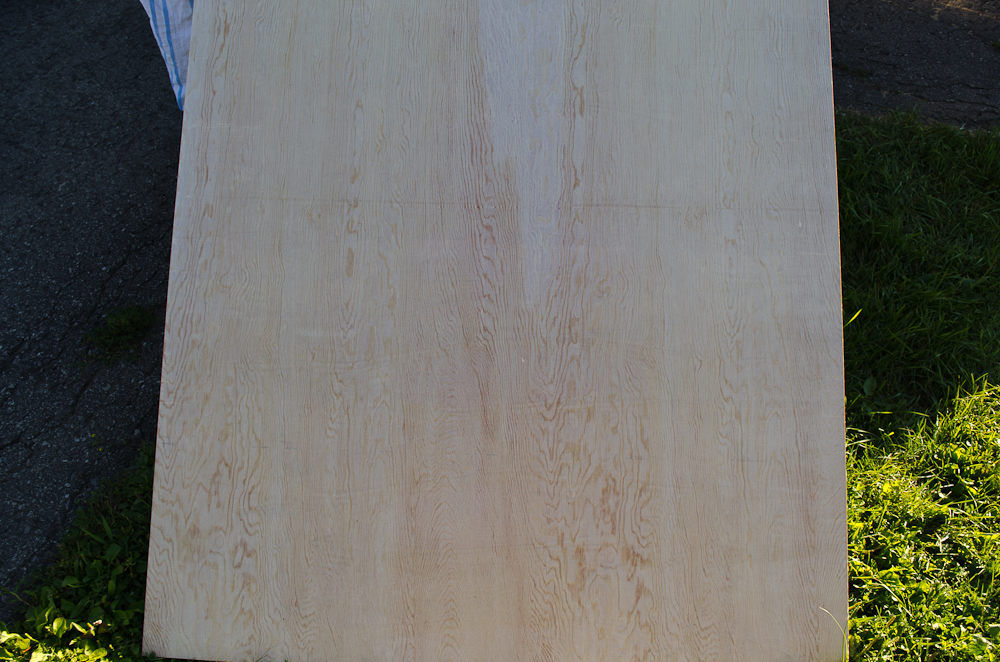

Now, here is the cheapest sheet, from the local place:
One side:
and the other:
Now, I'm happy to have a nice sheet for the aft floor. But I wish I had known that the specialty store would sell poor quality and overpriced at that, and I wish I had gotten the more helpful (knowledgable) girl at the local place - because that way I would have bought 3 really nice sheets for all the floors!

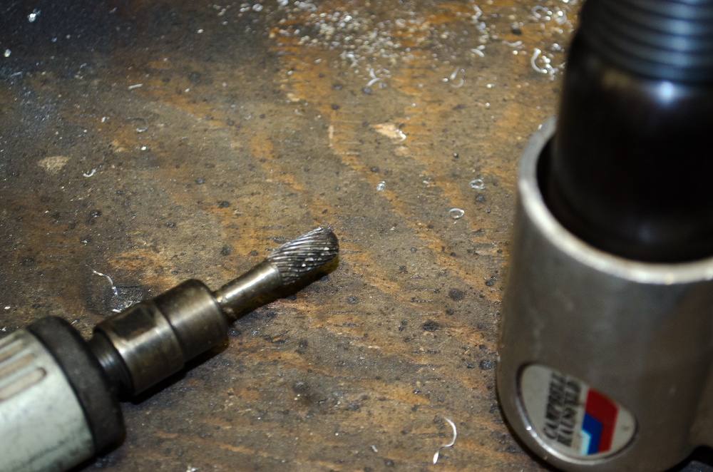

And the rest of my shop time I spent trying to convert my air hammer to a rivet gun.
I chopped the end of a chisel, then used a die grinder with a carbide bit to hollow out or contour the end a bit to sorta match the profile of the rounded "traditional" head on the solid rivets. Finally I added a small inline regulator to try and control the hits.
Tomorrow is rivet day - no more avoiding it!
Pics of the home-brew tool.

Hey Bill - I like the holesaw backing plate idea. :thumb: And making a rivet gun - that's a :thumb::thumb:

Best of luck w/ the home built riveter. Looks up to the task.
