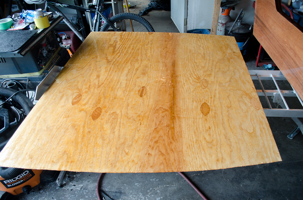

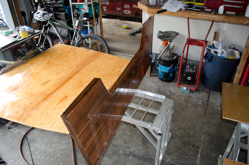

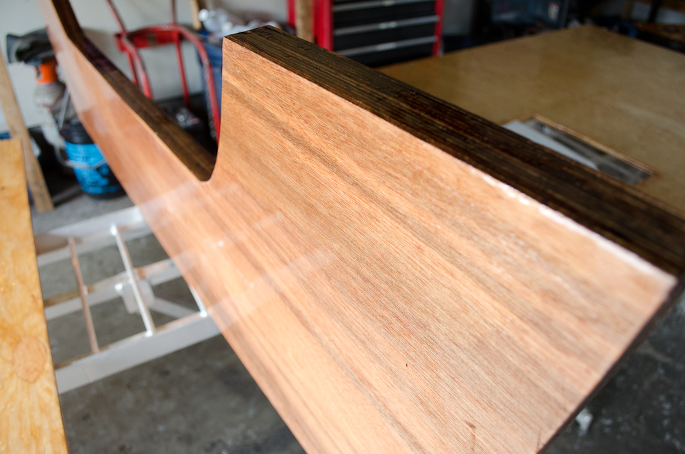

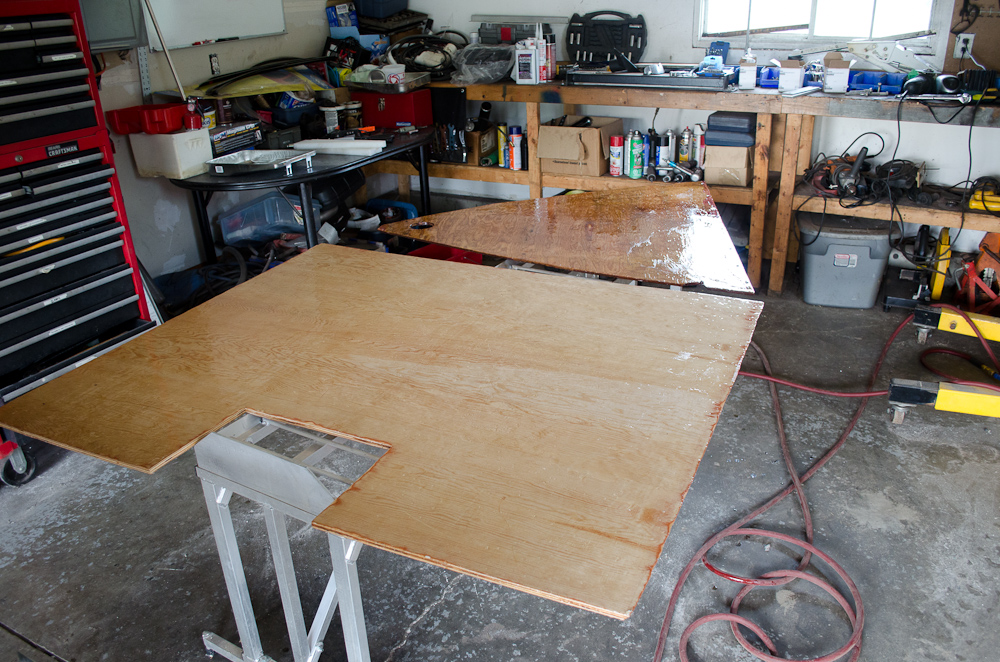

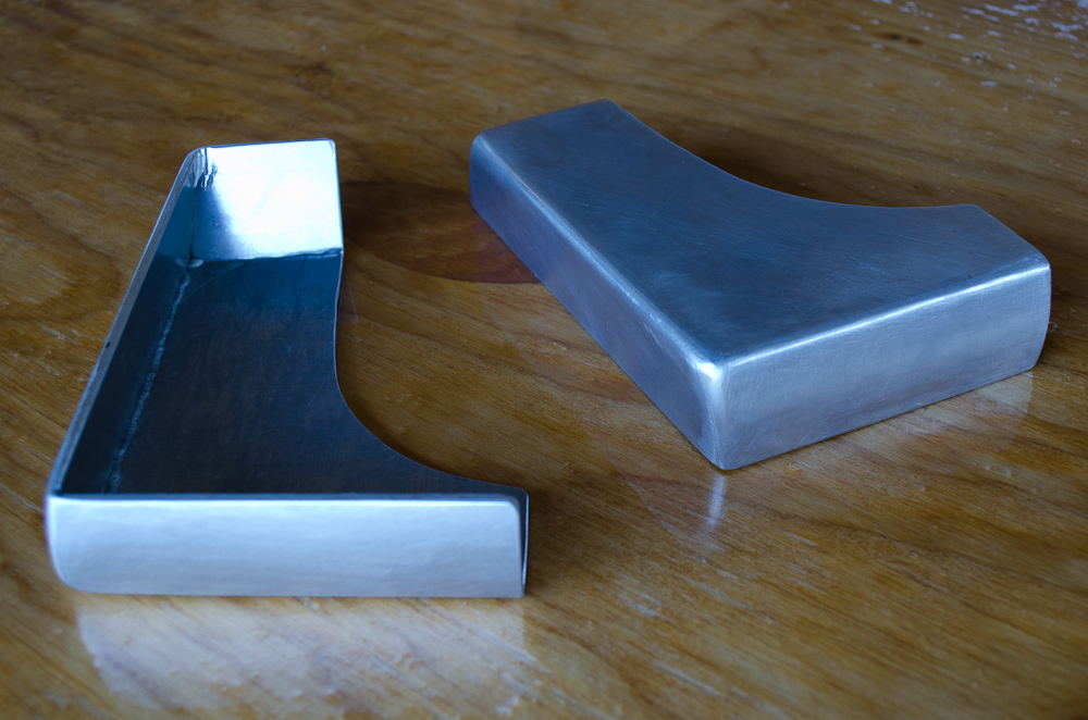

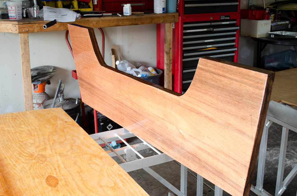

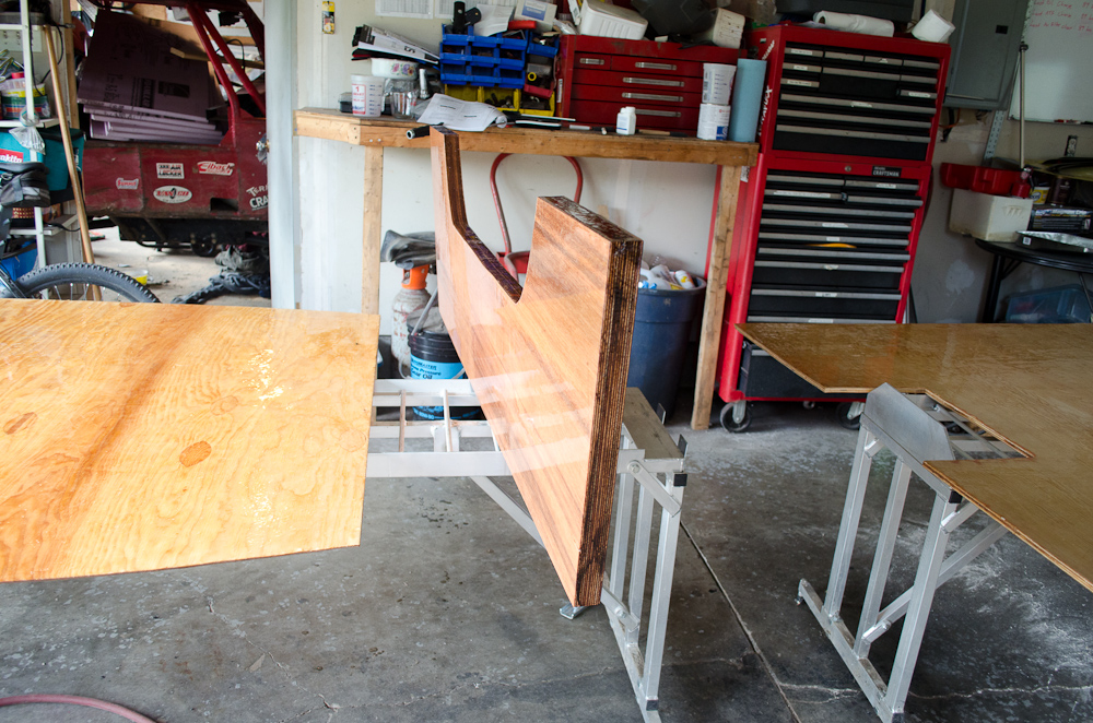

The transom is done and ready for install!
Lookin' pretty shiny too!
In one of the pics, it looks like a camera blur - but it's the reflection of the aluminum stand it's sitting on.
Pics:
Floors are done too.

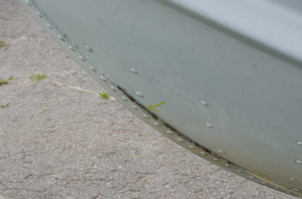

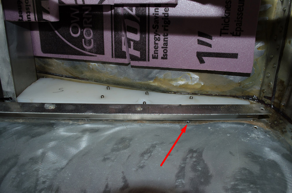

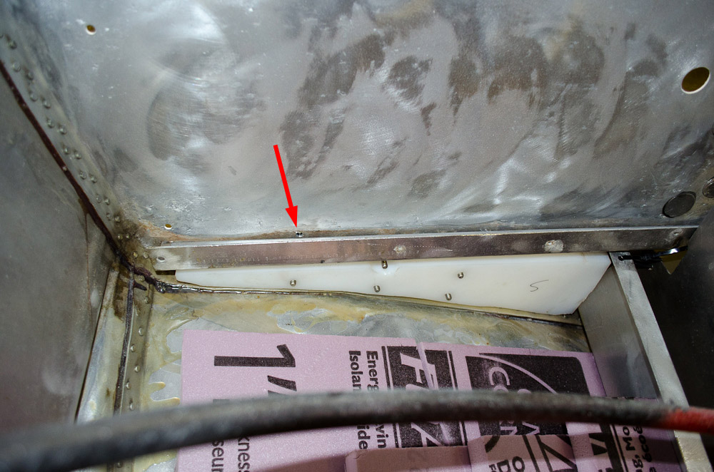

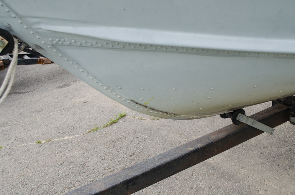

Question time!

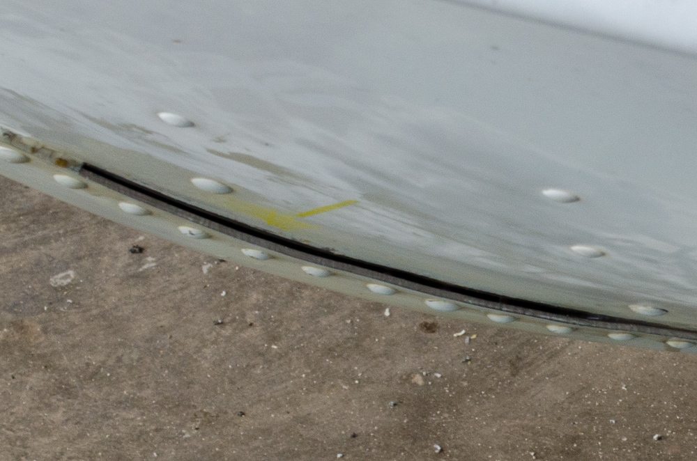

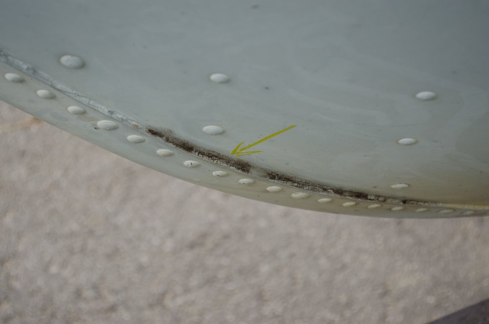

I am left with just one small leak.
It's coming from the area indicated by the yellow lumber-crayon arrow I drew on the hull.
It looks pretty obviously like it's some old sealant no longer working (it doesn't appear to be a loose rivet).
Should I:
a) Dig this stuff out from the outside as best as possible and re-caulk with 5200, or
b) Gluvit the snot out of the area from the inside, or
c) Both, or
d) something else?
Thanks

Bill it depends on how u want it to look cosmetically id probably do both and rebuck all the rivets as well.
Bill DONT forget u need to coat all the epoxy with something else as well i.e. Spar or exterior paint as epoxy has no uv protection to it and it will begin to break down looking good keep up the good work

Question time!
Should I:
c) Both, or
d) something else?
Thanks
I'd dig that old crapola out and clean it up the best I could and remove and replace the dozen rivets in that bad spot installing new 5200 after the old rivets came out and before the new ones went in. Then Gluvit the snot out of the inside.
Your boat is going to be much happier with all of the leaks fixed. She'll also be a lot lighter and dryer increasing her performance too.

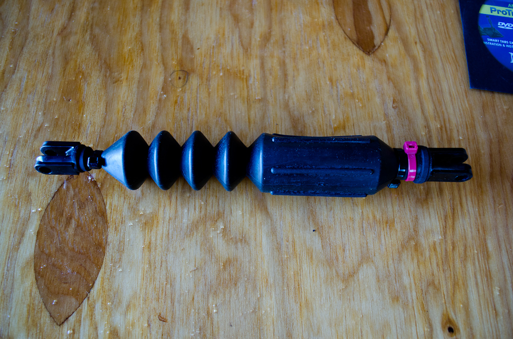

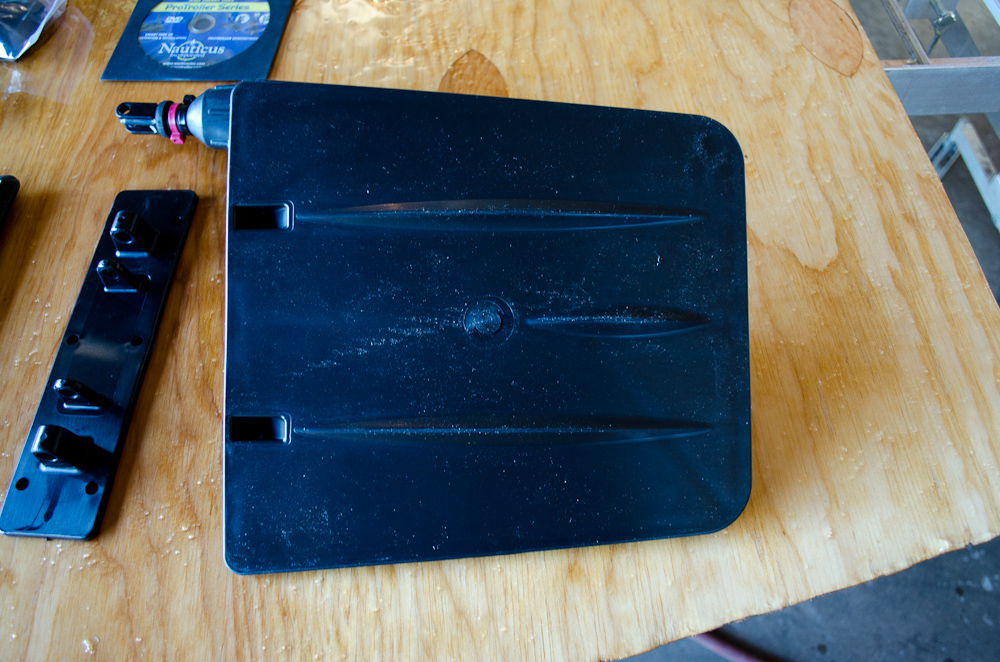

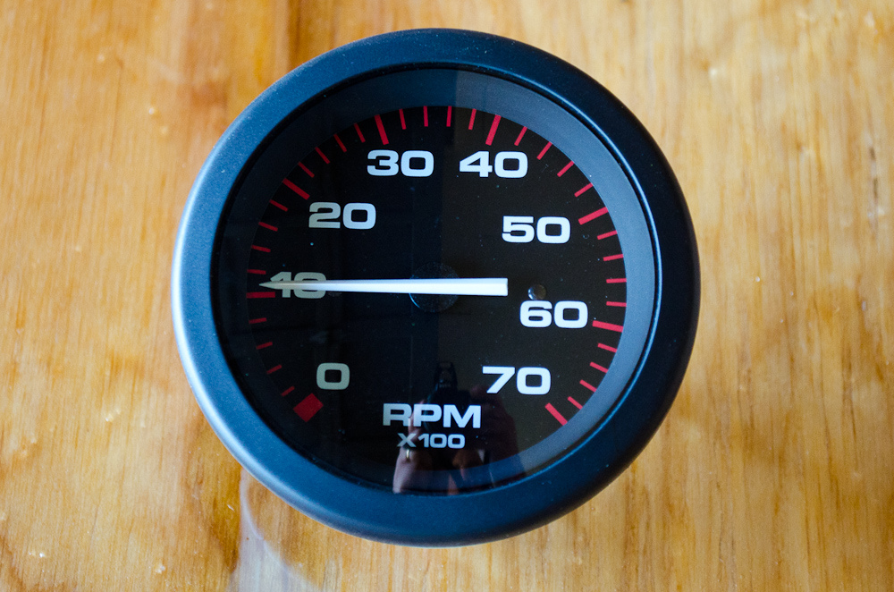

But a few things came in the mail:
Gunwale corners from MikeP via E-bay. These things are awesome!
A tach from Teleflex.

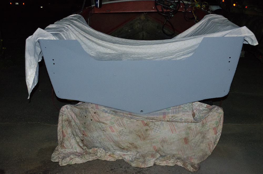

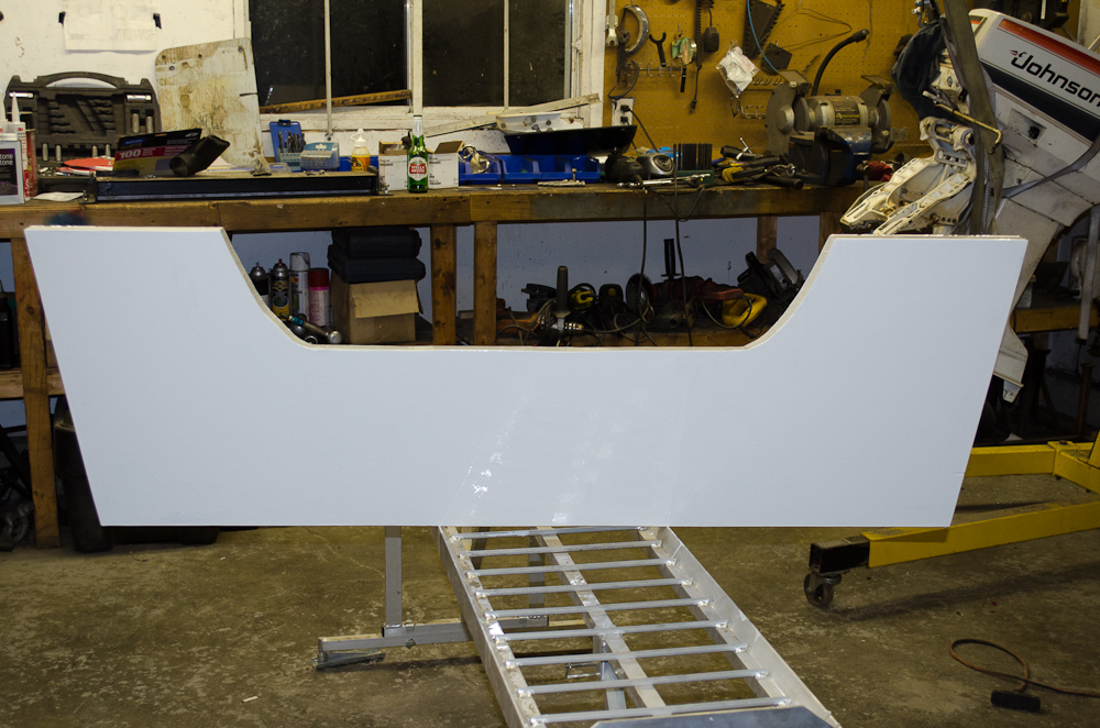

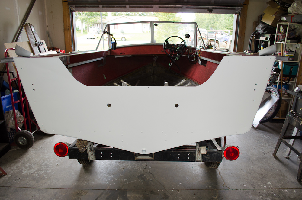

The transom is painted:

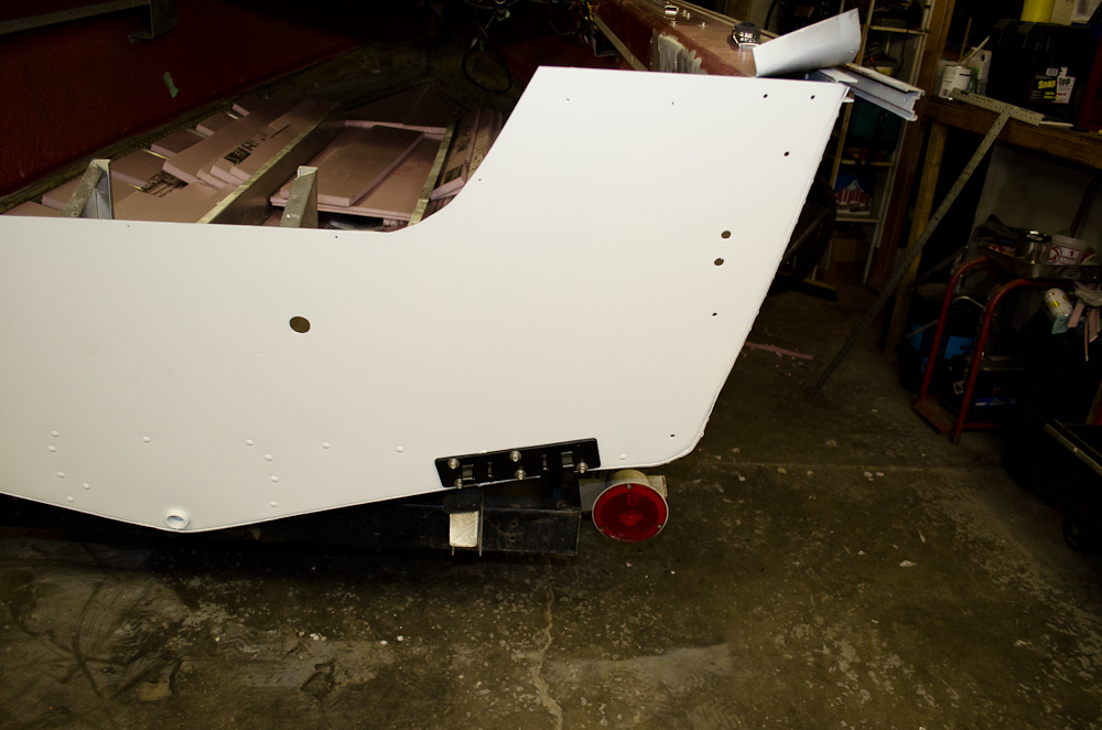

And the stern has all the holes patched and filled and one coat of primer:

The buck-babe carefully dug out the rotten and crumbling sealant from my last remaining leak area. I then squeezed some Gluvit down in there. I am also going to fill the remaining gap with a nice 5200 bead. I have decided not to try and re-buck the rivets as the two closest to the leak have their back sides hidden under one of the ribs in the bow and I don't want to buck some near the leak but not those immediately adjacent as that might make things worse by pulling things out of alignment. Besides, it was a very small weep and the sealant had clearly failed / dried out so I am confidant the Gluvit / 5200 combo will improve things.
If I am wrong - well that's what the bilge pump is for, I guess!
Besides, if I don't reach the "stop messing around and start physically putting things back together" stage very, very soon I am going to reach max frustration point.
The stern is top-coated in gloss white Rustoleum spray-bomb (which isn't very glossy):
Final Gluvit coat done:
Have to say - scrubbing around on hands and knees up under the bow cover slopping Gluvit around, banging knees, sweating into the Gluvit can, and trying not to make a big mess or step too hard on any of the areas where there aren't ribs was, perhaps, my least favourite part so far.
Hopefully foam down and floor/deck/sole back in soon!

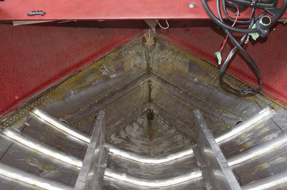

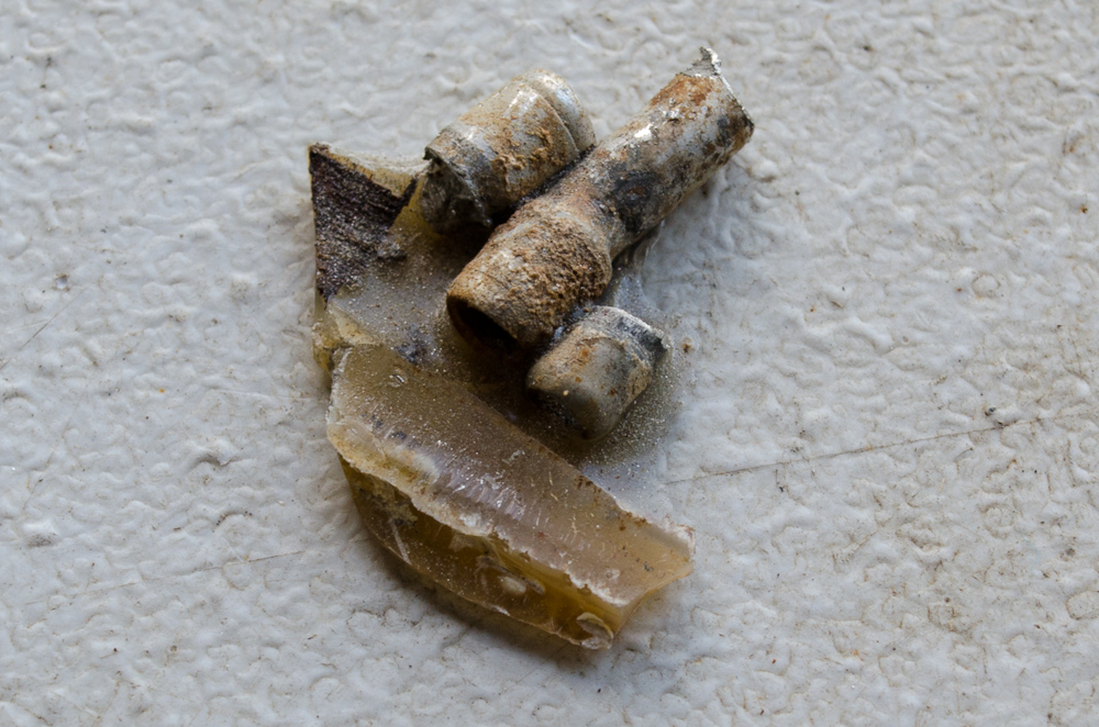

So, before starting on laying the foam in, I decided to do a final check of the drainage passageway under the ribs (what's the proper word for that again?).
Anyway, good thing I did. One was completely blocked. Huh? I cleared them all out a while ago - what's going on? It felt like a really solid blockage - bent a hacksaw blade and a nail trying to punch it clear.
Here's what I eventually worked loose and removed:
Some Gluvit had pooled under there and stuck together with the ends of some of the old floor rivets, forming a really solid blockage!
So a few tips I learned:
1) Be careful with the Gluvit in the area of the drainage passageway under the ribs
2) Take the time to clear out the drainage passageway under the ribs - it's very important that water not be able to pool and not drain.
3) I found it very useful to blow out the ribs with compressed air - all sorts of crap came out including rivet ends and old bits of foam and rotted floor slivers and chunks.
4) If you used a wire wheel on a grinder to clean up any part of the inside of the boat, be extra vigilant for the little twisted wire bits that come off the wheel during use. They are steel and if left will corrode and make a mess.
jbcurt00
Oct 25, 2011
25,262
Re: Tore the transom ...how to repair? (pics)
Drainage gap under the rib: limber hole
GREAT catch on the Gluvit & debris blocking the limber holes.

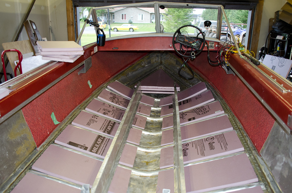

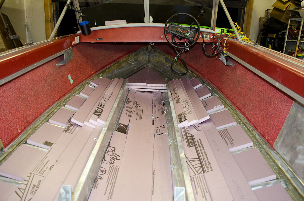

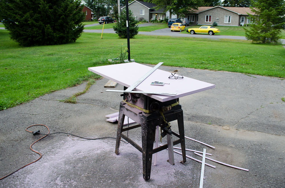

Got to work on the foam.
Table saw works pretty well for cutting it:
Making a start:
Starting to get fuller:

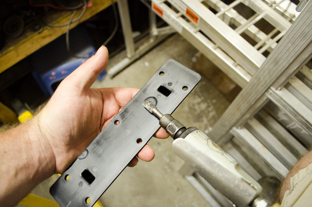

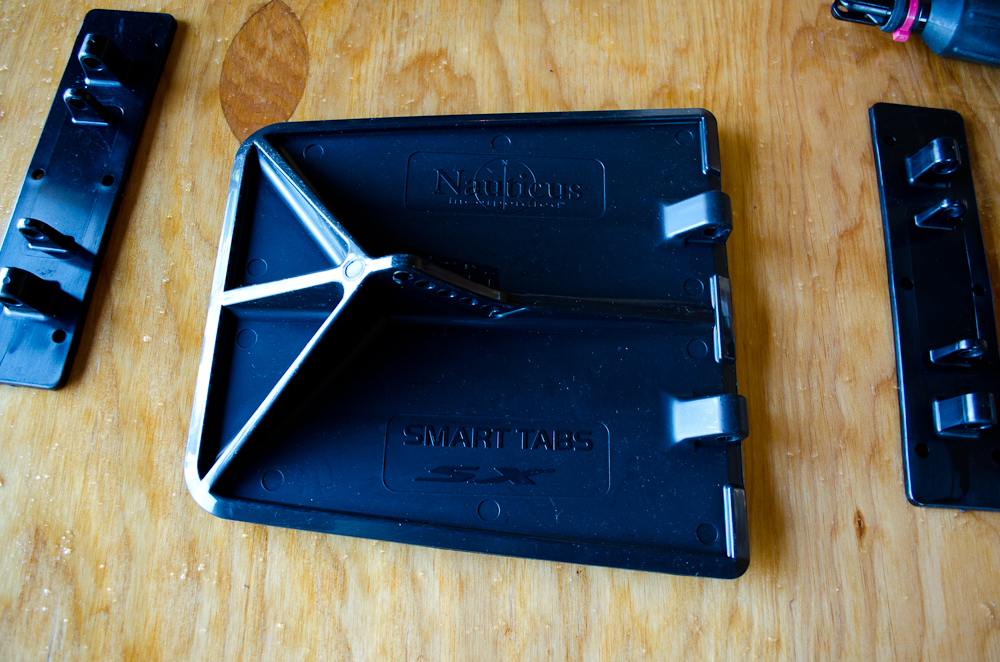

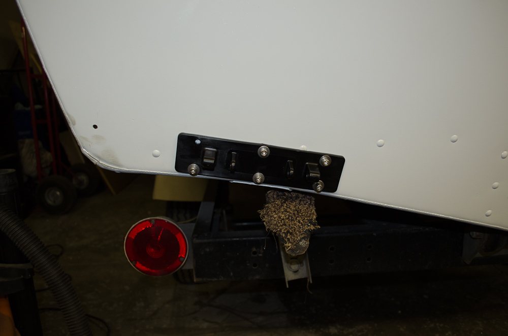

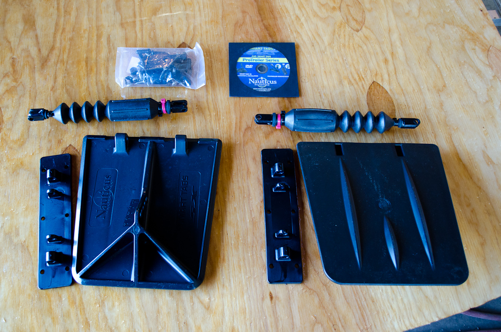

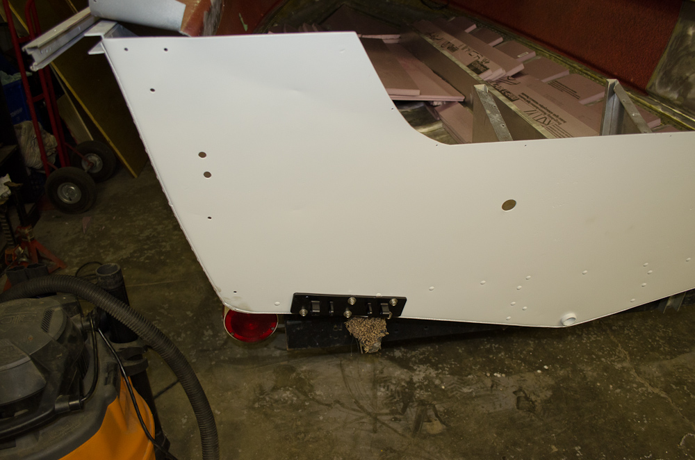

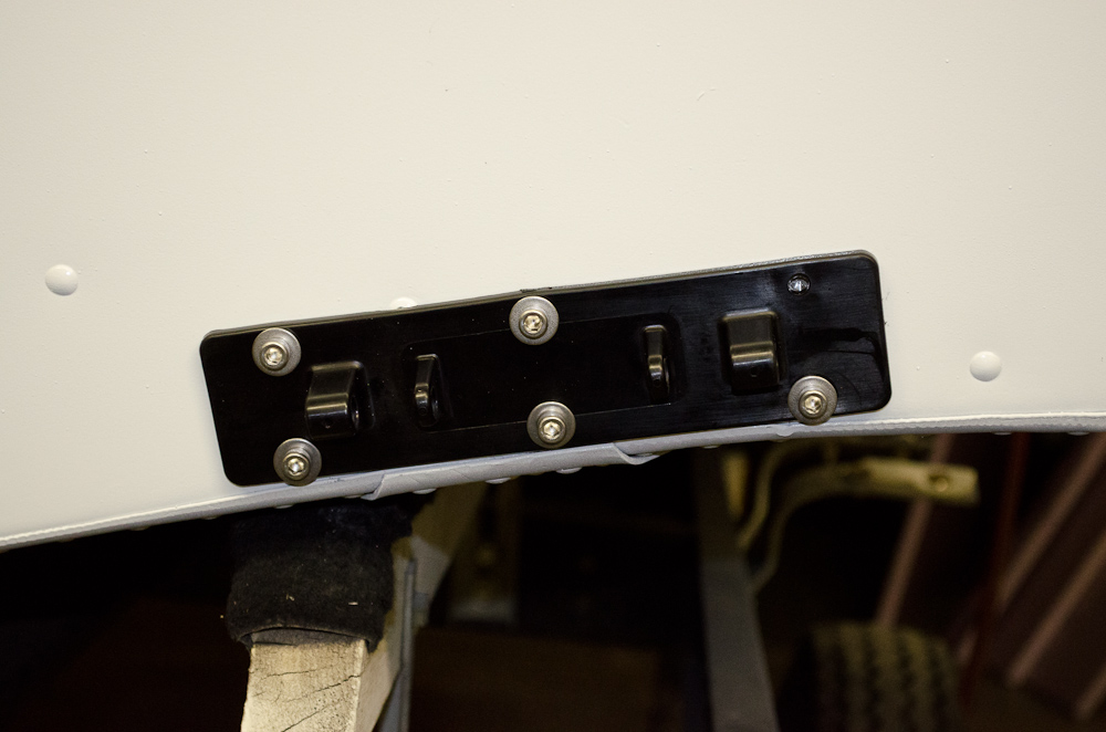

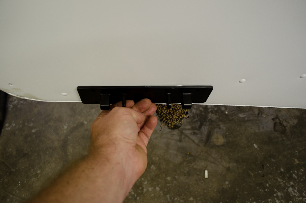

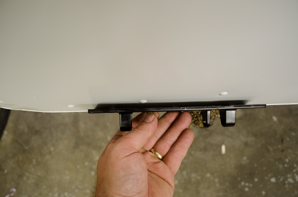

Worked on installing the Smart Tabs this evening as I need to get the lower brackets installed before I can finish the foam and install the floor.

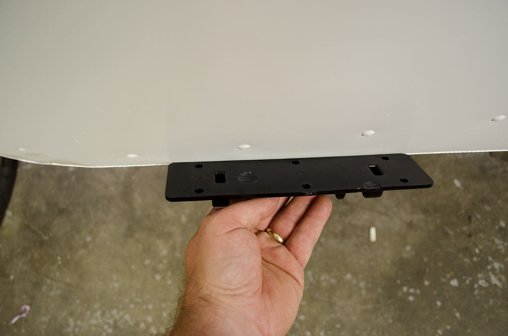

First thing I had to do was grind a couple of small reliefs in the back of the plastic lower brackets so that they will clear the rivets and sit flush against the stern when installed
Here's the Stbd side test-installed (no sealant used yet)
BillaVista
Jul 1, 2013
204
You might reasonably ask..."What's with the missing top bolt?"
Wellllllllll
It turns out that hole goes through the stern and into the area of the pocket where the transom will go - so not good for a nut and bolt which I am using for the other holes.
I learned though - so I may be one of the smartest monkeys in the garage.
On the port side I didn't drill this hole, and will wait until the transom is in, drill a small pilot hole, and use a screw into the transom.
I will have to use a screw and a bunch of sealant in the stbd side as well.
