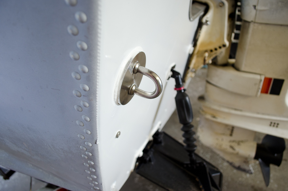

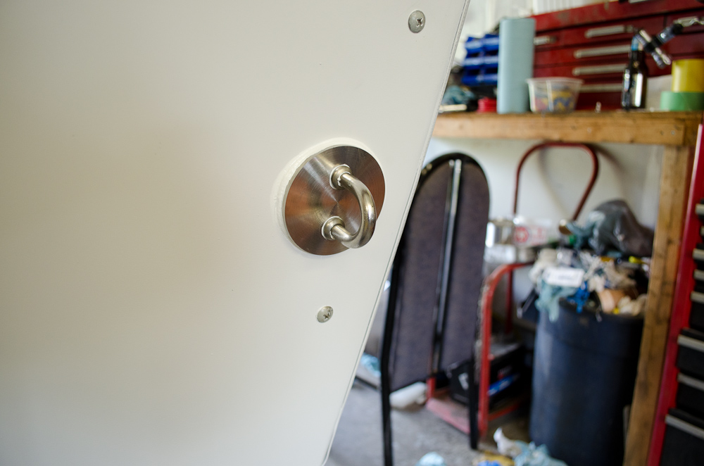

And I hate to ask, but where are your transom hooks - isn't that what started this whole adventure?
Looks real god, Bill. How are ya gonna tube?

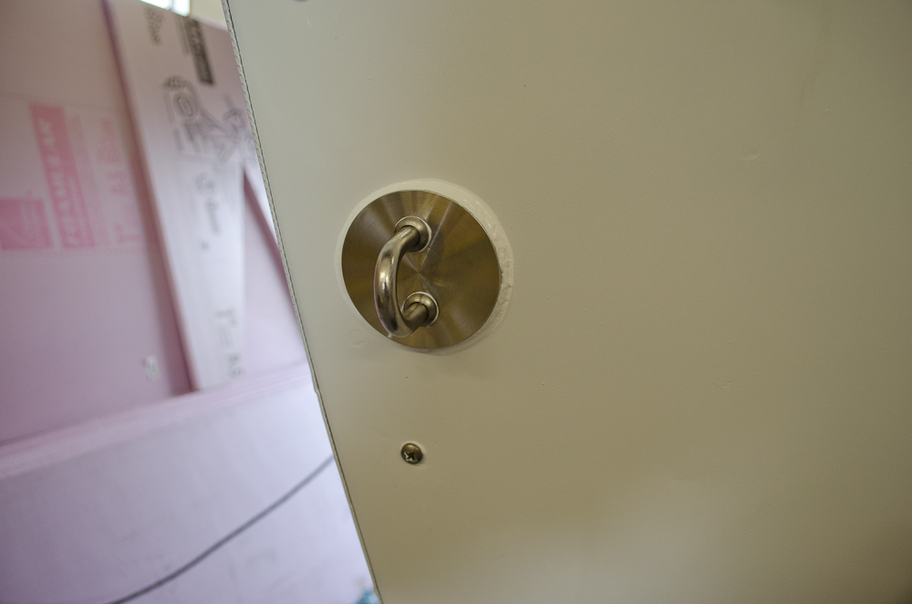

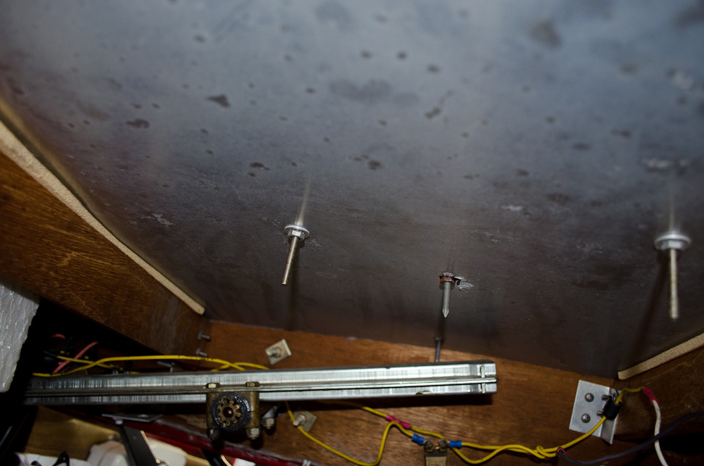

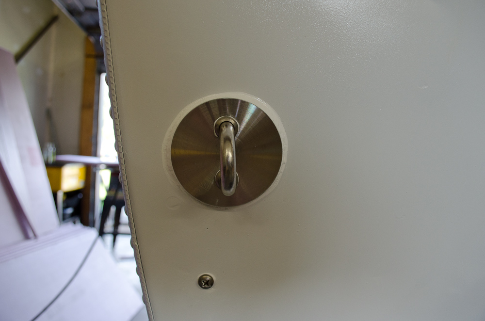

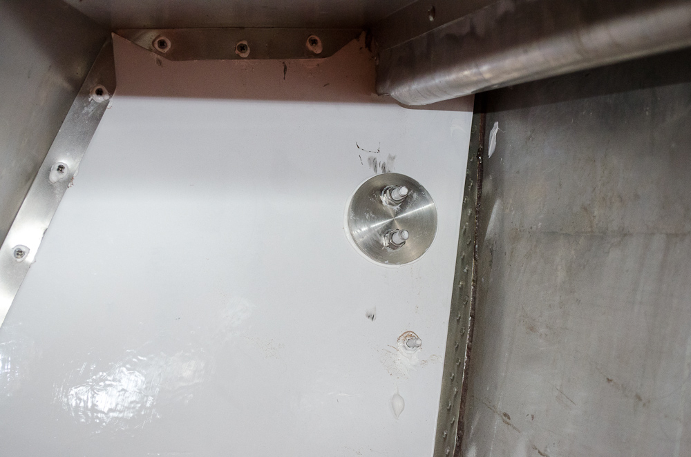

I'm glad you guys asked! Here are my tubing anchors, inspired by SigSaur. 3" x 1/4" stainless steel, bedded with 1520, and double nutted.

Also used one on the back of the bow eye.

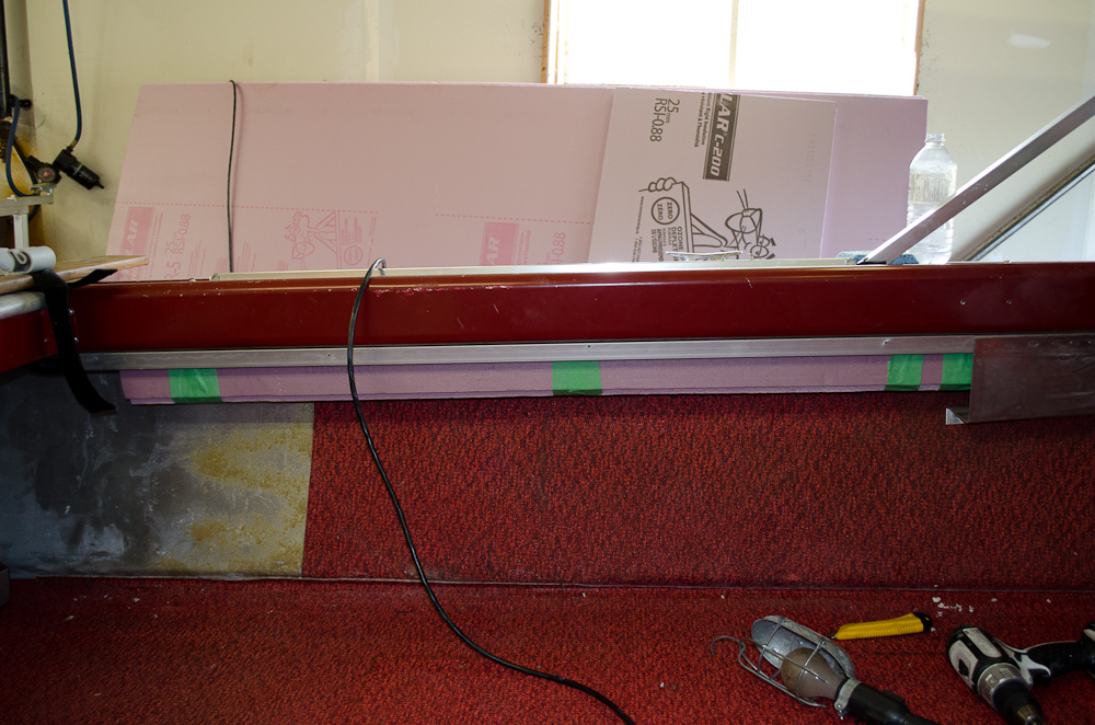

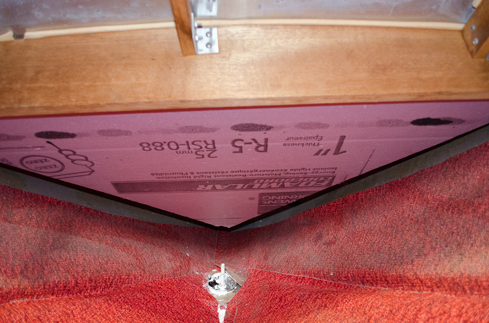

Foam going under the gunwales:
More foam in the bow:

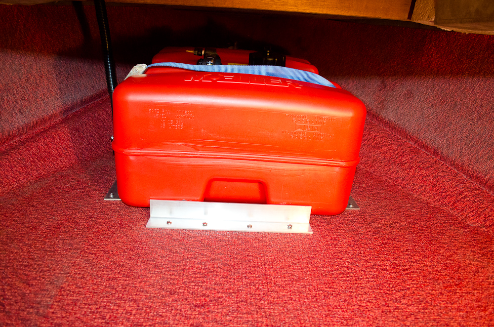

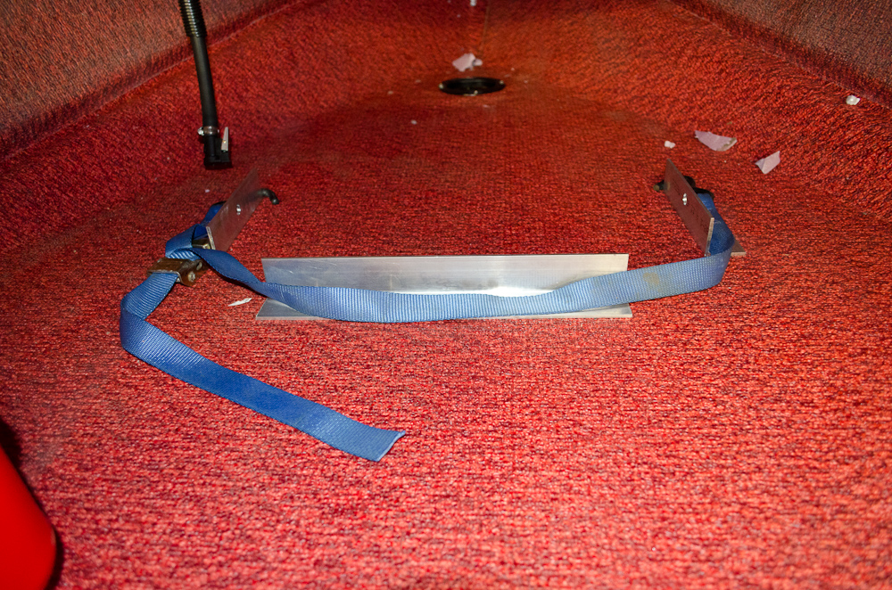

Hold-down for the bow gas tank: (just some aluminum angle and a cam buckle strap.)

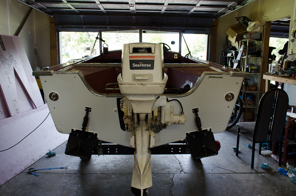

Here are the final pics and story

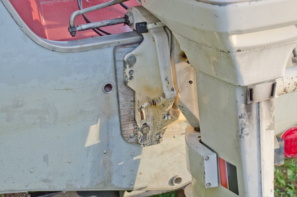

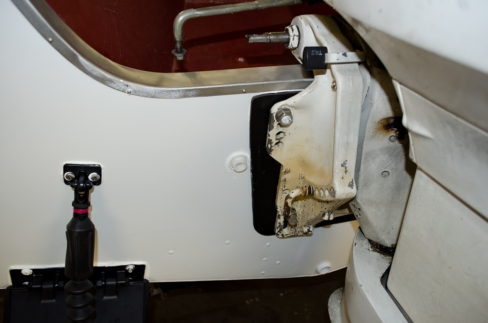

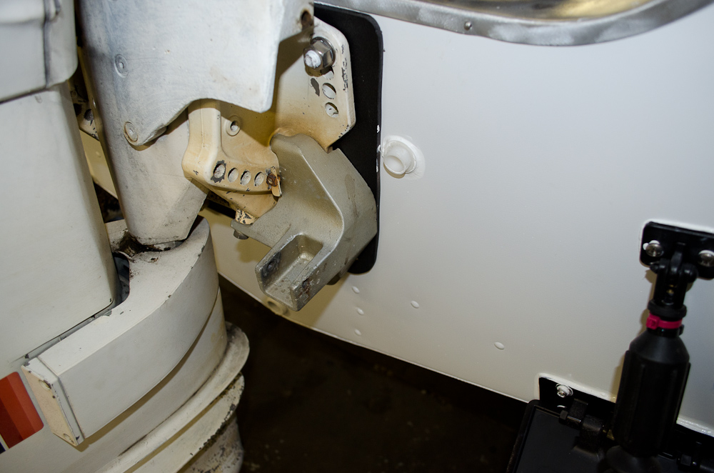

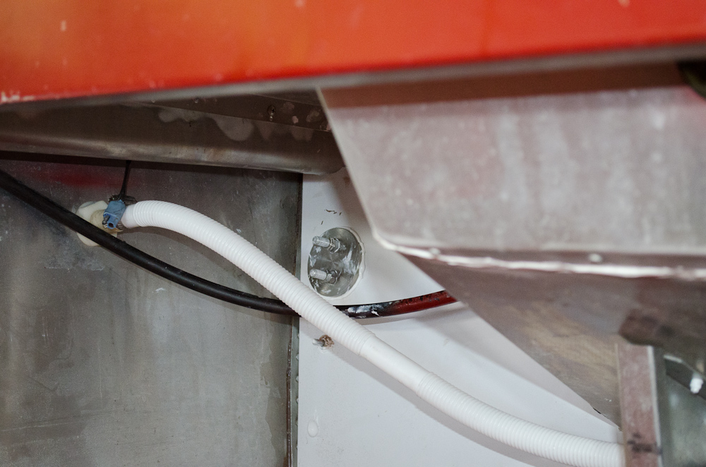

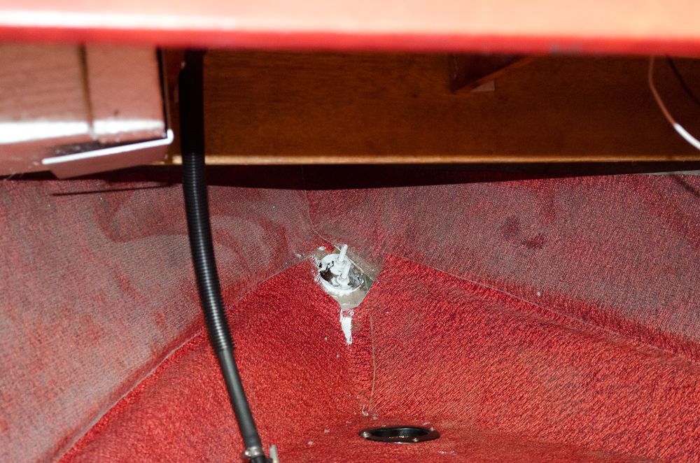

I used the little plastic drain tubes for the splashwell...primarily for speed and ease of installation (without having to build a little flaring tool). But I discovered an unexpected "feature" of this decision that I quite like.
Presumably you normally trim the tube to length...I didn't think of this and just installed them as-is. As you can see below, they protrude a little, but on reflection I think I like this...by standing off a little proud from the stern it should help avoid the streaking that can occur, as seen in the third pic:

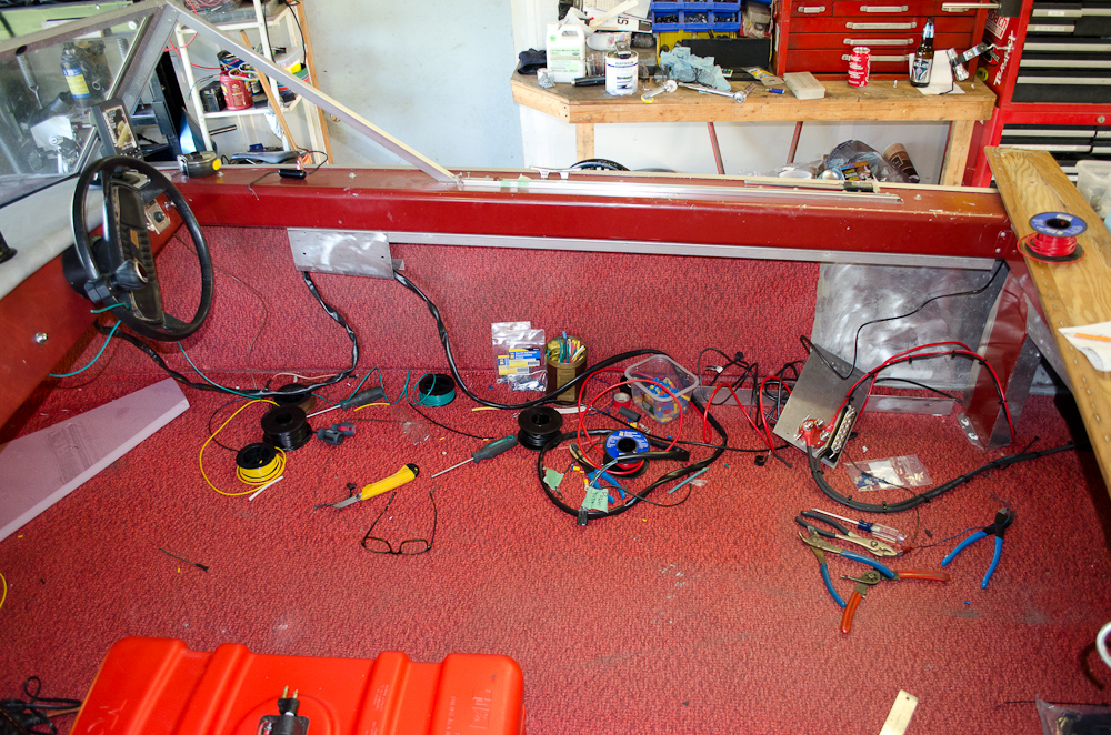

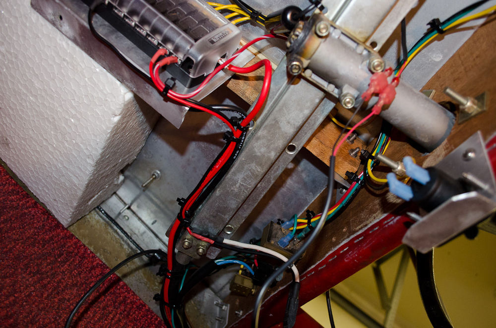

Most of Friday's Marathon was wiring. It's funny how you could do a half-*** job in 2 hours but a good job takes not 4 or 8 but 20!!!
But I hate bad wiring, so I decided to try and do a good job from the start.

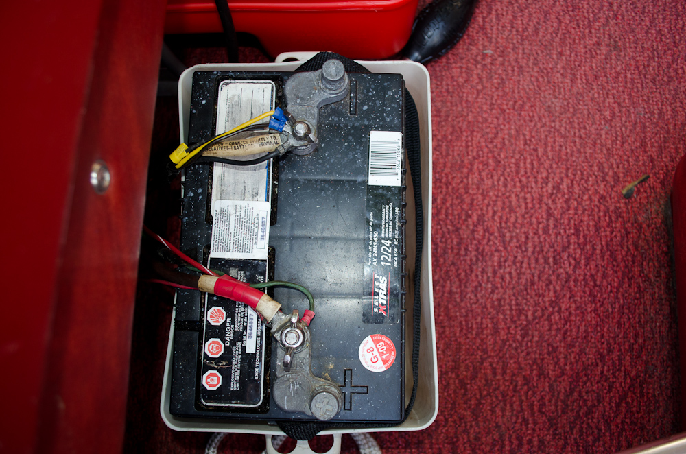

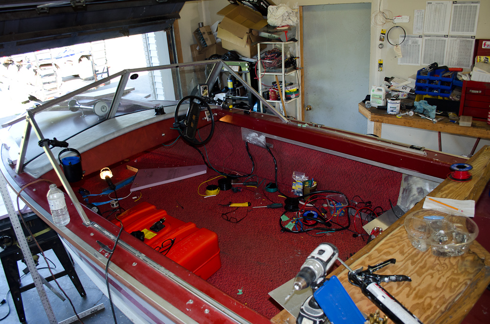

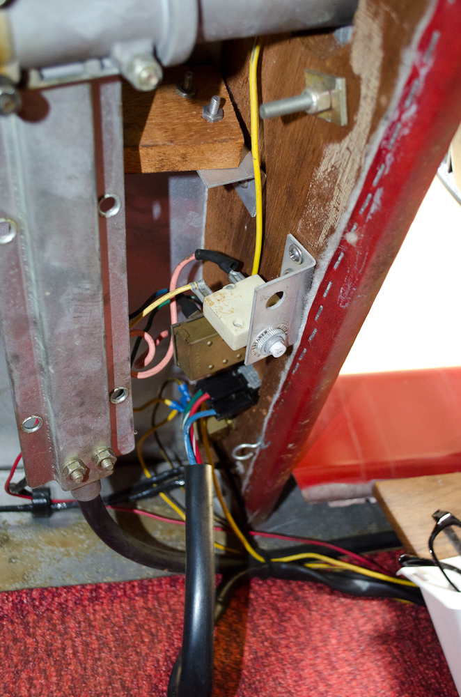

Remember, this is what I started with. A tangled mess of wires, almost no fuses, everything just ring-terminal'd straight to the battery (I hate that).

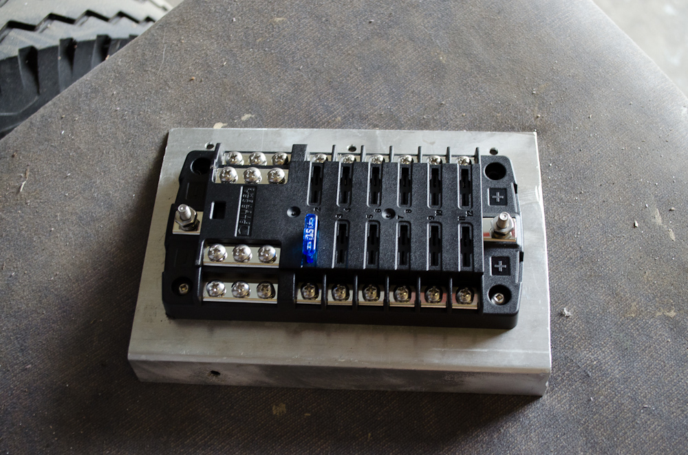

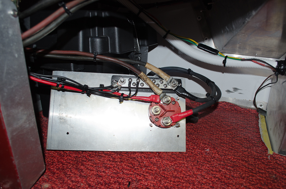

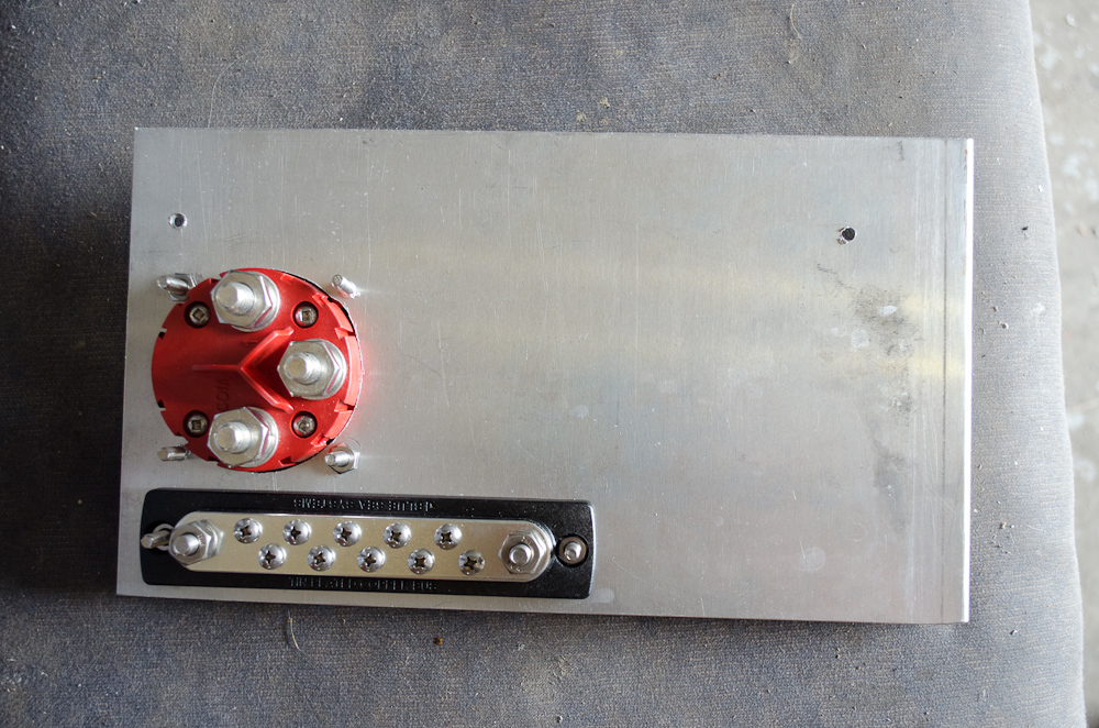

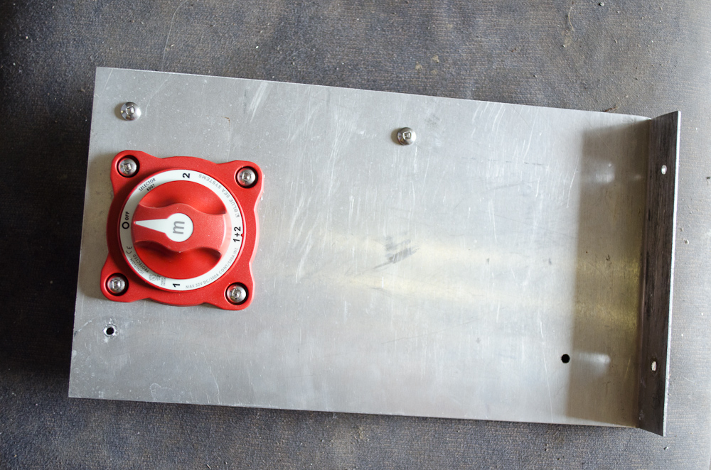

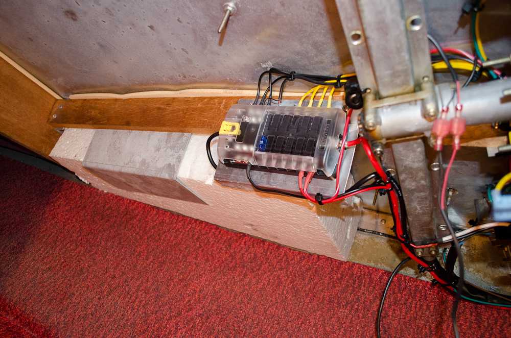

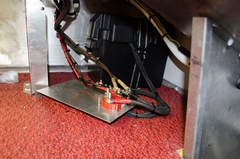

My plan was to install a 4-way battery switch in the stern, and a proper marine fuse panel under the dash. That along with neat wiring and the addition of a couple of extra circuits (GPS. fish finder, 12V accessory plug) form the basis of my new system.
On with the pics:

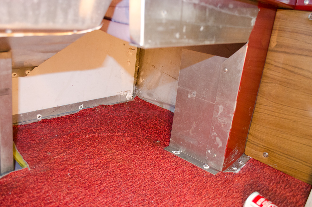

The battery switch and a ground (negative) bus bar were installed in the little panel under the splashwell. I cut that panel down a bit because I wanted the extra space behind it for the battery (and for a toolbox on the port side) and I didn't need to close it off and fill it with foam since I already have about 18 cu ft in the boat.

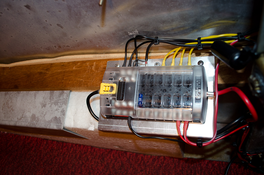

I made a small panel to mount the fuse box by using the cut-off from the under-the-splashwell panel.
Fuse panel being wired in:
Fuse panel location:

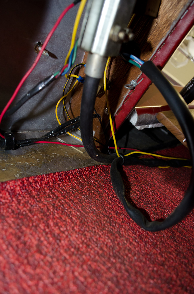

Wiring getting replaced and tidied up

You'd think I was wiring the space shuttle with all the stuff in the boat during the process!!

Re: Tore the transom ...how to repair? (pics)
Very nice progress!
I can certainly agree 100% with you when it comes to wiring...
Neat and organized wiring wiring is not only a pleasure to look at, but if the time ever comes that something needs troubleshooting, it becomes a simple matter of tracking down the problem systematically, as opposed to ripping whatever hair one has left on their head out...
IMHO, it is definitely worth the extra hours to know that it is done right and safe!
Way to go!:)

Couple of other random finishing pics:
Gas tank strapped down.
Here's the shortened under-the-splashwell panel on the port side, where my toolbox will go:
