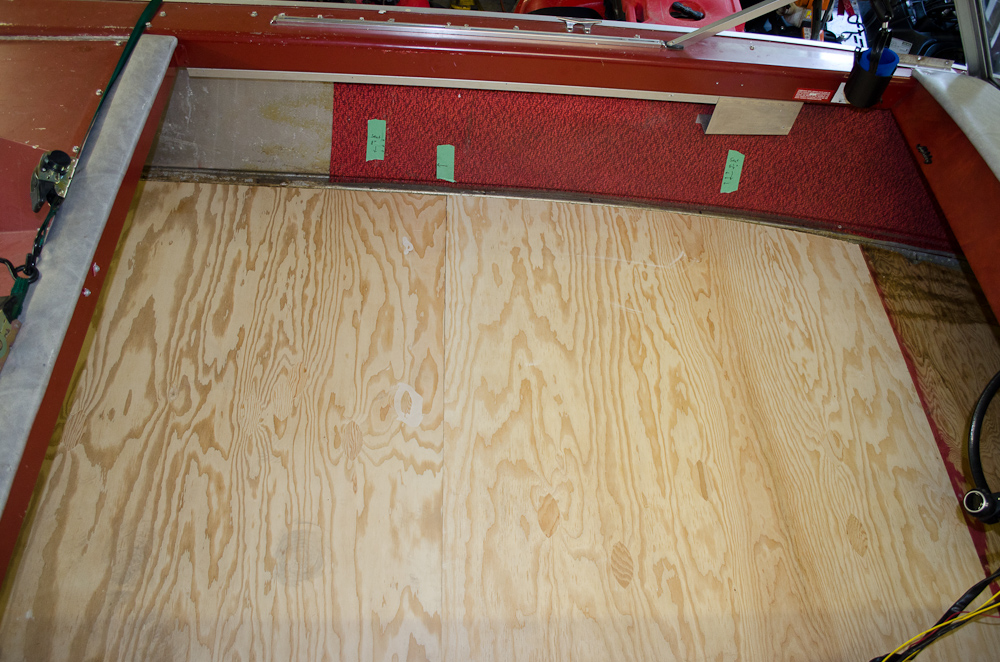

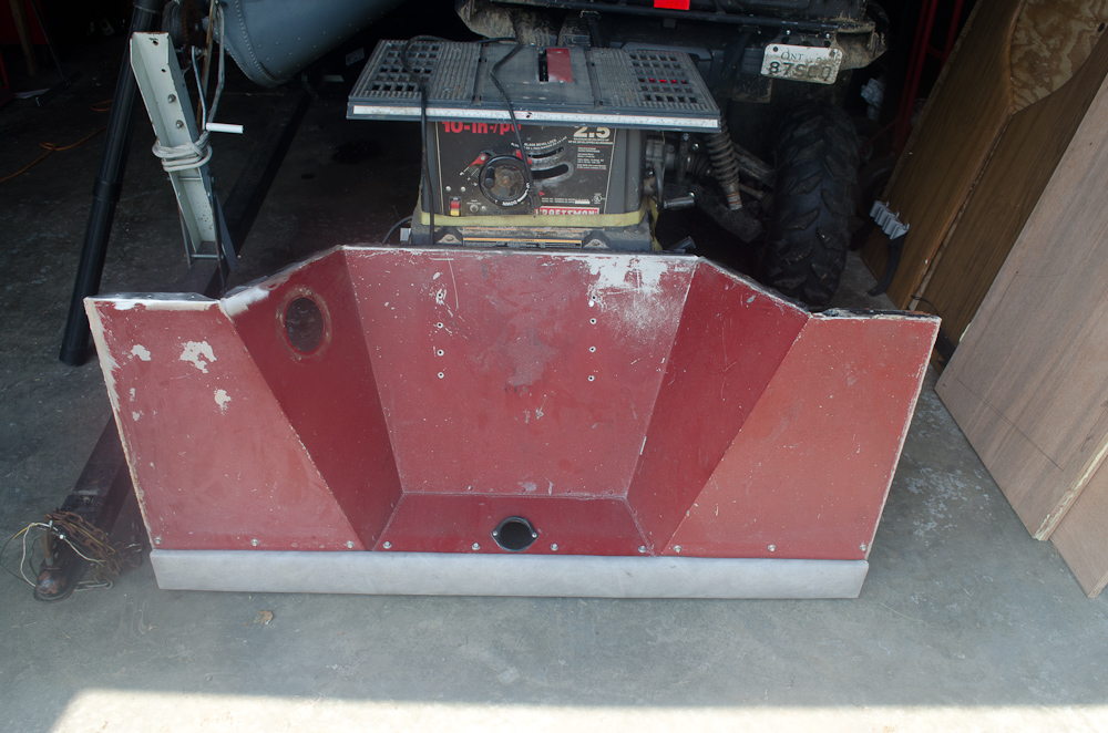

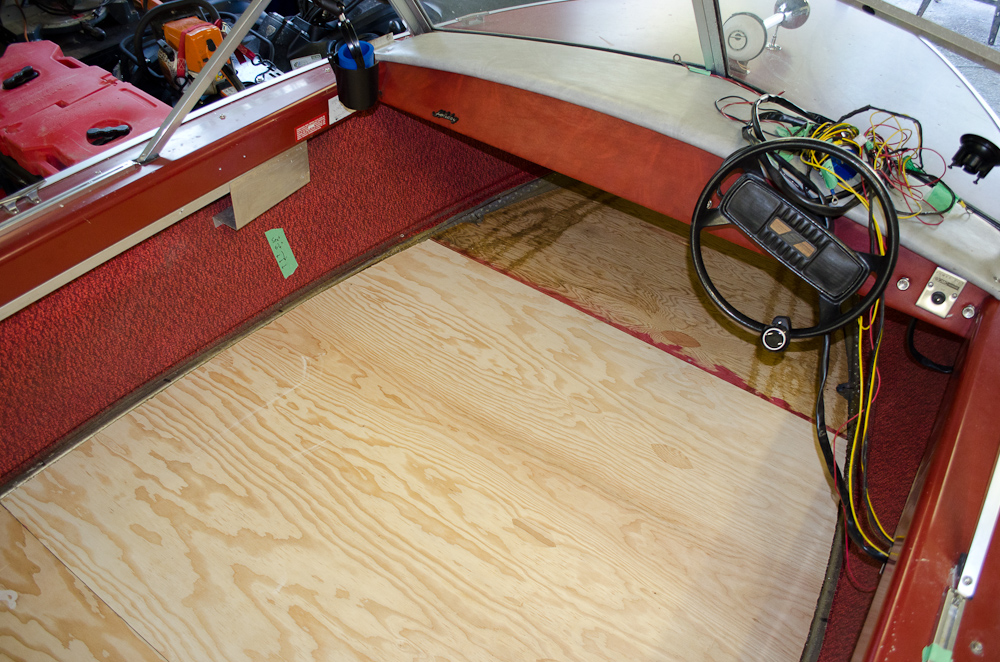

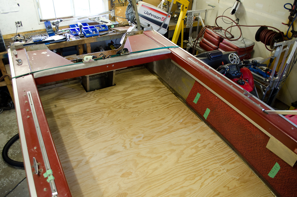

Some progress and a few pics tonight.

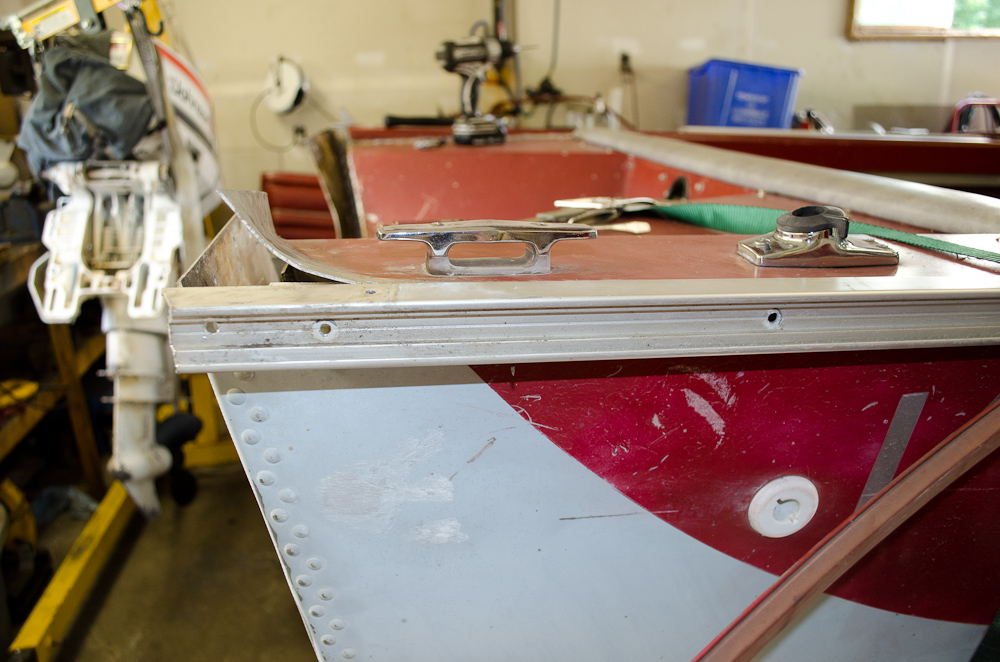

Got the rest of the transom out at last. Removed some hardware from the gunwale's and rub strip and bent up the aft-most portions of the gunwales to get it out.

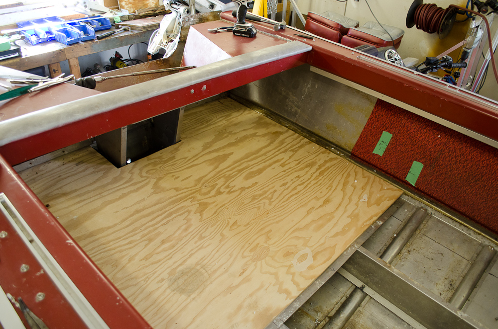

Also test-fit the new floor sections.
Have the two rough pieces cut for the transom. Am thinking the best way to proceed would be to glue the two pieces together to make one piece, then draw out the transom, and cut it out from the laminated piece.

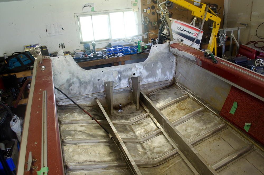

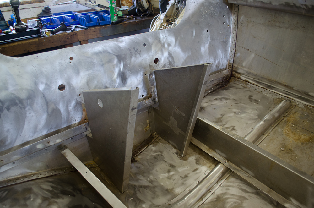

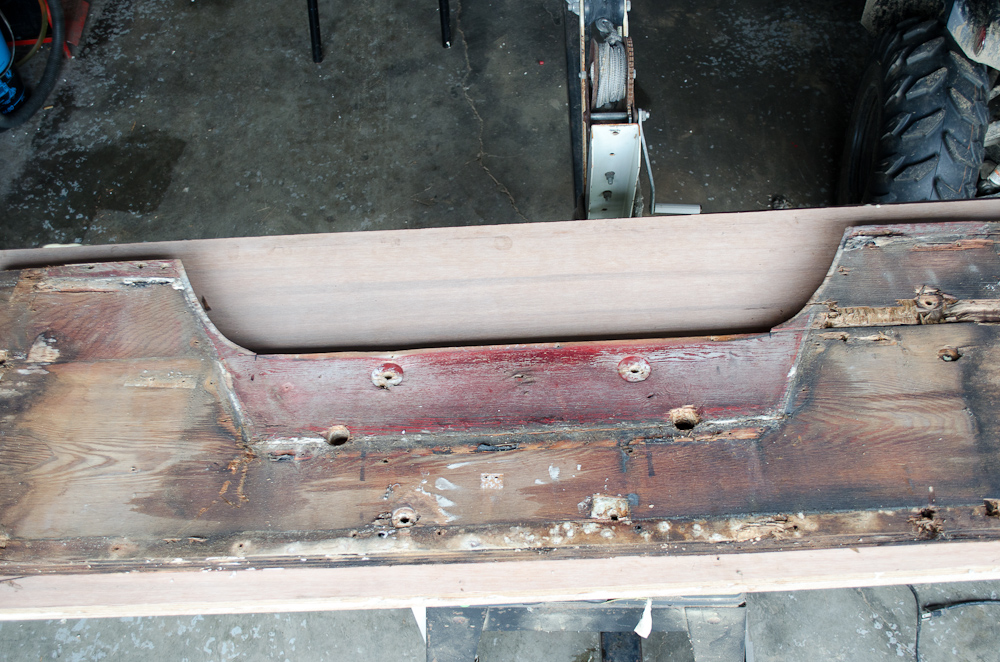

An interesting thing I noticed, If you look closely at the next 3 pics, you will see that the factory top pieces of the transom do not line up exactly with the lower piece - they are actually a bit wider.

There is a chance that the red sealant was a factory or dealer sealant. If the boat leaked while under warranty, it may have been serviced while the deck was still in great shape. Remove the original deck rivets, lift deck, add sealant & reinstall the deck. The deck would already have holes in it from the previous rivets, and if the rivets were all installed before being cinched, it make it easier to have them all hit the previous holes.
BarbK has a 'factory' refit of chine bracing w/ the exact same braces & placed exactly where they were put in on later years, probably in response to chine cracking:
Also a neighbor came and looked at my boat and said starcraft actually had a kit available for repairing this issue which he thinks has been done to my boat I don't know this for fact but sounds plausible anyone know any different
Thanks

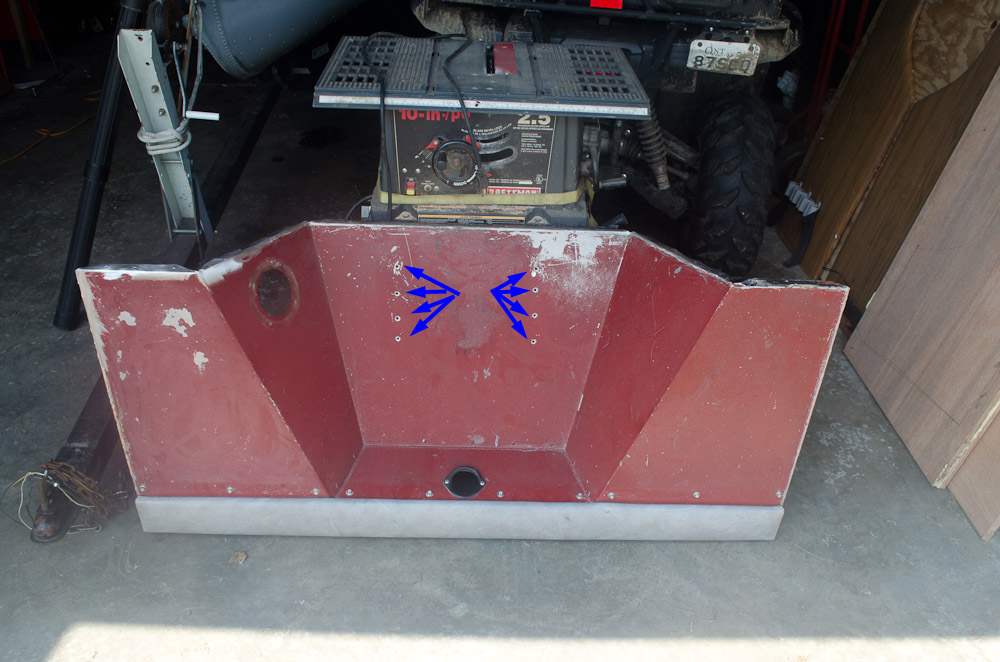

The first pic is of the chine you can see where they put rivets down threw from the top and up from the bottom they are staggered
The second pic if you look at the floor you can see the pieces they put across the chine right next to the seat
What ya think ???
Maybe?

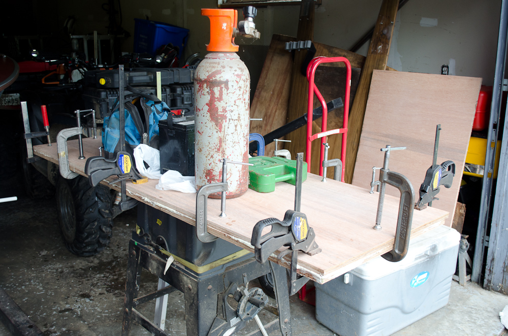

Tonight's meager progress was cutting, gluing, and clamping the two pieces of 3/4" marine plywood together, from which the new transom will be cut:

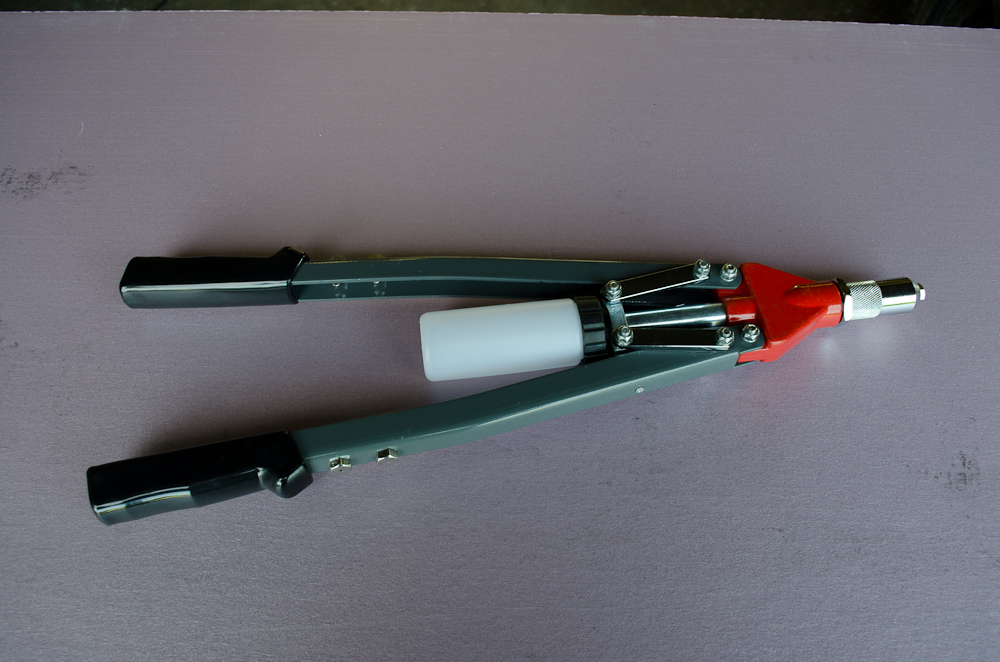

Other than that, I got some supplies:
(not terribly interesting to you vets, I know, but in case there are ever any other rookies reading this...)
As a start on the foam, I got six 2' x 8' x 1" panels of C200 extruded polystyrene insulating from Home Depot. I will probably need twice that when all is said and done. Here it is stacked with each board cut into two (so it would fit in the car!)
Some plastic loom to cover wiring and fuel hose (not in the same loom , of course)
Some new bilge pump discharge hose
3M 5200 and 4200 sealant / adhesives. These will be used on the splashwell seams, and any other seams in / around the transom after it goes back in. May also be used on any replacement rivets required, and will certainly be used on any/all screws or bolts that pass through the transom. I''m thinking probably 5200 for all those tasks.
The obligatory Gluvit fro seams and rivet sealing from the inside before the floor goes back.

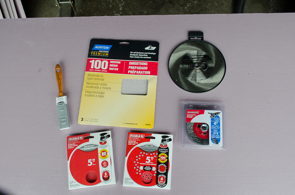

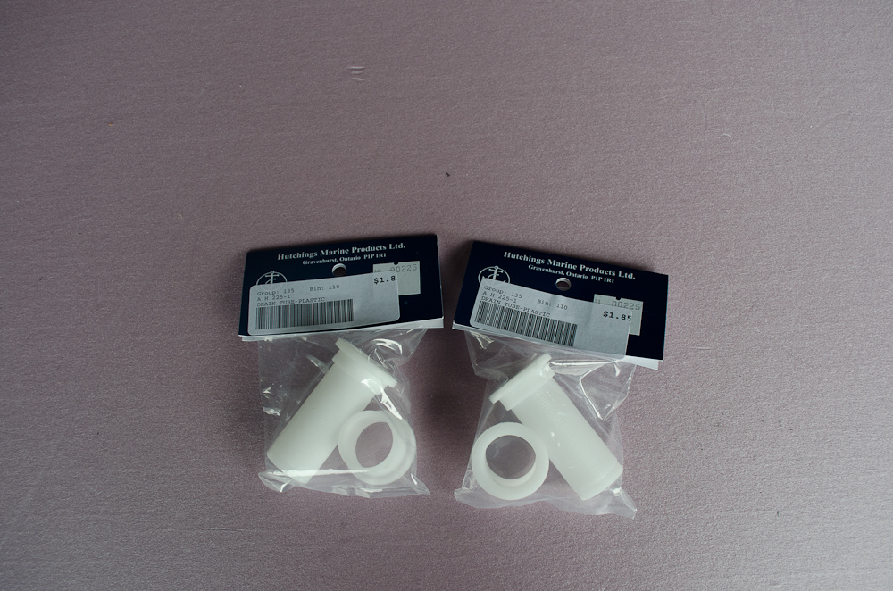

A couple of drain tubes to go from splashwell through the transom
Some electrical goodies. Yes, probably overkill for this little boat, but I HATE crappy wiring and I really dislike thumb screws on batteries and disconnecting things by taking ring terminals off battery posts. Plus I always go overboard on two things - wiring and plumbing (from my offroad racing days), simply because those are the two things most likely to cause your rig (or boat) to burn and I've seen way too many do just that.
3M spray adhesive for the carpet/vinyl re-install. Acetone to clean the inside for the Gluvit, and Gorilla Glue to glue the ply together for the new transom. I was going to go with LP Premium construction adhesive but noticed it was "water resistant" wheras the Gorill is "100% waterproof".
Paintbrush to apply the Gluvit, sandpaper to prep for the Gluvit, plywwod blade for circular saw to cutout new transom, wire wheel to clean the inside of the hull and the splashwell flanges and the aluminum transom skin where holes need to be patched, and some orbital sanding discs to clean up the floor (especially the bow section which I am reusing) before the epoxy Resin goes on.
JB weld...for filling holes that no longer need to be holes.

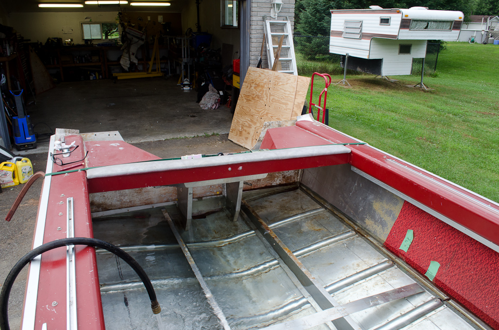

The two 3/4 plywood pieces seemed to have bonded well. I set the old transom in place and traced around it...just have to drum up the courage to dive in and make the cuts now...will be using a circular saw for the straight cuts and a jigsaw (hateful tool!) for the curves.

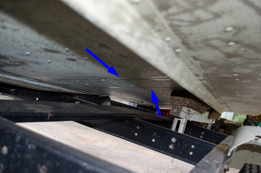

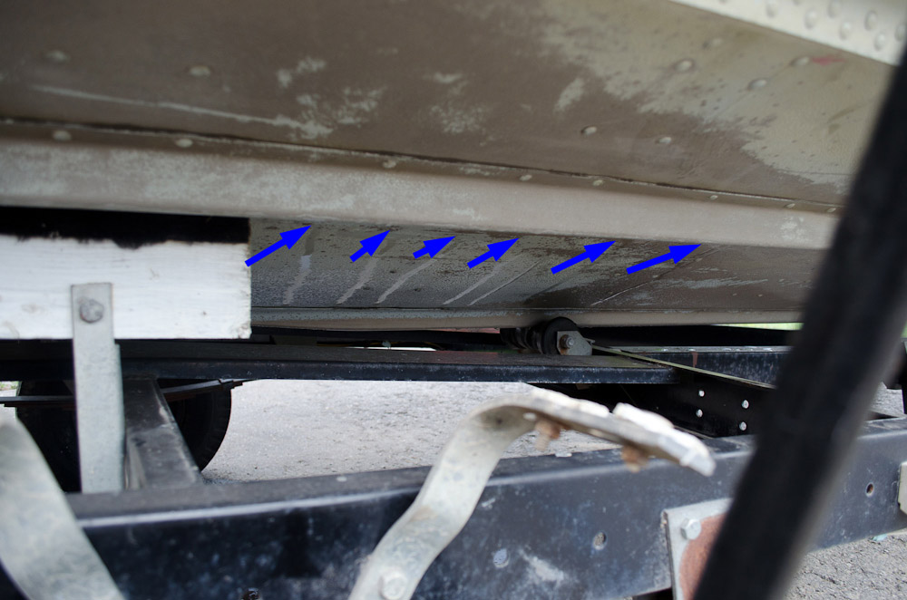

Then I decided to dive in and do the leak test
Feels very strange filling the boat with water!
As leaks appeared, I marked their point of origin with a grease pencil. Because it is so hot and humid, a lot of condensation formed very quickly on the hull, but the leaks cut nice clear rivulets as you can see in the picture:

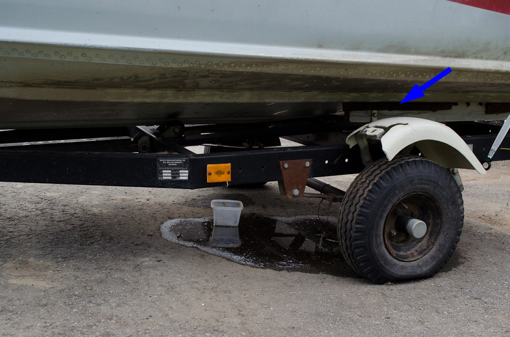

I have one fairly major leak, but unfortunately it is in an area right above the trailer bunk so I couldn't pinpoint the source.
Which brings me to a concern. In this case (the area above the bunk that is leaking most) and in other cases (see next pic) the water was running down not from a single clearly identifiable rivet, but from the seam of the stiffening rib on the outside - sometimes near a rivet, sometimes between a rivet.
Which means I can't tell where the actual leak is. Now, I plan to replace and obviously defective rivets (and their are a few of those)...but what of the rivets that appear fine but are in the vicinity of leaking by the seam? I don't plan to re-buck any rivets as I have no experience and therefore no ability to know if I have done it enough or achieved anything. As I said, defective and visibly suspect rivets will get replaced...but I don't know what to do with the ones that look fine?
Here's a pic of multiple leaks coming from a seam:
I guess I can replace bad rivets, Gluvit all from inside and hope for the best - unless anyone has any other ideas? I'm just leery of removing what may be good rivets. In fact, I'm wetting myself just thinking of grinding and drilling on the actual hull.
I have two additional questions / concerns:

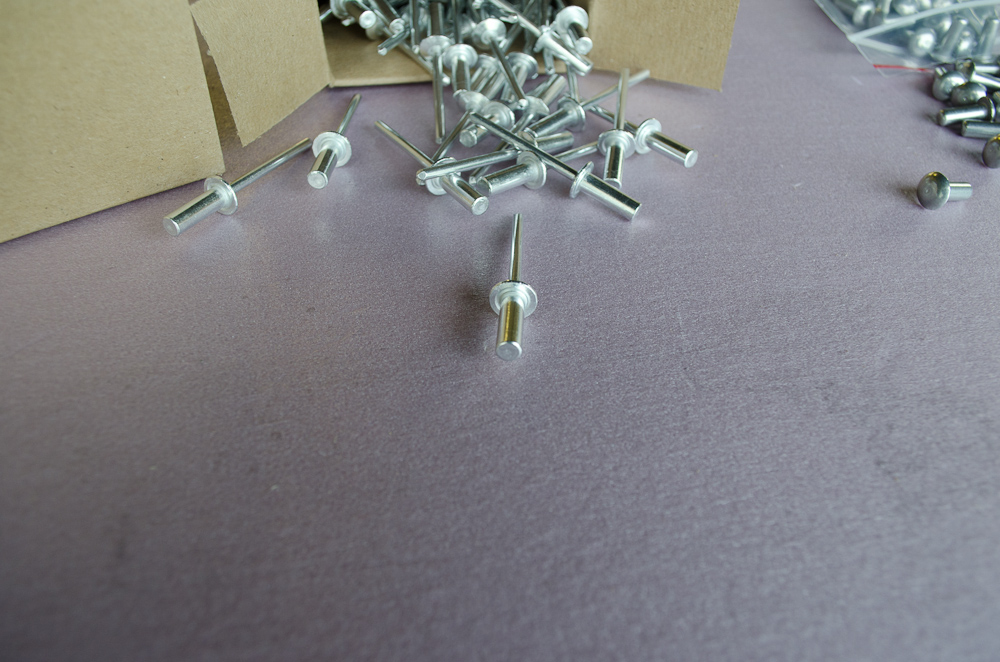

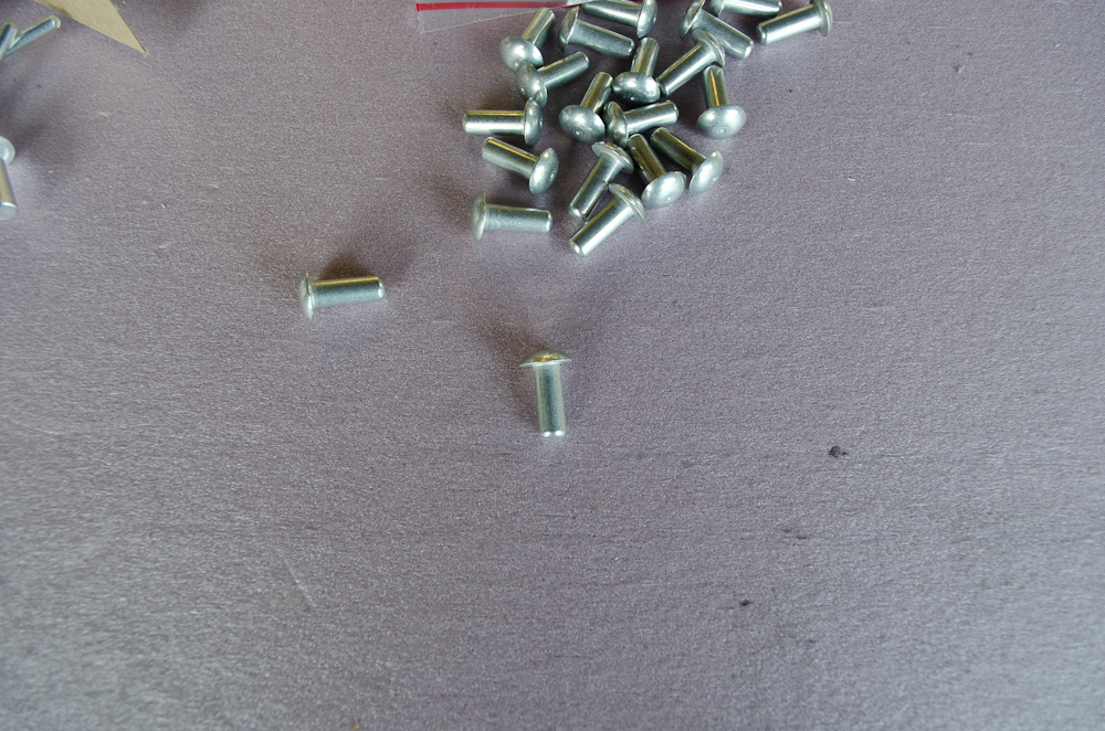

It seems that solid rivets are more proper, but might be harder to do? Either way, I plan to coat them with a panel bonding epoxy (an aluminum cold weld product designed for "gluing" aluminum semi-trailer bodies together instead of welding or riveting. Amazing product, have used it before to repair a camper roof. You can "glue" 2 sheets of aluminum together and you cannot beat them apart with a sledge - the aluminum itself fails before the bond).
So - do I suck it up and do the solid for through-hull rivets? I'd be using an air hammer with a chisel attachment cut off to make a home-made rivet set and a sledgehammer head inside for the bucking bar. Or should I just use the enclosed head blind rivets and a long-arm rivet gun as it may be easier and produce better results?
Any tricks to removing solid rivets without grinding or drilling the hull inadvertently? Grind or drill? From the inside or outside?
One last question. Should I absolutely peel off, wire brush away that old factory reddish-brown sealant at the bow and stern? I'm such a chicken and fear making things worse.!

My line of thinking is use solid rivets for anything through hull that is structural, unless you only have a couple to do. Fastenal can supply you with the proper bit for you air chisel. Center punch then drill them out is about the only way to remove them, I have found grinding them only take the flattened part off and they are still tight in the aluminum.
Remove as much of that loose factory sealant as you can, if it's like any of the others I've seen once you get under a pair of pliers will pull it out easy.

OK Glen, that's what I'll do.
I found this excellent video on Youtube that has given me a bit more confidence.
Aircraft Flush Riveting, RV Builder Basics - YouTube
I'm going to drill some scrap aluminum and practice a few before attacking the hull.

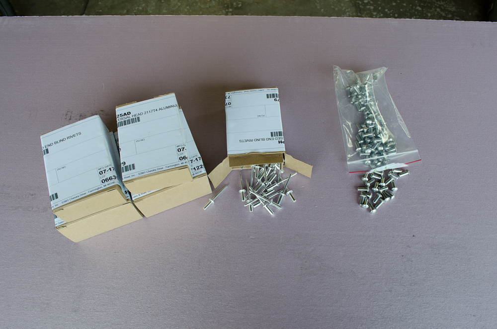

Took today off and have just started on the inside hull with the wire-wheel. Popped in for an airconditioning break - it must be 45* in the shop already!
Rivets and Epoxy should be arriving this afternoon. Gonna be a busy weekend! Should be well on the way by the end though!
Ultimately I don't expect a 35 year old boat to be completely dry but I might as well do all I can while I'm at it.

Gotcha. I've read that a few times too. I think that's probably at least in part because it's cheap, easy to work with, and everybody already has it for other jobs too (like caulking splashwell seams and bedding gunwale and transom fittings). And I'm sure it works fine for sealing rivets. But I just happen to have some of the Evercoat left from a camper aluminum roof repair and having worked with it I am very confident in it. It's expensive, and I prob. wouldn't buy it specially, but since I have it already and it's an excellent epoxy as strong as a weld I 'm going to try it.
Additionally, I am having some trouble drilling rivets out completely straight (the bit wanders in the soft aluminum of the rivet head) and the result is like this:
So in cases like this, since you could actually build the entire boat without using rivets and just using the Evercoat to bond the parts, I think it will be great for filling in any gaps around the rivets if there are any.

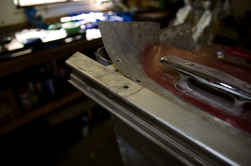

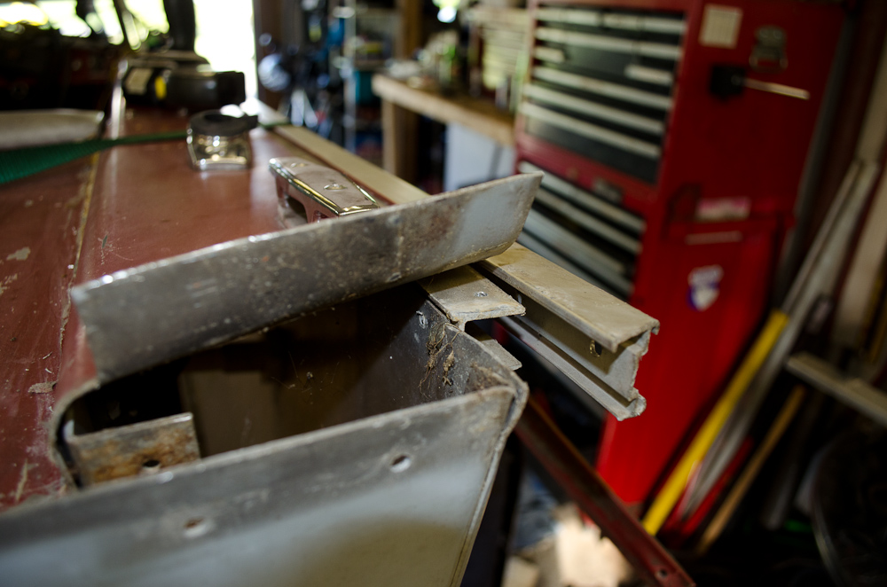

Made some pretty good progress today.

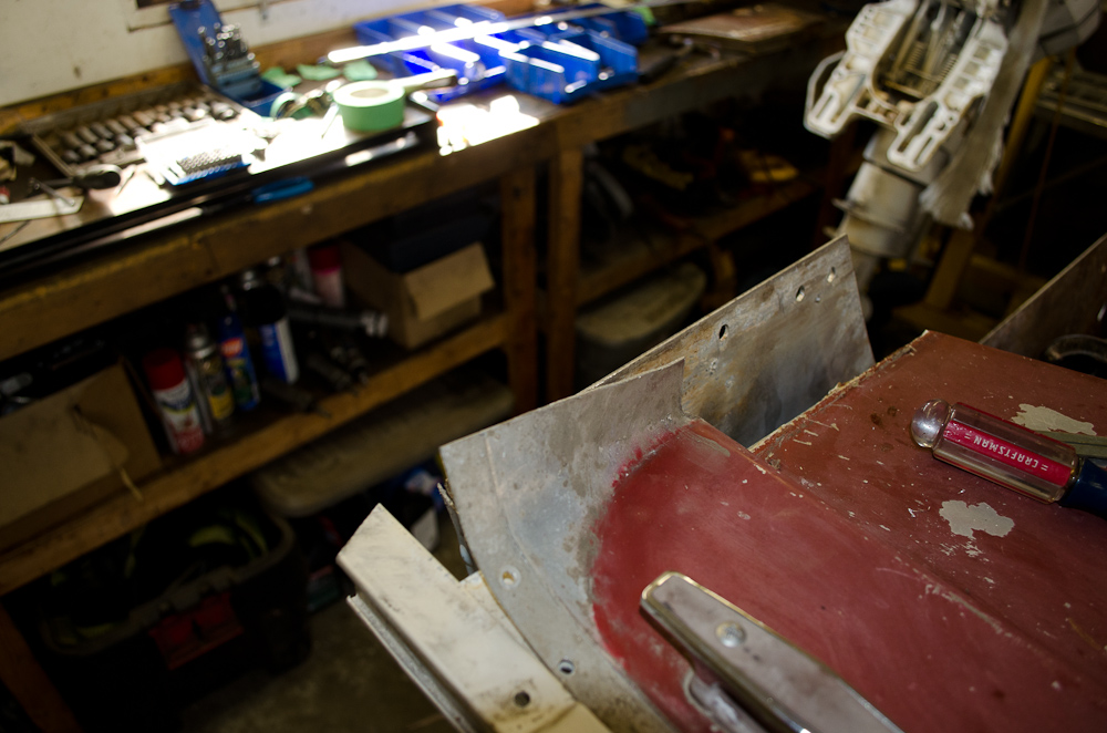

First, I said "to heck with it!" and decided to remove the splashwell. I just couldn't get the parts cleaned up to my satisfaction with it in the way.
It also helped me practice drilling out solid rivets (and discovered that I'm not very good at it, or my drill bits suck). The centre punch helps start straight, but the bit wanders easily in the soft aluminum. Only plus is you can sometimes walk it back in the soft aluminum.)
Anyhew...the splashwell comes out with these 8 rivets:
and these 4 (2 on each side):

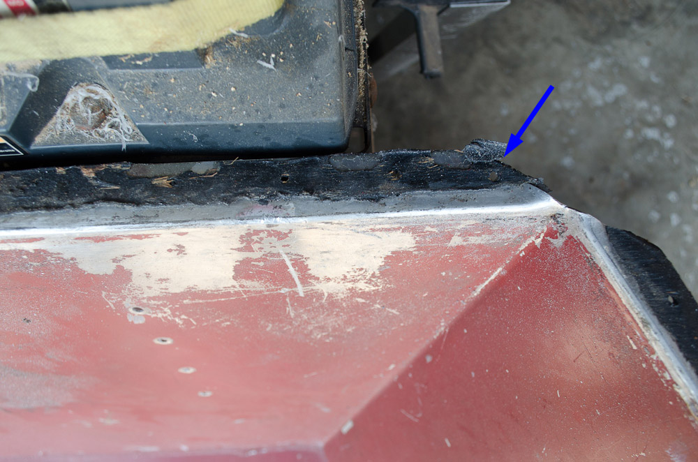

With it out, it's a lot easier to remove this awful tar-like sealant that was on the flanges:
But with it out, the wire wheel on the grinder makes short work of it

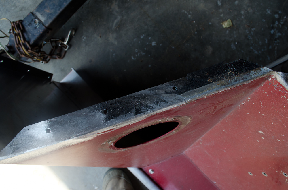

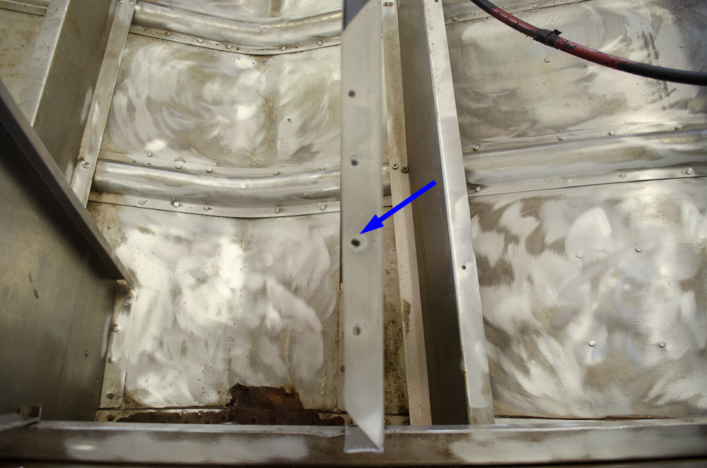

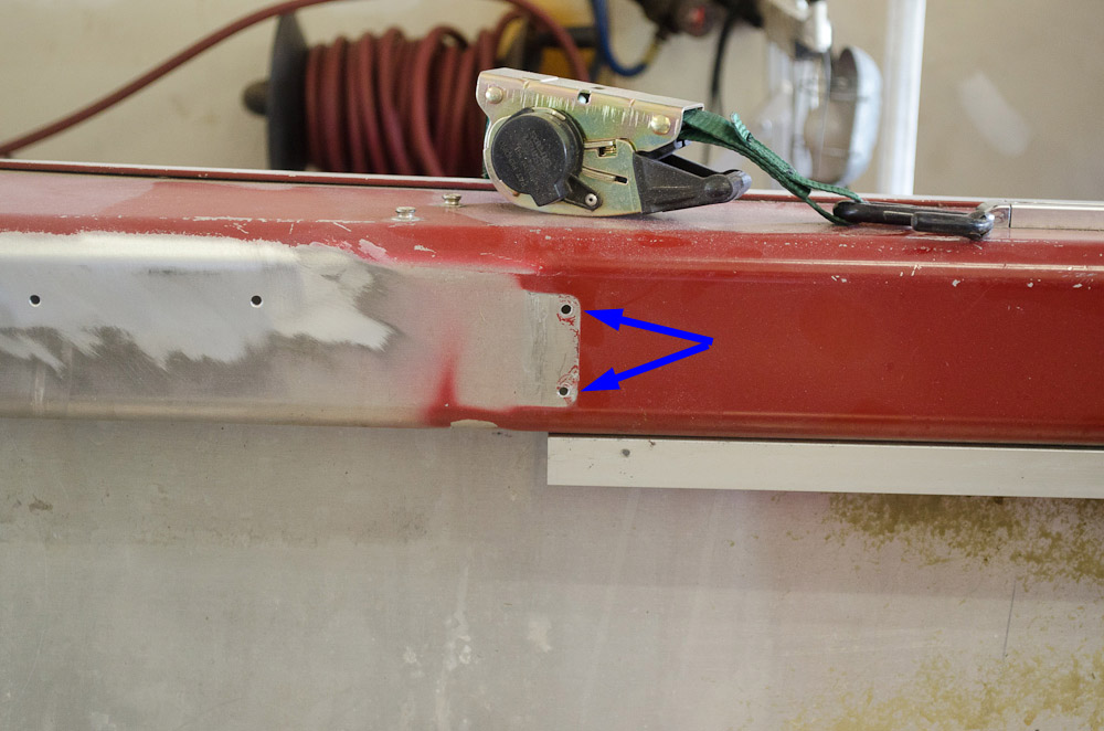

So I was able to more easily clean up the inside of the aluminum transom skin, in prep for sealing all these extraneous holes:
Spent the rest of the day in the boat with the wire wheel cleaning up rivets and seams in prep. for Gluvit. Pretty hateful job in 45* heat. Won't be in a rush to do that again! Here's a pic of the job in progress.

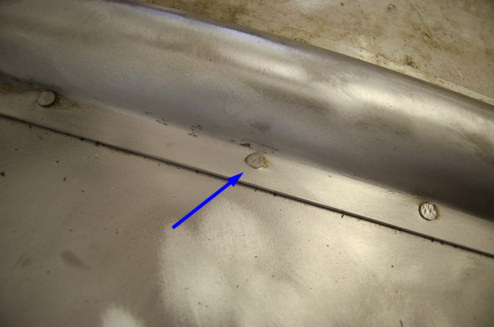

With things all cleaned up, you can get a lot better look at the tails of the rivets.
Question: There are a few rivets like the following one, where the tail is nearly down to the skin. I'm thinking these should be replaced on spec, even if they didn't show up as leakers. What do you think?

Some more supply shopping over the weekend:
Rivet Gun
Lotsa Rivets from the Jay Cee Rivet Company
Solid Rivets (3/16 x 1/2")
Closed-end blind rivets:
Epoxy-Plus for the deck and transom from Clark Craft:
Stuff from Lowes to get the epoxy on the wood:
