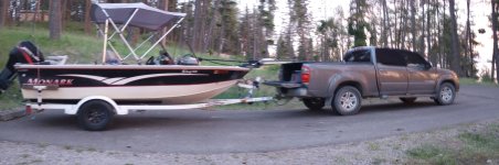

There is nothing near me. lol. I'm in pretty rural Montana. Hence why I was going 80mph. 😆 But your concerns are valid.
I have an email in with a couple companies to check pricing.
I'm not sure what weight the axle is rated at. The trailer itself is 400lbs. The boat is about 1000. and the motor I think is 300. It's not that big.
