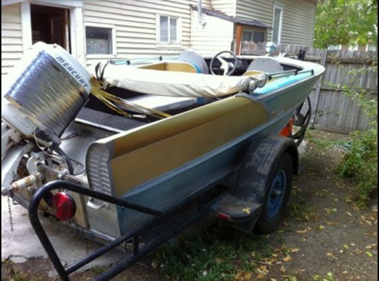

So I have recently completed a trailer restoration (see photos below - had holes to restored
) - something I found help through this and other forums and hope I can pass on the learning. These are just my findings and suggestions from someone who spent far too long restoring a trailer in far too bad condition!
