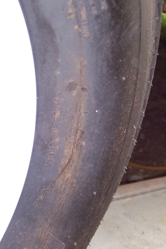

I do notice that Cooper offers a very bare bones selection in tires, they don't offer any 13" and they don't seem to offer any heavier load range D tires. I have a good local dealer here and they can only offer me Chinese made tires in my sizes. I have a pair of bias ply Nanco tires that I just got that have a 1230 lb rating and are only A78-13 ST sized tires. They are marked Load range C and are bias ply tires. They made that trailer track and ride like when it was new, it was terrible with a set of Tow master Radials I had on it. I went with these since I both needed to lower the trailer a bit and didn't need any real weight capacity, they didn't have the lighter version of these so I went with the heavier rating for the same price.
They have about 500 miles on them now, I used the trailer to pickup a few boats out of state since it's all just been overhauled with new springs, tires, rims, bearings and lights.
The rims shown are brand new galvanized trailer rims from Load Rite.
I'm also a bit more comfortable running off road with bias ply tires as that they have a tougher sidewall that's less susceptible to punctures.
