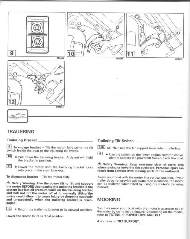

Re: Trailering motor in the up position
If you've got one of these, it's a no brainer. I've towed my boat over 50,000 miles this way...
