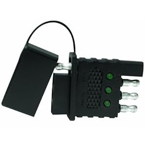

Atwood makes an inline light tester to help figure this out:
