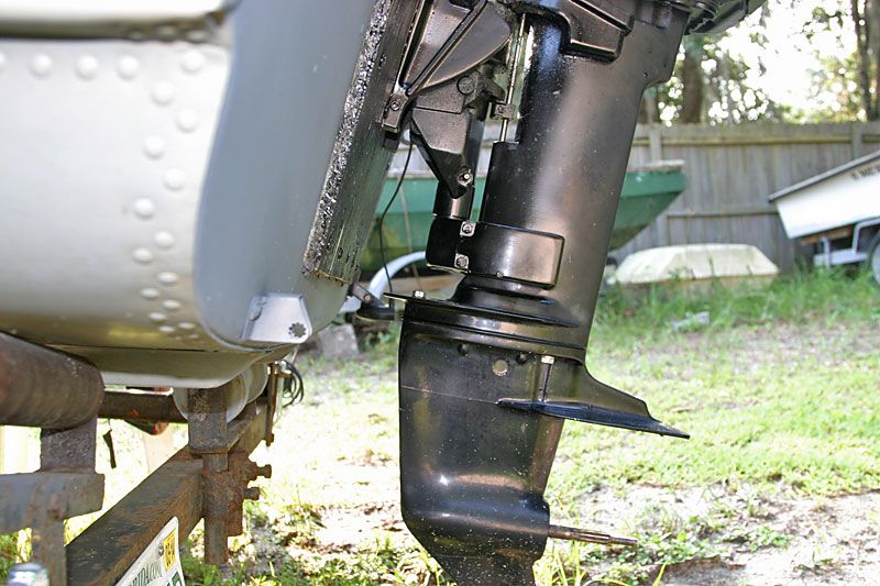

Hello all. I've done a search, and read a lot (great site!) and I have a question. I have an old 14' aluminum that I hung a 1996/9.9 Mercury 2-stroke on. I injured my back and have to upgrade to an electric start motor ? (I'm looking at a 15 HP Yammy 4-stroke). I'm a bit confused about transom height, though.
The boat transom appears to be 16?. The shaft on the 9.9 is 18?. The new Yammy comes in 15? (short) and 20? (Long). Assuming that I need the longer shaft, will I need to shim the top of the transom to bring the plate/prop to where they should be, or will racking the motor out work? I've posted a couple of pics of the current setup.

I don't know what you mean by "racking the motor out".
When it's said that a boat has a certain size transom that's referring to the vertical measurement from the top of the transom to the bottom of the boat when the boat is sitting level (not the measurement of the transom itself - remember your Pythagorean Theorem), so it sounds like your boat has a 15 inch transom.
And from that photo it looks like the engine is sitting lower than it needs to be.

Thanks for the responses. So, I should be OK with the short shaft 15 (15") motor, right?

It is WAY easier to raise the engine than to cut the transom! If you are buying from a dealer, let him test fit both size engines for you then buy the one that fits best. Otherwise, I would go with the long shaft and raise the transom a bit. It is not a difficult job and there are numerous posts on the forum about people who have done just that.
