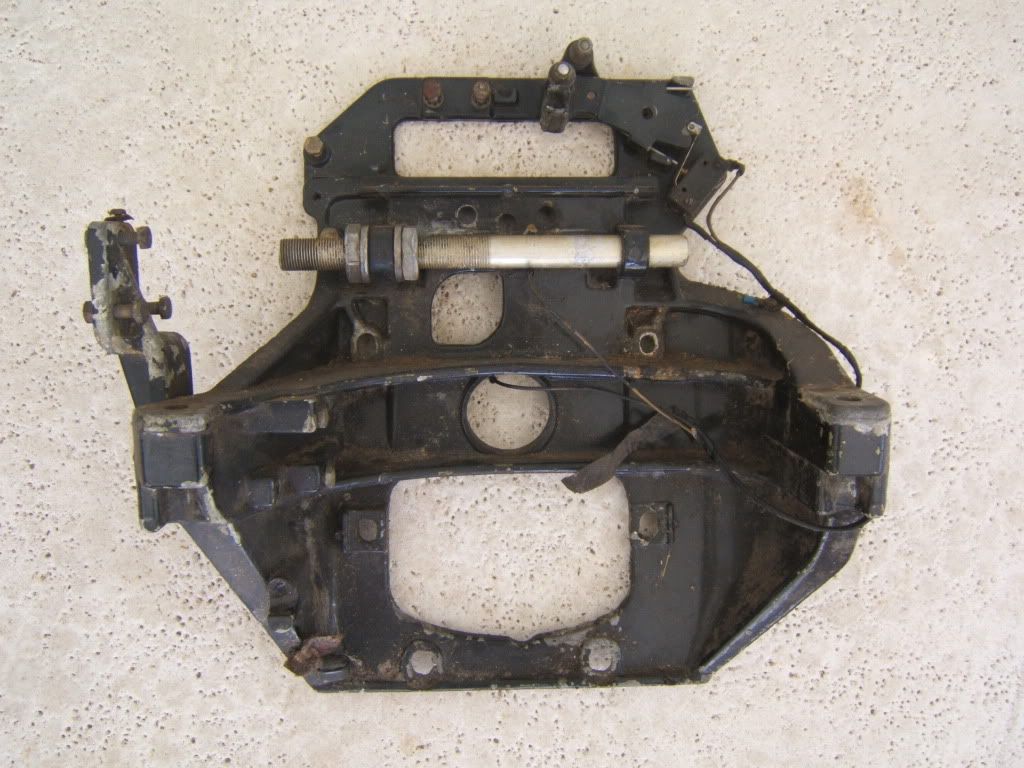

I know there are six around the perimeter and go through the cork gasket, but if I am not mistaken, there are two more above where the steering tube is.
I removed and installed the transom assembly from my dad's old 70's vintage SeaRay a few years ago.
Here's a pic of the inner plate - note the two stainless bolt heads above the steering tube? I believe those bolt into the outer transom assembly: (But it's been long enough now that I could be wrong!)
Here's a couple of pics I took after removing the inner plate:
Either way - it looks like the original poster has removed all the bolts. If you will look at the back of the plate - you will see quite a bit of corrosion where the bolts went through. My best guess is that is where things are binding.
