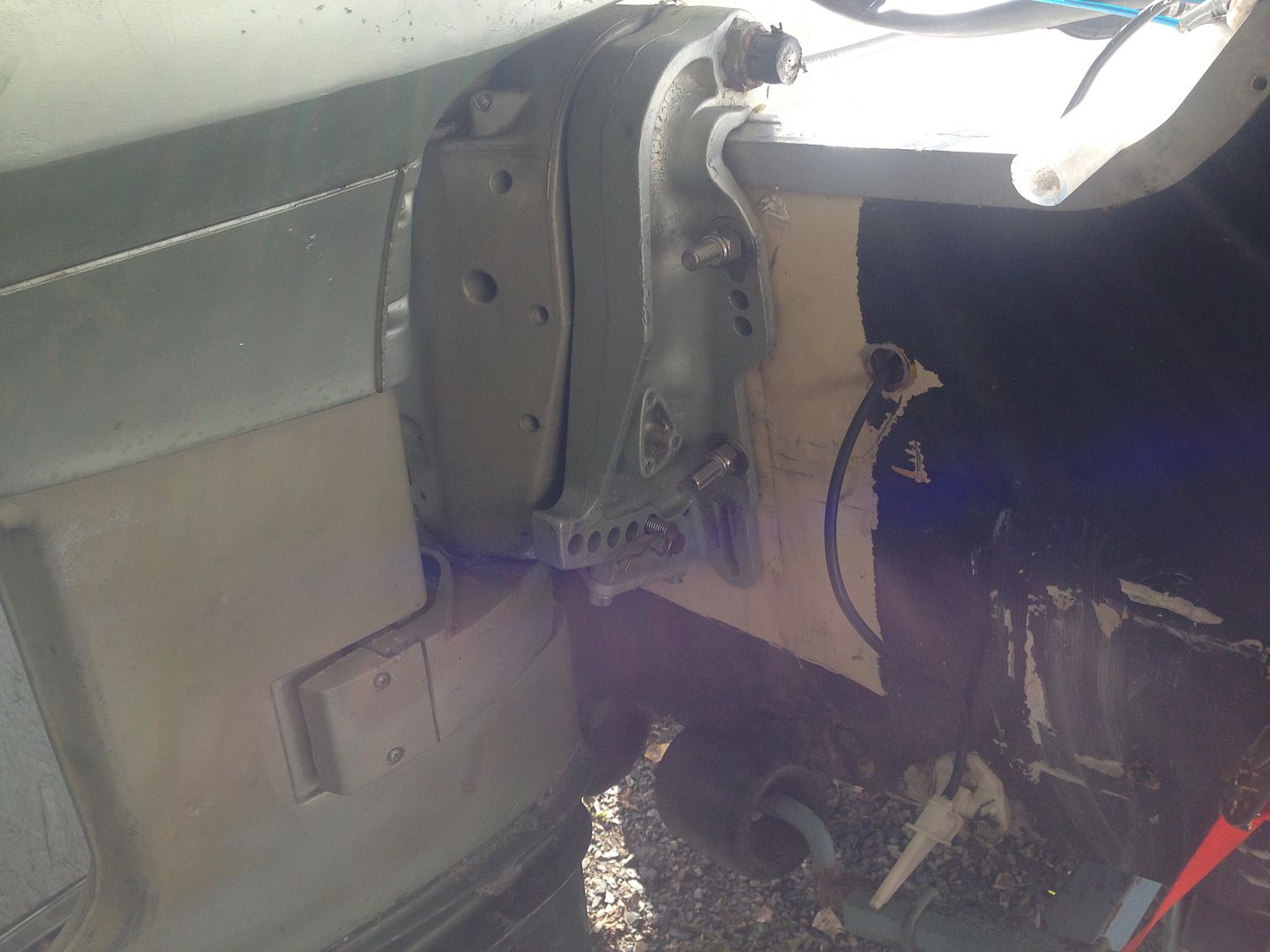

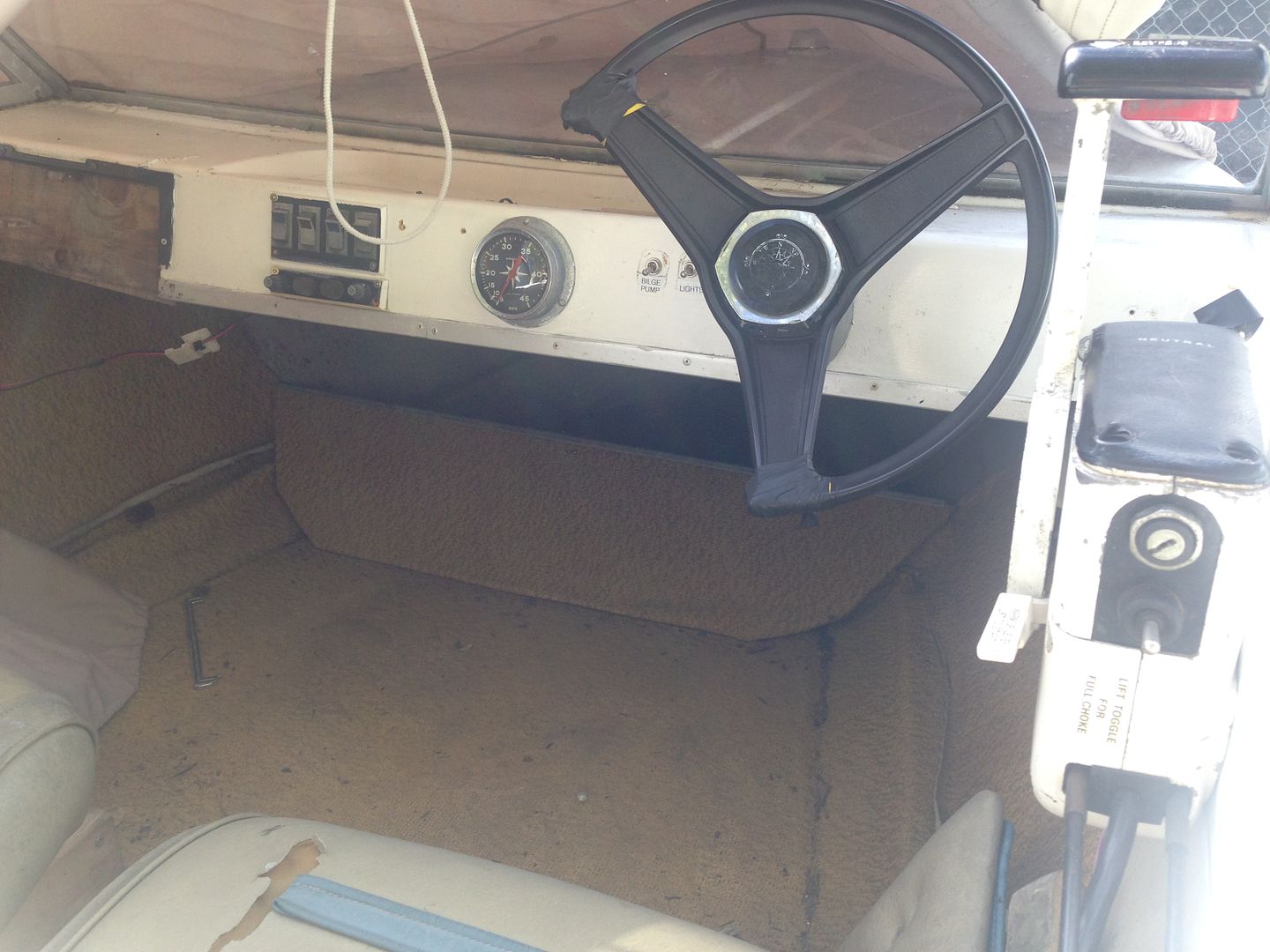

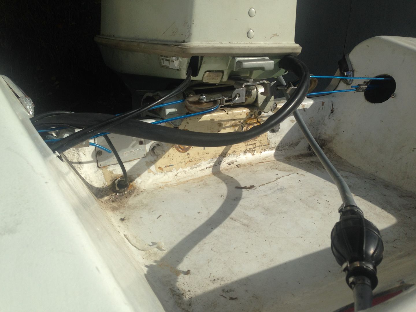

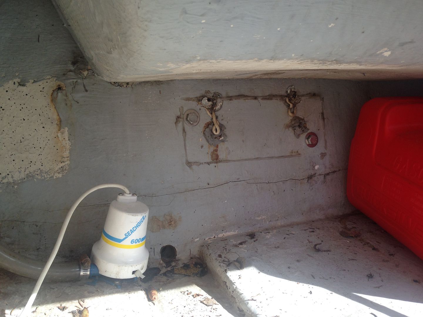

Here are some pics, I checked the transom by banging around for soft spots and noise changes, I didn't feel or hear anything, but I'm sure that probably means nothing
