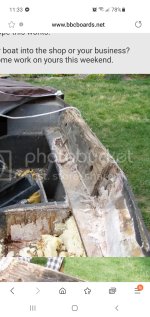

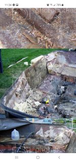

Thanks for the reply. I am in the process of replacing the two shorter stingers around the storage compartment in the floor now and I'm going to remove the wet wood in the bilge area and replace the wet foam back there. The stingers in the back seem pretty solid. I am really just interested in replacing the transom wood after that and then after our trip I'm going to really tear into this thing. I have done quiet a bit of fiberglass/body repair when we all use to run around in tuners and air bagged s-10's lol. So I have some experience with mixing product properly and whatnot. Though I realize that what I'm doing here is for structural purposes as opposed to cosmetic. I attached some pics I found on the web of another javelin that someone redid. It appears to me that the transom wood doesn't/cant go all the way accross the back.

if you have wet foam, you have wet stringers and transom. you do not have solid stringers
from the look at the pictures, I would recommend a full gut-n-rebuild.
