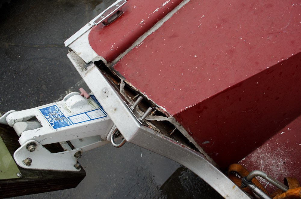

I am looking for sugestions on best way to repair transom support bracket on 1977 18' Starcraft. i am not exactly sure how this happened but am hoping i can get suggestions on best way to fix/repair.
i have attached a picture of the brace and it is tore on both sides at about the same distance. just so you know i do not have any visialbe outside damage to the transom.
Open to suggestions.........

The 'tears' are where it attaches to the transom, correct?
attachment.php
Typically it's from transom flex when the plywood transom core begins to go soft from water intrusion
Excessive pounding running too fast in rough conditions
Wake jumping
Transporting the boat on the trailer w/out a transom saver brace between the OB & the transom/trailer
Shallow water launch w/ the motor down & the OB lower unit striking something submerged
Any of those are possible.
Rule out transom flex 1st, if the transom is soft, it needs to be addressed, before repair of the knee brace. Check the bottom of the hull at the keel where this knee brace attaches to it. It may also be deflected. But I doubt it.
Since the transom is no longer in direct contact w/ the back of the knee brace, I suspect it is softer then you'd expect.
The transom should run straight & flat across the stern of the boat, does it bow slightly astern where the OB bolts to it?

Post up some pix, unfortunately it isn't an uncommon problem. Most often the result of a soft transom, so lots of investigation to confirm it's sound is 1st.
Using a small bladed screwdriver or an awl, you'll want to probe the transom plywood everywhere you can reach above & below the splashwell.
This is a possibility if there's a soft transom hidden beneath all that aluminum sheet metal:
From here:
Tore the transom ...how to repair? (pics)
Until just now, I'd never noticed that the tow eye was poorly located, but the transom was soft....
Someone recently had a welder repair a knee brace w/ similar damage to yours. Most use an aluminum angle laid in beside the knee brace, thru bolted thru the transom & riveted or thru bolted to the angled piece of the knee brace.

I can see by your photos that the lower motor bolts are pulled into the plywood. That break could be welded and strengthened by a good welder (someone who is good with aluminum). The ONLY proper way to repair that is to remove (and might as well replace) the transom wood so the brace can be repaired and placed back in the right spot.
It is a common failure on aluminum boat braces.
