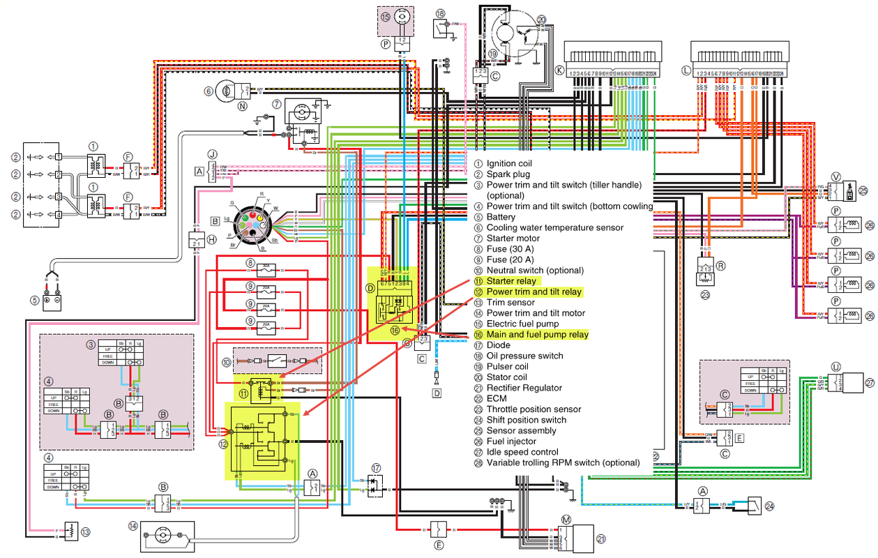

The tilt and trim relays are CLEARLY highlighted in post #35. They are INSIDE the box. Hint they are the 2 curly cues in the yellow highlighted section. 1 is up and one is down. Clearly you are not the guy who gets handed the Fluke at work.

The only reason you two are so hostile about this is because you did not know that was a 2 relay system. I called them curly cues to dumb them down for the uninformed. The funniest part which I am still laughing about is, you put the wiring diagram up that proved me right! TWICE LOL

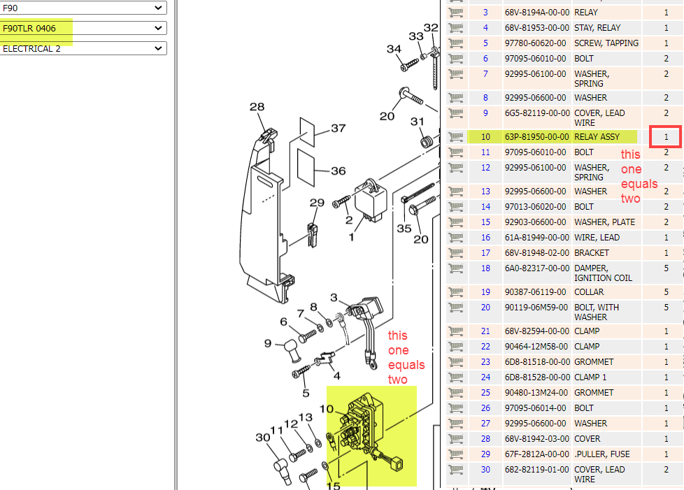

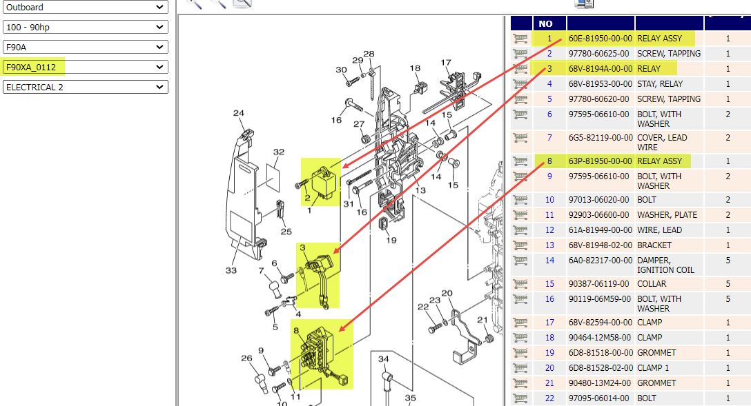

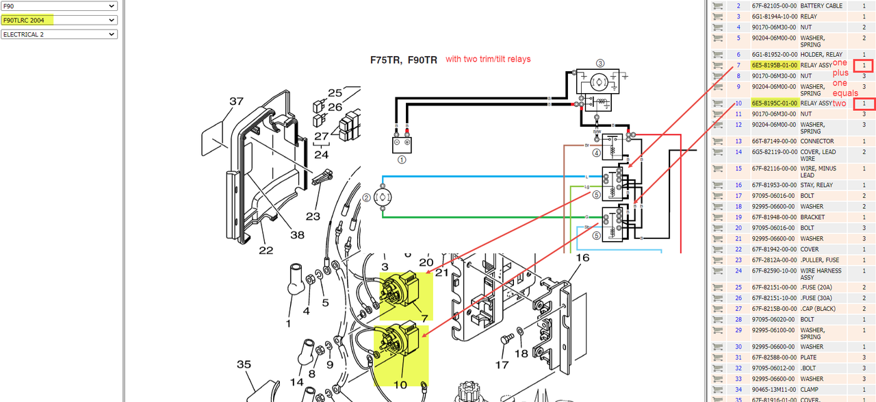

You know what's funny is you clearly put up a diagram of the box showing the 2 relays it contains about 3 times. Now you just put up a pic of the box which clearly states assembly meaning more than 1 part. I am saying there are 2 relays in that box. I don't know why it is so hard for you to wrap your head around that. Especially when YOU have put up the wiring diagrams proving it. My god you are like a politician. I know what the facts are but they are not true. I love you guys nowhere is it more true that people do not let the facts get in their way. LOL

Got it. One semi-sealed relay assembly with one part number containing two relays equals two relays.
Similar, but different, to two separate relays having different part numbers equaling two relays.
Try call Yam and ordering up the one of the two relays in the relay assembly that has failed. Never mind. It should be repaired and not replaced.
