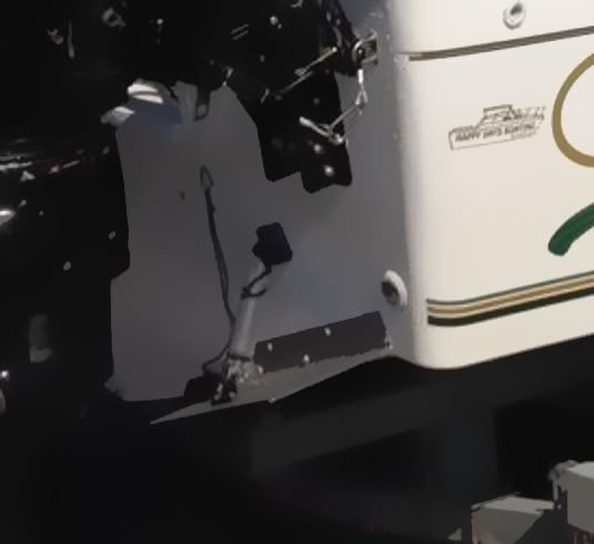

Ok, there could be an issue is the Trim Tabs were mounted incorrectly on the transom. To be sure is there any way you could post photos of them up and down? That way we can rule that possibility out.

Thanks Tom. I have included a picture that happens to show the starboard trim tab. From everything I can gather it seems to start level or higher and then achieve a 2-3 inch drop when fully engaged. I will try to get some more detailed pics when I get out to my boat in a few days. I will be back on the water with it then as well...hopefully I can play around with your suggestions.

Tom would have a better perspective, but if that tab is supposed to be 'fully retracted', you may have a mounting problem. Extend a straight edge along the hull and out past the trailing edge of the tab, if the tab touches it anywhere ... :facepalm:

Good eye Outsider!
It certainly looks to me that that Trim Tab is in the fully retracted position and is angled down from the plane of the hull bottom.
This means that it always going to be generating lift, even when retracted. And when you go to apply some Tab it will make lots of lift right away. The Tabs mounted this way will make the boat run bow down at higher speeds even when retracted.
As Outsider mentioned, place a straight edge under the hull, when fully retracted your Trim Tabs should be 5/8" above it at the trailing edge.
This allows the Trim Tabs to ride clear of the waterflow when retracted and will let the boat assume a bow up attitude when you want it to, such as at high speeds and in a following sea.
Maybe it's the camera angle, or the Tab is not fully retracted, but I would make sure they are fully up and double check to see if they angle up a bit in the full up position

One thing I've noticed on the trim masters is that they do not return to the fully retracted position on their own (bad design or flawed operation?). In the picture shown they were still in the position I left them in while last on the water. When full retracted it does indeed come above level in relation to the bottom plane (sharp eye nonetheless).
