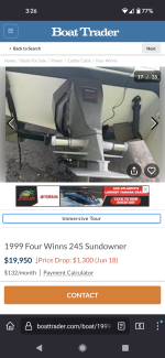

And to people responding the reason I'm asking is because on this model the outdeive is recessed into the hull , not directly into swin platformimg_xspqEubGjwIStTj_r.jpg
Tabs get mounted on the far outside of the hull as shown belowtabs.jpg.

I'm not sure if back there is reinforced like a transom is? Does it have to be ? Because I've seen people mount them like it
