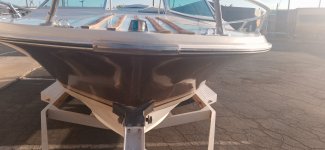

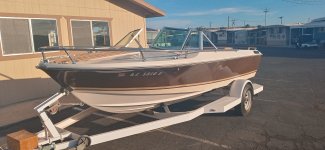

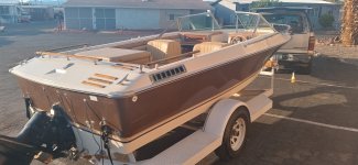

Thanks, I'll try it...

Post what kind of switch is at the helm/dash, alot of the older boats had a 3 button trim control there. Also how many solenoid valves are there near the trim pump, will be either one or two controlling the trim motor. Post some pictures.. we probably have the schematics and and help guide troubleshooting before changing anything.
