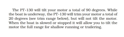

One more question:
I read where the typical hyd TT units have a relief valve built in to allow somewhat of a tilt UP in the event of a UWO collision.
Looking at the CMC manual, I see this (pic) but no mention of how it is regulated or accomplished. I can imagine an internal pressure sensitive shuttle, or priority type valve to isolate the tilting until the fwd pressure drops to a level that would indicate a slowed, or stopped condition. (wondering)
Anyone familiar with this ? I'm just guessing. And, there is no mention of the ability for the unit to tip up if hit at speed. Any ideas on that ?
Thanks again,
W

On the Johnson I had trim was accomplished through two very small cylinders that extend or retract under any condition. When those small cylinders were maxed, the pump had enough pressure to fill the larger tilt cylinder. The pressure was not enough to push up the piston in the tilt cylinder when under way. It’s a pretty simple setup.
That is exactly the way the stock tt is on my J60. But the CMC has only 1 cylinder with 1 ram. Something has to sense when it is slow or stopped and when under way.
Could be a small internal bleed port at the 20 degree mark ? dunno ?
Thanks again.
