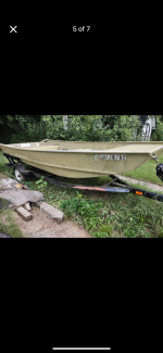

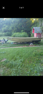

Just adding longer bunks or rollers isn’t going to do much. They need structure to hold them and there simply is not any under the heaviest, most critical part of the boat.
The best solution is a trailer that fits the boat. The proper trailer would also correct the balance problem and get the tongue weight where it should be. To me, that trailer looks like it belongs under a small jon boat or a PWC.

ageeed! I think it’s a modified Jon boat trailer. I’m going to look at this boat and trailer tomorrow. Trailer is 18 feet long and a 2019. I think it will provide much more suitable trailer for this boat. This little trailer I’ve got here will also work well for the job boat. Win win.

I just realized you have a CRVS. Hopeless for a flat ramp. You MUST NEVER allow that trailer to drop off the ramp. Why the trailer neck is so low.
Yes I’ve got a Honda crv. . I think the low neck looks worse than it actually is in the picture because I’m backed into my inclined drive way.
