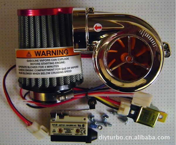

Yeah the parasitic effect of running belt driven boost is not the way to go... RMP lag for turbo boost, not a problem any longer with the new electric turbos and you don;t need to worry about the exhaust plumbing.
That looks like something the Honda boys would put on along with their fart cannon. If superchargers are so parasitic why do the big boats run them?
LOL, yeah it does but the warning sticker looks marine. My guess would be big boats don't have 4 bangers... every single HP means something to small motors.
