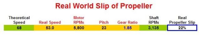

Ok here we go: I had the boat weighed and it was 7080lbs with the trailer, now it is a steel tri-axial trailer so I estimate it weighs 1200 lbs: which in return I just replaced with the weight of fuel : about 1000 lbs, we had 3 guys and one lady totaling 700 lbs, so if you all this all together you get a total weight of 8000LBS fully loaded when I ran her for the first time. Now we reached a top speed of 46 knots= 53MPH. The boat handled well, however the starboard motor wanted to jump up wayyyy high in RPM as we got on plane and im not sure why. The motors were in unison while at idle, and then at 2000 RPM and at 3000 just as we were getting on plane its like the port motor got a bunch of gas and wanted to take off, once on plane I had to back that motor down a bit and raise the starb motor. I THINK it?s a linkage issue, however I did find it wired that when they were below 2500 RPMs they were in unisen, then after getting out of the hole they separated. I am spinning 23 P props and the boat really seemed to get up and go when I trimmed up pretty well. So I guess the bracket is ok? I know when I turn I can see the opposite motor comes out of the water a bit and gains a small amount of RPM?s but nothing to drastic. I would like to get your opinions on how fast im going compared to weight and props and if you would suggest trying a smaller prop? They topped out are 5800 RPM, but I could have gotten them to 6000RMPS no problem if I trimmed out more, does this mean I need large pitch props? It almost seemed as if when I went in and out of gear that those props were so big that they stalled the motors a few times when they were in idle. Anyway that?s the shake down 53mph, 8000LBS, 5800 RPM, = I thought id at least hit 58MPH????? Do you work boyssss

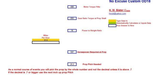

Jserb, I ran your new numbers with the new weights you gave and here are the statistics. You have a Prop SLIP of 22% right now and that is NOT good, but if your motors will turn up a litlle more RPM like you said then I don't see a problem. You should be able to turn the right Diameter and Geometry of props at a very respectable RPM. I would like to know exactly what manufacturer and model as well as Diameter and Pitch of the props you are running now, and I am sure Dhadley will too. Dhadley is the expert on the high speed props as far as I am concerned, on manufacturer and models to use.
My opinion is that you either don't have enough Diameter or blade surface area or both. But the correct geometry would take care of this problem as well. With a Slip that high, I think if you increased the Diameter by 1" in the exact prop model you have now, you would lose some real RPM but you would still have a 23" prop turning very respectable RPM, but you would lose a lot of that 22% Slip and I believe possibly get down to around 10% or better and have more speed than you do now. But that is just my thoughts on the matter, listen to what Dhadley recommends.
My numbers show you should be turning a 21" prop with a top speed of between 57 and 60 MPH depending on SLIP.
Prop Slip
For some reason I cannot get the picture function to work, I will try again shortly.
