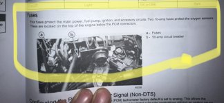

Well it’s good news so far. I really just needed to really understand how the Rinda works to clear faults (needed to clear the history) sensors are all reading now and no heater fault. No promises yet on the fuel fault but it’s clear and didn’t return upon startup
