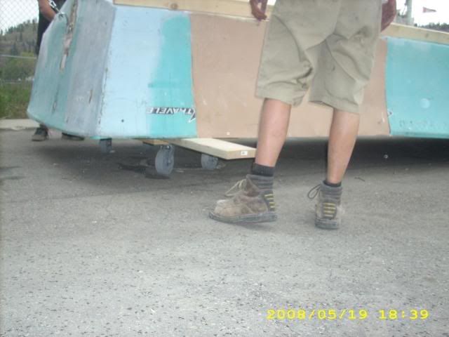

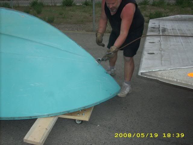

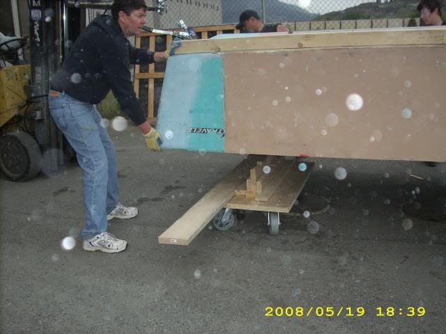

tri hulls are a bit different.....this is due to the amount of curves in the hull and the 3 rigid keels.....
however...the premise is the same.....if the hull sits on the cap edge....like this
you have to level the keel and the chines....you can shim it....do what you have to to get it straight on the planning surface.
if you glass it with out making it straight......you will have handling problems on the water.....some of these might be quite severe
