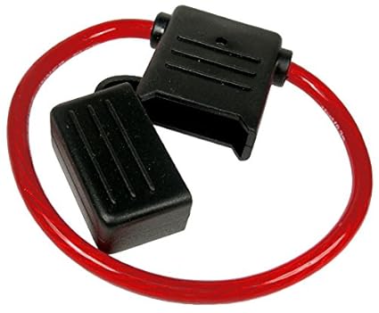

Have found a few with that condition. the connection loosens up a bit .Get rid of that plastic piece of junk and install a "Maxi-Fuse" holder
50A 60A 80A fuse is available
