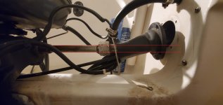

So I started taking the steering rod out, but I'm not sure how it would come all the way out. I have the rod half way out (I think), but it won't come out any more, because the hole is higher than the rod, and the cable is already at an angle, that I don't think it can be pulled out further.

The motor must be moved to port in order to remove and reinstall the cable. A common problem on small boats or boats with narrow splashwells.
