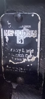

Fisherprice
Jul 11, 2022
15
Hi Chris
Engine number is
M600033 I’m thinking that the extra switch can be added to the new shift interrupt switch.
Best regards Dave

Are you sure that's a Gen I? The engine serial number is for Gen II... And yes, the in gear switch should just transfer across.
Fisherprice
Jul 11, 2022
15
Morning Chris
Thanks again for putting me right I have been thinking it was a Gen 1 but as you say it must be a Gen 2.
