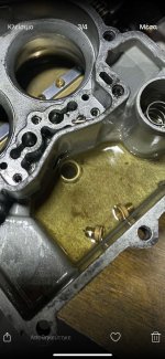

We have an outcome.
Jelly in the fuel and one bad spark plug.
greek engineer found these issues
I always like to end the thread with an outcome in case it helps others
52,783
check your fuel tank contents for the same goo.
