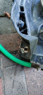

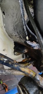

Hey folks i have a question regarding a used gimbal housing that i bought to replace my broken one. Both are Bravo gimbals. The new (used) unit has 2 square holes on the bottom where the one on the boat does not have that option. The question being, are both the same gimbals

Just the gimbal housing not the bearing or bell housing. The gimbal is cracked where it meets the transom. So i had to go out and get a used one.

Ayuh,..... Have ya got a picture of the square holes,..??

Here are the pics of the broken one on the boat vs the new on with the square opening

Ayuh,...... That's where the aluminum anode blots go through the transom,.....
No difference,......
