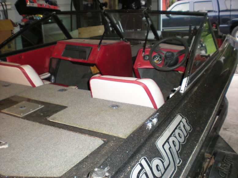

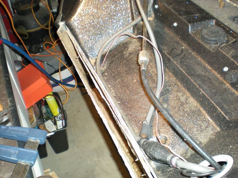

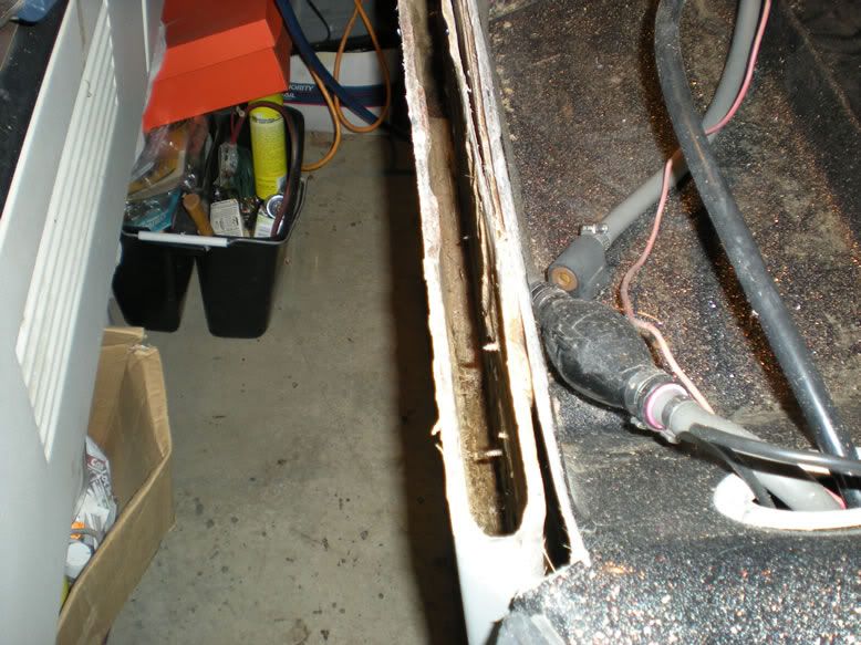

Hi, I have been lurking around for awhile reading posts and looking at options to replacing my transom on my 1994 Glassport 165 Sport Bass boat. My transom in this boat did not require me to separate the hull to replace it. All I had to do was cut the cap off the transom and dig out the mush. I decided after reading testimonials and other posts on the use of the Seacast method, that this was the best way for me to go.--I will let you know how it works out!
I will try to post some pics as to what the transom area looks like now that I have it cleaned of the old wood. I will post More pics of the pour when I get ready to do it soon.---Dave

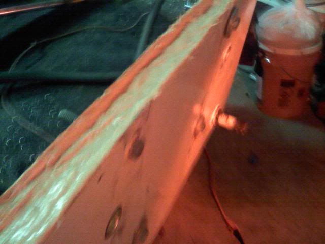

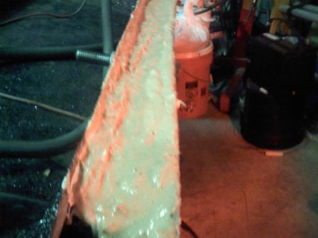

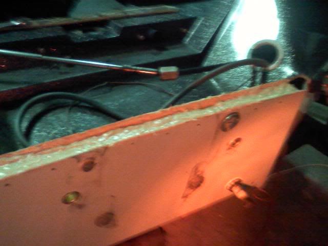

Here are some pictures of Dave Shipos's boat he sent to post for him with the seacast work being done.
Thanks for the Pictures Dave!
Dave Shipos
May 23, 2005
45
Re: Using Seacast for the first time!
These pictures are showing how my Glassport transom looked like at the time of the pour.The first thing that I did was determine how much wood was really in the transom. next after figuring out where I should make my cuts,I used my air cutting tool and carefully sectioned out the top portion of the transom and carefully lifted off the lid.
Then the fun part began!
I spent the next 7-8 hrs digging the old mush out. That proved to be a difficult job as there is only about 1 1/2 inches to work around inside there with your tools.--I had to use several different long drill bits and drill spades to pulverize the wood enough that it will come out!--Then I used a shop vac and my air compressor to blow out the rest of the wood pieces.

Grind and sand the Seacast flat,remount the lid, fill, prep, repaint, remount trim---then you are finished!
My boat came out very nice,I was impressed how easy it was in this case, and how strong it is now!--I think that it is stronger now than when it was built new!
