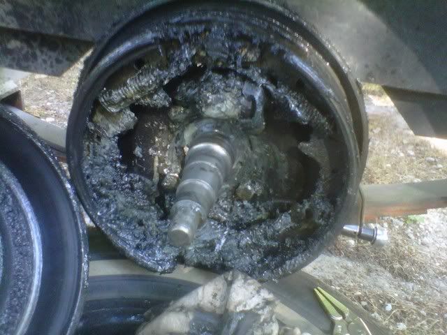

On the trip up, Saturday, there was a wobble or shimmy that occurred at about 63mph and above, also noticed a wobble at slow speed in a construction zone. Kept stopping to check hub temps and everything felt normal. We made the 200 mile trek with no issues by keeping the speed down to about 60mph.
After launching the boat the right side of the trailer was jacked up and the wheel was a little loose. The next morning the tire and drum were popped off and this is what I discovered.
Looks a few years worth of grease packed in there ya think.
Here you can see what was left of the seal. The metal part of the seal was warped and bent.

First thing Monday morning a trip was made to the local auto parts store, picked up 2 sets of bearings and seals, 2 rolls of towels and 3 cans of break cleaner. I also picked up a bottle of dawn dishwashing soap and a dishwashing pan.
Proceeded to scrape off as much grease as possible and wiped off a bunch more. All the parts were then dropped in the dishpan with about a half bottle of Dawn and they soaked overnight. We had another great day on the water.
Tuesday morning the reassembly work started. Cleaned up all the parts in the tub and then sprayed them with break cleaner. The break plate and the spindle were then cleaned up.
It was here that I discovered the seal rest of the spindle had weld spatter on it. I don't know if the spindle had been replaced or if this was a factory original issue, who ever did it did **** pour work. The spatter was knocked off, the spindle was gently filed, then wire wheeled, and then steel wool was used to make it smooth. We spent yet another wonderful day on the lake.
That night everything went back together and the spindle and bearings were packed with Marine grease. The rim was scraped and wire wheeled until all the old hard grease was removed. The surge breaks have never functioned on this trailer, imagine that:facepalm:, so my only concern at this time was getting the bearings sealed and together properly. The breaks will be a fall or spring project maybe.
