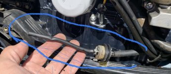

Just bought this pontoon boat this summer it has a 2000 50hp evinrude fuel injection motor. I found a line running under oil filter that goes to nothing on one end, on the other end it goes through a filter then splits with one split laying on top the thermostat open and the other split goes into top of engine see pics, just wondering what it is maybe a vacuum line?

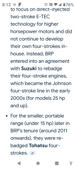

It’s a E50PL4SS but I have been told that before did evinrude have Suzuki build this motor?
Evinrude just rebranded it I believe. As far as I know, Evinrude/johnson never made a fourstroke but sold other brands as its own.
39,901
This motor is SUZUKI built !!----And not all of their 4 strokes were rebranded.----The early 9.9 / 15 HP 4 strokes were their own with same lower units as their wonderful 2 strokes.

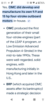

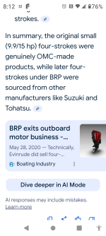

Here is a more detailed explanation.

Ok so I found a nipple on bottom of crank case beside oil filter right above dip stick you can see it in pic I believe that bottom hose goes to, and I believe the hose on top of motor goes into the fly wheel cover in that open port in pic.
