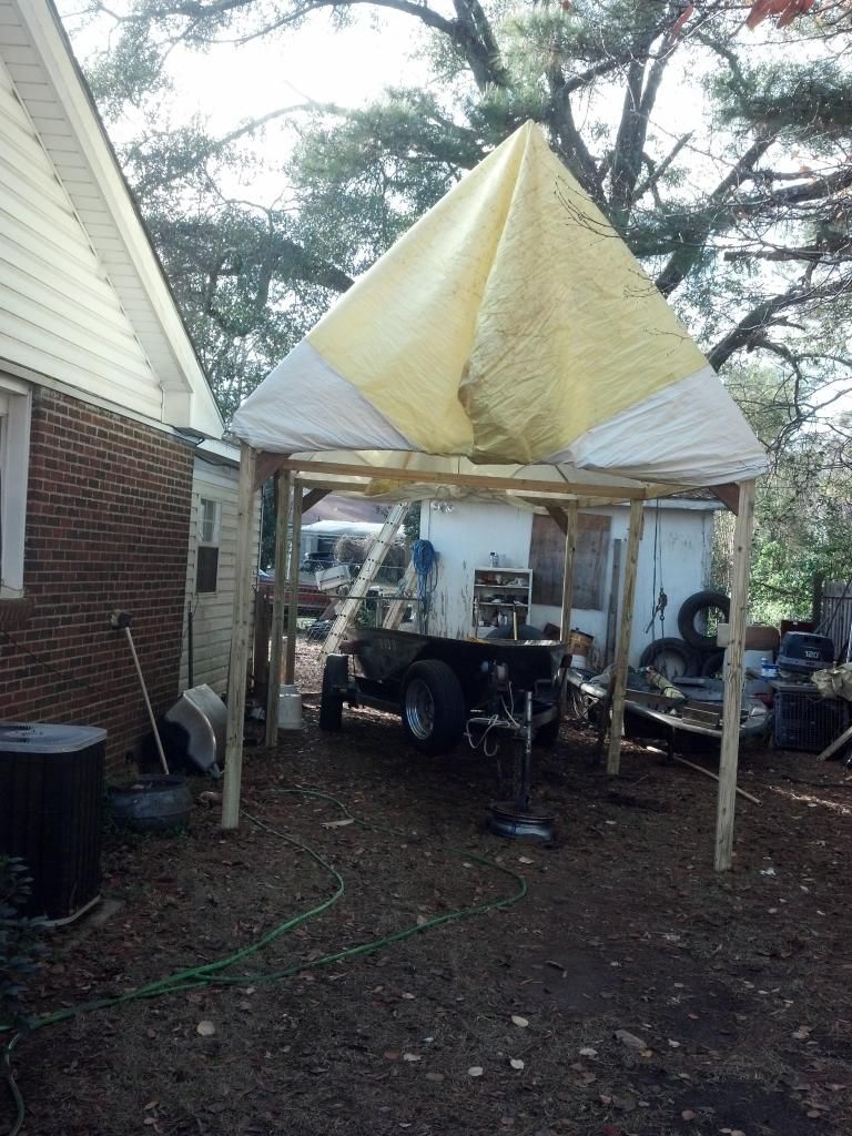

built a temporary shelter today. took all day and im only out $80 so far. going to harbor freight to get a couple cheap blue tarps for the sides. those of you from the south will prolly know what the top is made from....

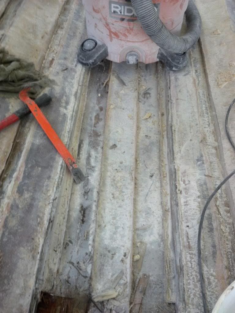

I worked on getting a complete stringer out today. Man that thing is really in there. I ended up quitting until I went to Harborfreight and got one of the Chinese wonder vibrator tools to be able to gring down near the bottom of the things. Is there some secret way other than grind away until it comes loose?
wolfsmurf
May 6, 2010
131
Re: Vendetta restore

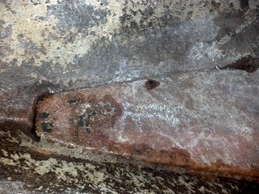

Patrick ITCHY! Anyone else have all the spongebob episodes memorized? Got the stringers out today. I also found more wood!? There's this ironing board looking thing in the middle under the stringers that has to come out since I did some test drilling and found wet wood. I'm betting the ironing board is 1x12 since the little strakes had ripped 1x4s in there. This is my first restore but don't seems right finding regular lumber in there .lol
I'll get some pics loaded in a bit to show the ironing board.

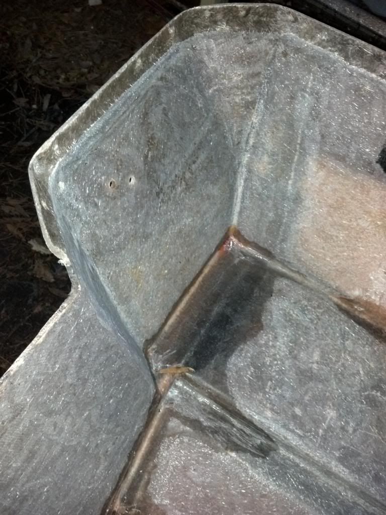

ironing board in ma boat!

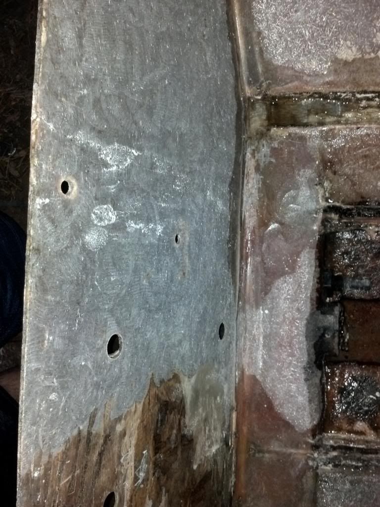

got started on sanding the transom area
got the back corners done. mostly
another shot of the area where the ironing is done I guess.

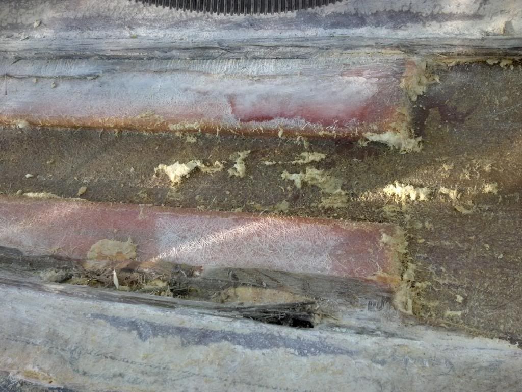

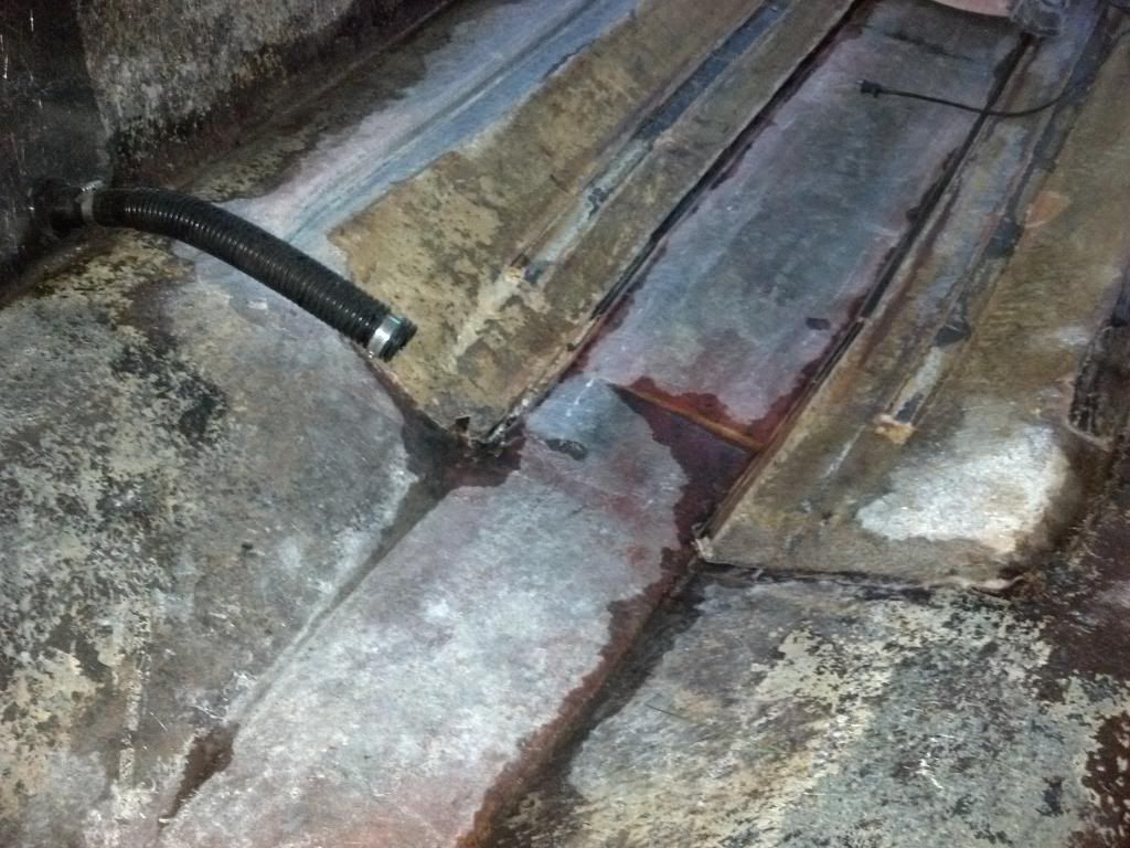

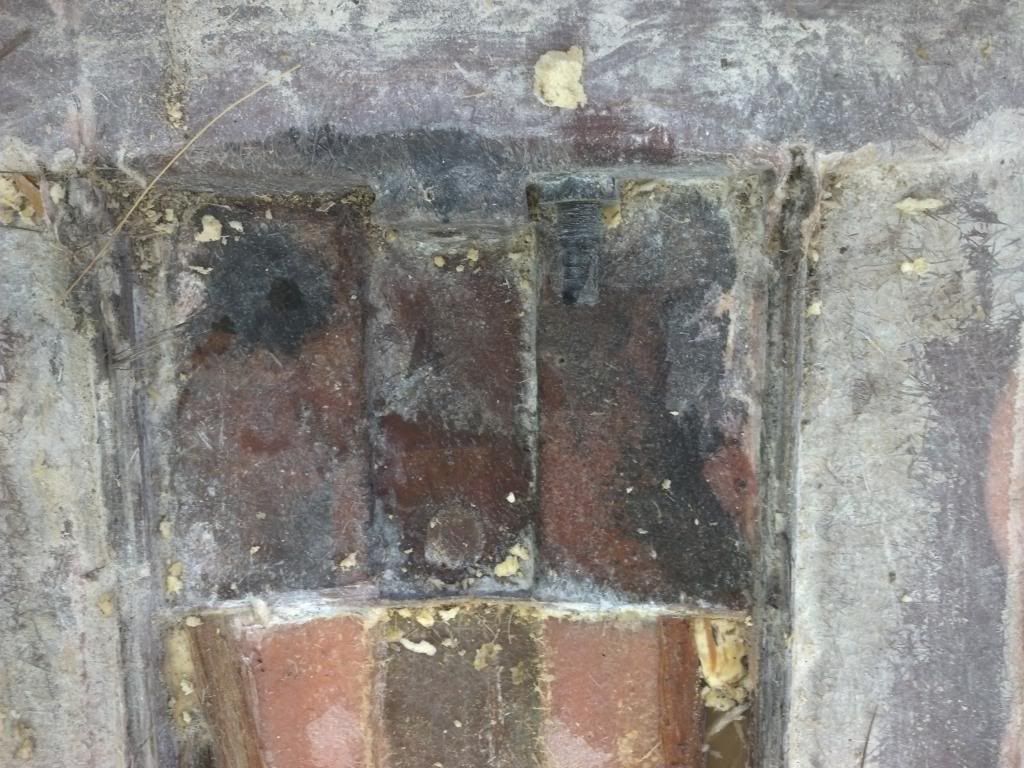

got the ironing board up today....found a surprise...MORE WOOD! and yes it was waterlogged as well so it has to go as well. there was also foam under that board?
got the glass off the top of that wood and its like the other 2 places,strakes?, where they just put in 1inch lumber 2inches wide and a foot long only this set they placed 2 side by side. very strange to me. got all that out.
got 2 more pieces of plywood in the bilge area to get up now and then its sanding time...anyone say fun fun?
so im wondering if anyone hear mite give me a suggestion on what to put back down because I am NOT using 1x lumber in this boat when I start putting it back together. I was thinking I would use 3/4 plywood for those boards in the very bottom of the hull and glass it in really good but do I need to put the board cover over them and foam it all in like it was? I was going to enlarge the floatation boxes in the back a little, theres lots of room under the topcap back there and I figure since weight wont be a big thing with foam and more foam is better right? I could just cover the 2 pieces of 3/4 with a piece of 1/2 ply and PB the crap outa the whole thing it would have as much strength. any suggestions in this would be great.
a1964rn
Oct 18, 2012
287
Mine had 4 short pieces of 3/8" plywood about 2" wide glassed into the area just in front of the bilge. From the shape, I suspect it was put together that way to form a channel to divert any water back to the bilge?
Nice progress on the boat.
