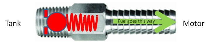

Might want to take a look at the anti-siphon valve on the gas tank. On older boats they can get corrded internally and then the ball sticks and restricts fuel flow.

What was the vacuum at full throttle? Did you see any air bubbles in the clear line when preforming the test.
It's not bad luck or bad fuel pumps --- you have something wrong.
