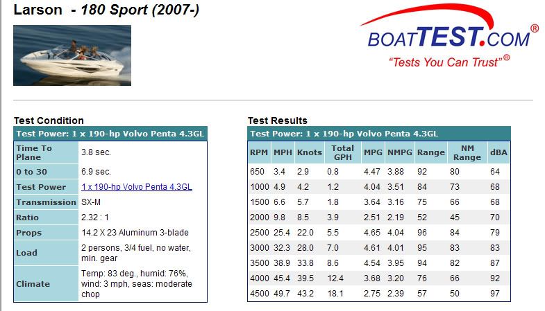

Performance chart for an 18' Larson with a Volvo V6:
Then troll for hours...
When I get back to my dock, I pump out 5 gal.s a trip
As everyone can see, there's a big difference between trolling for hours at 1 GPH and cruising for hours while burning at least 4 GPH .....

Sorry, I never have understood the boater mentality that doesn't like to admit how much fuel you're using. Whether you like it or not, if you're cruising at 3100 RPM (about 33 MPH) in a typically loaded, V6 powered 18'-19' boat, you are burning about 8 GPH. I'll let you do the math to figure out how long your 32 gallon tank will last and whether you want to sell the boat or not ........
