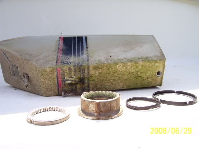

Boy does this bring back memories of my own problems only a month ago. Hard shifting, clunking, high rpm's ...it all boiled down to a reservoir full of water instead of 90w oil caused by the following ruined parts:
Bearing Housing 3857097, Cone 184683, Sealant,oil pan 851407: this chunk of assorted metal cost $450. Total bill was $700.
You may just need the oil. It made all the difference in the world getting it fixed.
