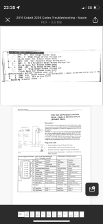

Our local boat dealer pulled the codes, not sure with which tool. I attached the details.

They’re low voltage to gauge codes- oil pressure gauge, temperature gauge, trim gauge. I failed to attach the image. Again, our boat is all analog gauges, not digital.

Correction. We have CAN bus gauges. The speedometer has a small LCD screen where you can toggle through the different readings.
The description we get for SPN 924 is “check engine lamp driver fault” / water in bellows. (Bellows are dry)
There was also a SPN 1213 MIL driver fault.
There was also a knock sensor code stored but I don’t know what SPN that was

Thanks for the S/N.
You have a V8-270-C-B it was built in 2012 or 2013 but was put into service in 2015.
The page you posted in the screen shot isn't for your engine. STOP using this diagnostic manual and get a copy of EGC diagnostics part number 7749393. This is why a serial number can be soo important.
Yes, on this engine with can bus (digital) gauges you can disregard SPN 697-698-699 FMI-5 faults.
But remember that a SPN without the FMI can lead you in the wrong direction. Partial information can be faulty information.
Your engine/drive doesn't have a water in bellows sensor so when interpreting that code, make sure you take that into account.
I gave a quick read of the hull truth post you linked. I wonder if it's the poster or the dealer that's wrong. Filling the tank with premium fuel with a no activity KS code is wrong. But, it is a poor way to troubleshoot a excessive activity code. So someone is very confused. Another person talks about using loc-tite when replacing a KS. No. The sealant used can be very important as can the torque used to screw it in. Almost always best to follow the service manual. In this case the new Volvo KS will come with the correct sealant already applied and it gets torqued to 15 ft. lb.
You talk about replacing the KS's. Have they been tested? The test is very easy and fast. Only requires a scan tool and small hammer. If they fail that test there are other tests to do before installing new ones. If your mechanic doesn't know this ---- it might be time to try another mechanic.
But a no activity KS fault is one of the faults that will only set once the engine is over 3000 rpm and certain other parameters are met. But there are others, so we try to never replace parts based on symptoms. Just codes and troubleshooting.
This is why the diagnostic manual will have charts in it that start with this:
The following charts are the limit criteria used by the ECM to set Diagnostic Trouble Codes. The table is formatted to allow you to determine if the code is valid based on the limit criteria set in the programming used by the ECM.
You talked about misfires. This is something that a lot of people don't understand. ALL these engines will have misfires if the system is working correctly. They just shouldn't have too many. The ECM will throw a code once the limit criteria is reached. You can use a scan tool to check the misfire counter and see what's going on.

Thank you for all the additional information.
The knock sensors were tested, and reported no voltage. They were doing the hammer test as well.
The page I attached in one of my earlier posts is the code report from the original mechanic’s computer, but they added the troubleshooting step pages to it.
When they connected the computer to our engine, we were standing there and saw those exact codes, it was just a screenshot they took to include with it.
What is most troubling is the original mechanic and boat dealer chased the 697/698/699 codes to conclude it needed a new ECM, when in reality those codes don’t even apply to our engine.
The new knock sensors were ordered and should be being installed as we speak. I don’t believe the new mechanic is going the loctite route for those.
