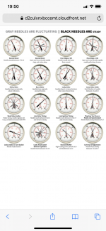

I can’t find the documented vacuum readings on VP 5.0gl. Some articles say SBC should be 18-22 others say some engines are 17-21. One article said some engines like 15 to 17. It’s right at 17 and steady which is right on the border of late ignition timing. So that’s why I thought timing might be retarded but it’s actually advanced more then spec. Initial base timing is currently at 12 btdc, spec says 10 btdc for 89 AKI fuel. Yes, I am using the timing shunt correctly. Also should be 28 for total advance at 2400, mine is currently at 30 so it’s not retarded.
