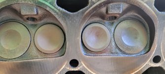

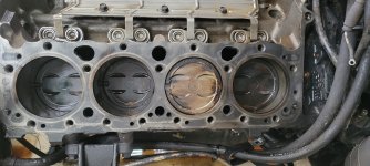

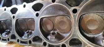

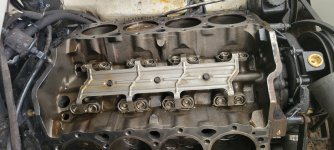

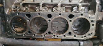

I did find one crack in a bolt hole - see red circle in image "head 2". Thoughts on that?
Also, the surface on both the block and heads between both center cylinders is more worn than other areas, so much that you can't make out the outline of what looks like a cylinder sleeve?

Goose,
Once you decide on the level of cash you are willing to spend it will dictate what you do. Back in post #14 your concern was not dumping lots of $ into this boat. No issue with that whatsoever. This is why I was suggesting look for any obvious issues (like that crack) and if none go for it.
The more you inspect the more opportunity for spending $$. Assume you do the magnaflux and find cracks and the shop recommends not using that head. Are you going to get another head or does that bust the bank you are willing to spend? I’ll say it differently: if you do not know about the crack (that the shop would say is a no go) and you put it back together and get two more years out of it, good for you. Of course, the alternative is that it does become a problem.
So, the other side of the coin so to speak is this: are you willing to put your labor into it with minimum cash and if it does not work you are only out your labor so it’s OK. And heck you could still rebuild it properly from there. If go for it you are looking at only the cost of a set of gaskets and whatever was needed to be replaced due to the overheat. Note: use marine gaskets.
To be clear I am not advocating the short cut. I am just asking you to think thru this.
As an alternative to magnaflux that you can do yourself > dye penetrant. Here is the product (link) and a how-to video (link). Its nasty stuff so wear gloves.
For that crack. It is in the best spot possible > it does not intersect the combustion chamber, and it goes into the bolt hole. Note: when repairing cracks, the first step is to drill a hole at the end of it > this will help it from growing as the stress ‘warp arounds’ the hole and become less.
