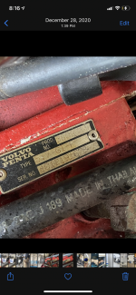

Thank you all. The boat is a 1997 with a 5.7Gi-f. The risers are cooled with sea water. The boat has been run its whole life in salt water. I did see a tiny bit of water leaking in the area you described. I tightened down the four bolts on the riser and it stoped the leak. I just been a little bit timid about cracking open the riser to check the condition but it’s on my list of things to do. I think in terms of just trying to figure out the temperature, I first was trying to understand what normal is and if the gauge or sending unit could be giving a false reading. I completely understand the process for replacing the exhaust manifolds and risers, Ive just been a little bit worried about breaking a bolt. I recently had the boat serviced getting all the outdrive maintenance taken care of, and the mechanic did mentioned that the exhaust risers gaskets needed to be replaced. The good news is that the previous owner provided a bunch of parts that were all very nicely labeled and in a box was a brand new Volvo Penta exhaust riser.
If the risers are showing restrictions, does that always mean that the manifolds get replaced along with them?

You can wind up ruining the engine if you let this go too long. Take a look at the spark plugs and see if the electrodes are getting a bit of rust on them. Salt water will trash the engine and then you'll be in for a long block replacement. After running on plane the Volvo style exhaust on my engine tops out at about 135*. Now a closed system might run a bit hotter since the water feeding the manifolds and elbows has to cool the heat exchanger first. See how hot they get after coming off plane. I would still check them on a new to me saltwater boat. Neglected raw water cooled exhaust is the #1 cause of inboard engine failure.
My boat being in salt water approx 20 years, has had the exhaust changed 3 times since I've owned it. That's a nice boat, it's worth the investment. Don't put it off .
