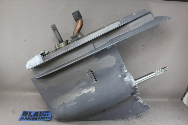

That irregular o ring should be replaced each time you pull the drive; I coat it with marine grease to hold it in place while reinstalling the drive. While you’re at it check the driveshaft bellows carefully. If you need to split the drive I have a trick for that job! I'm still thinking your problem could be marine growth inside the drive water intake area or the water tube grommets or the tube itself. There was a member on here that had the same style drive and his water tube had a hole rotted in it. Always start at the beginning of the system, that's the water intake system. And for a boat slipped or moored in salt water it WILL need to be cleaned, that's why I tossed the plastic water screen on mine.
This my old Cobra but the way to get it apart without breaking stuff, is first make sure to remove all the bolts that hold them together (2 on each side, and one or 2 where the rear of the drive). Next, put a rod through the trim ram holes, then use two 1/2" bolts (IIFC from the last time I did it) through the front mounting holes. Then you get 3 scissor jacks one on each side of the rod, and one under those 2 bolts, and slowly and carefully jack it till it pops free. They can get REALLY stuck on there due to salt water use. On the Cobra you have to remove the water passage cover to clean it out, I've never done a Volvo so I don't know if it's the same or not, if you have the removable screens on the sides of the drive, you might be in luck. Usually the water grommets don't fail unless you had a bad overheat, then they can get melted, due to the loss of cooling water through the drive.

Here's some pix, not sure if this is the same as yours, but it looks like the water passage can be accessed by removing the cover with 4 bolts. I'd be very careful with those bolts, use some penetrating oil, heat & patience. When re-assembling any salt water used drive, make sure to clean out all the threads as best you can, and use OMC gasket sealer on the threads, it helps prevent seizing up in salt water. I use it on EVERY bolt on the drive, and mine sits in the salt for 5-6 months each year.

That’s how I did it. The tricky part is lining up the water tube. See if you can get someone else to help you; I was able to do it myself.
The mechanics I used to use recommended splitting the drive & cleaning that area out every 5 seasons in salt water. So it’s a good thing to learn how to do.

As Lou C mentioned, I had an overheat problem that only occurred at idle speeds, it turned out to be the dogleg tube that is on the water intake but buried between the upper and lower drives, it gets burnt by the exhaust gases. Number 12 in the diagram. The replacement is now stainless steel, I wonder why? Hope it helps. I did it single handed but a second hand would make it easier.
