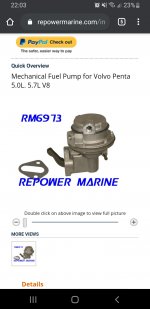

Hi Thanks its small block chevy v8 if ive found the correct carter pump its 1/4 npt
Do you know if this is correct and what the correct carter part no is
Ive attached a picture of the pump I have
Cheers
52,317
1/4" NPT in the body, the addapters are 1/4" NPT to 5/8" inverted flare for the 3/8" tubing
and the adapters are bronze, not brass. re-use your old adapters
