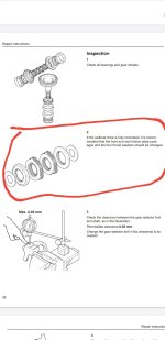

We have disassembled the SDrive module and confirmed that the friction discs and thrust washers have wear. We think that's the problem.
The workshop manual recommends to buy the "front and rear friction plate package and the four thrust washers"
Questions: A) can you confirm that the diagnosis is correct? B) If so, do you know where to buy this kit and approximate FOB Miami price?
We will appreciate any other suggestions to fix this failure.

Wear might just be the problem. But very often this issue is caused by the wrong oil too.
