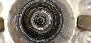

A few weeks ago I purchased a 2002 Chaparral 220 SSI. This boat has been repowered with an Indmar Assault 310 350 / 5.7 liter engine from the original Volvo Penta 5.0 liter engine and equipped with a Volvo Penta SX-M drive. I have been working on the boat taking care of maintenance and other issues. I decided to take her out to check how well she ran.
The good news is the runs great. however we noticed a vibration and noise when steering and trimming. We got the boat back home and pulled the drive and found that the Gimbal Bearing was completely obliterated inside the U Joint Bellows. That will cause a hell of a racket and a lot of vibration as well as potential damage. we also noticed that there was no gasket on the drive.
I noticed that the Gimbal Bearing Housing was damaged as a result.
Obviously I need to replace the Gimbal Bearing. I plan on changing the bellows and perhaps the U joints if it continues to make noise. After cleaning everything up they seem to be pretty good and have no play in them at all.
I can see that the Gimbal bearing housing is listed as a separate part number. The question is can it be replaced. If so how difficult is it to replace.
Here in the photo you can see that the inner race of the gimbal bearing is missing. you can also see one of the bearings left in the U Joint Bellows. It came out attached to the U Joint shaft. I was able to tap it off after using a bit of PB Blaster on it for a few minutes. Resized_20201114_151105.jpeg
Scott06
Apr 20, 2014
7,379
Best bet looked for a used fresh water gimbal housing or complete transom take out. You have to pull the engine to replace this. If there was no gasket in there seller knew this was damaged and in need of a fairly expensive repair, slapped it back together. The rest of the bearing is missing...

That’s a shame because that kind of damage is easily preventable by regular maintenance. That means pulling the drive at the end of each season and checking for water in the D/S bellows and roughness in the gimble bearing and either looseness or stiffness in the u joints. Replacing the gimble housing is a project. Engine pull, etc. You can find those housings used on eBay. If I were checking out an I/O boat for sale and it made any noise or vibs from the transom mount if the owner was unwilling to have the drive pulled and an inspection done I’d walk from the deal because as you’ll find out unless you can do all the labor yourself this job will be well into a couple grand.
BTW the Volvo SX does not use a gasket between the drive and the pivot housing.
