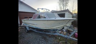

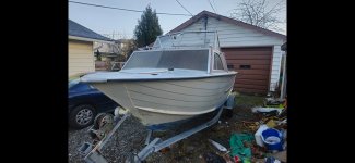

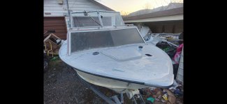

There is also an option to purchase an old boat (boat pictures are my current project, not the salvage motor boat) which I can salvage a Mercruiser 3.7 with Mercruiser Alpha 1 drive. Looks to be in decent condition (see pictures). $370 USD. No rebuild or condition status on the motor.
The boat that I'm restoring is a 1976 Starcraft Chieftain 20ft. So on the one end I could go with a 4 cylinder 2.0L or a 3.7L 6 cylinder. I intend to have a relatively fuel economical boat but also go on trips up the coast and local lakes 90km long. Volvo vs Mercruiser, I'm struggling to figure out what to do

what motor is in the boat now, because one has a little keyhole shaped hole in the transom, one has a hole you can crawl thru.
If it was me, I would find a post 1996 4.3 motor and drive, rebuild the transom and go that route.

The boat came with a Volvo B20. AQ115. I have torn it down, checked it over and cleaned it up. I have a buddy who works in a machine shop who will clean it up and bore/hone cylinders. Easily can rebuild the motor and put it back in the boat. The concept is to have the boat as a cruiser. It will be my first rebuild so playing with ideas. If the keyhole on the transom fits a different motor I'm good to go that route.
Just wondering if the B20 will power the 20ft Starcraft Chieftain nicely or not.
