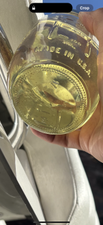

Remove the fuel filter and dump fuel into a clear container to see if there is anything but clean gas

Fuel filter drained. Some sediment in bottom

and gas looks fine
