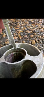

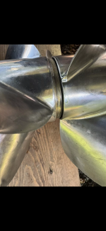

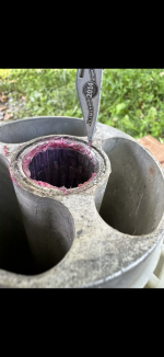

I have a customer who bought a set of props, he sent me these photos of his installation… Props were pulled off one of my boats and did not have these issues that he’s showing me.
I’m trying to help him figure out how the hub has somehow shifted from the point of props being removed to being shipped.
Please let me know what could be the cause of this and solution to it. It does appear the hub shifted. He mentioned he was pressing the hub in himself and messing around with it.
Not many pictures to go off of, however hopefully these give an idea of the issue.

Not an expert on VP but with Bravo 3 props those races are installed on the prop shafts, not the props.
Are there races also on the shafts?
