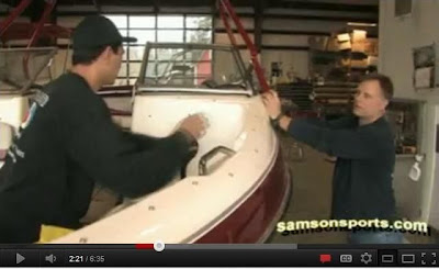

The best youtube video I've seen on the topic is from Samson Sports (hopefully I can muster up the cash to get one of their bad***** towers). Lucky for me, they are working on a GT 210, so it's a very familiar boat. My issue/ question is accessing the inside of the hull. In the pic below, you can see he is reaching through a big hole... that hole isn't stock.
I assume it was drilled for the insallation. If that is the case, 1) is that really ok to do? And 2) would it need to be repaired afterwards? The seat back would cover it, but wouldn't that weaken the structure?:confused:

I would look extensively for ways to access the areas you need without cutting holes and such. But if you must, the hole that is cut in the seat back (in the video) is fine, it will not be detrimental to the structural integrity. I would refrain from drilling near corners and the borders of flat areas, keep holes in the middle of panel areas., generally speaking.
To repair the hole, I would just replace the hole with one of those round access plates that you can buy at marine stores (so you want to make any hole the size of available access plates).
In order to avoid stress cracks you need good sized backing plates. I would use 'Starboard' mounted with epoxy. Others may have their favorites. Through-bolts . . . no screws. Bevel the holes on the gelcoat side of the hull and use a bit of epoxy on the freshly exposed fiberglass. Silicone on the exterior mounting surface that meets the hull so no water and crap can get behind the mounting bases.
